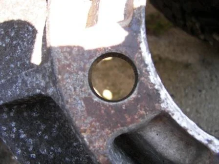

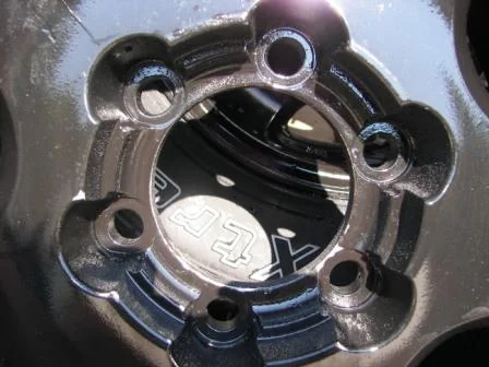

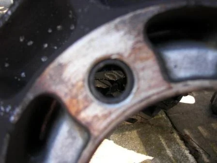

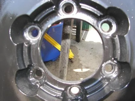

I didn't notice this when I bought these stock alloys(3). My spare, pics attached is like my other 4 rims. Large lug nut with a inset washer that fits flush w/ the wheel. The 3 I picked up have an inset inside the 6 holes that is metal. I have PB blastered, taken a socket, placed it flush on the backside and pounded to free it, torched it and pounded, more PB blaster. They are not coming out:bang:. If I can't free these, any ideas on what type of lug I should be using for this set? Here is the pic of what I speak-I'll attach the normal wheel in another post.
Additional pics of insert and without
a couple more-I haven't seen these before on wheels but I assume they're common?
just found a thread about this
Saw the acorn lug and the related insert:mad:double turds. Well better now than later but I wanted to mount up my new rubber now.

From the sounds of it, there would be a good chance that those wheels will have cracks in the aluminum surrounding the steel inserts after all of that pounding. No way to tell for sure. I wouldn't put my family on them though. If they were to give way, it could get messy quickly. IMHO YMMV.
If you've been pounding and putting break free chemicals on those, I would be VERY concerned about using them.
DougM
X3. you might have fubar'd the seats to those wheels to the point that its strength has been compromised. i ran mismatched 80 wheels on my runner, and surprisngly, my oem 4runner lugs worked great on both types. it had the shank & washer, but was also beveled at the bottom to fit acorn style inserts as well.
might want to take em to a wheel repair shop to see if they're still salvageable. if they are...just get different nutsax for em...
Powda,
Don'cha just love highly public screwups?!! Heh - j/k. A long time ago I resolved never to "do math in public".
Seriously, on those wheels the conical fittings you were pounding on are press fit under enormous pressure - they are not cast into the wheel, which is forged actually (for greater strength). So, if you moved one or two (even microscopically) then when properly torqued on the truck there will be uneven pressure and the lugnuts may be prone to self-loosening while driving. There is no practical cure for this as no wheel shop in your area will be capable of measuring with the precision required to see if you moved any of them. And obviously it's not worth sending them to Stockton Wheel, etc. So, IF by chance you say 'screw MUD, I'm gonna use these' then be very vigilant about checking the lugnuts at every gas stop for several months until you establish they're OK. I doubt you achieved any cracking around the inserts as these are top quality aluminum and that section is thick for obvious reasons. It's the moving of the inserts I'm concerned about.
Were it me, after the lugnuts are tightened down the first time I'd use a bronze hammer and give each lugnut a few sharp raps, then recheck torque (worth buying a torque wrench now if you don't have one - for those gas station checks). This rap, plus the force of the lugnuts, might pull any moved inserts back into place. If you can actually see any moved inserts or feel any looseness - trash them. It's not worth the risk and you have not lived until you've been driving a vehicle and lose an entire wheel at speed.
