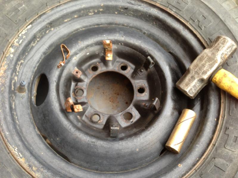

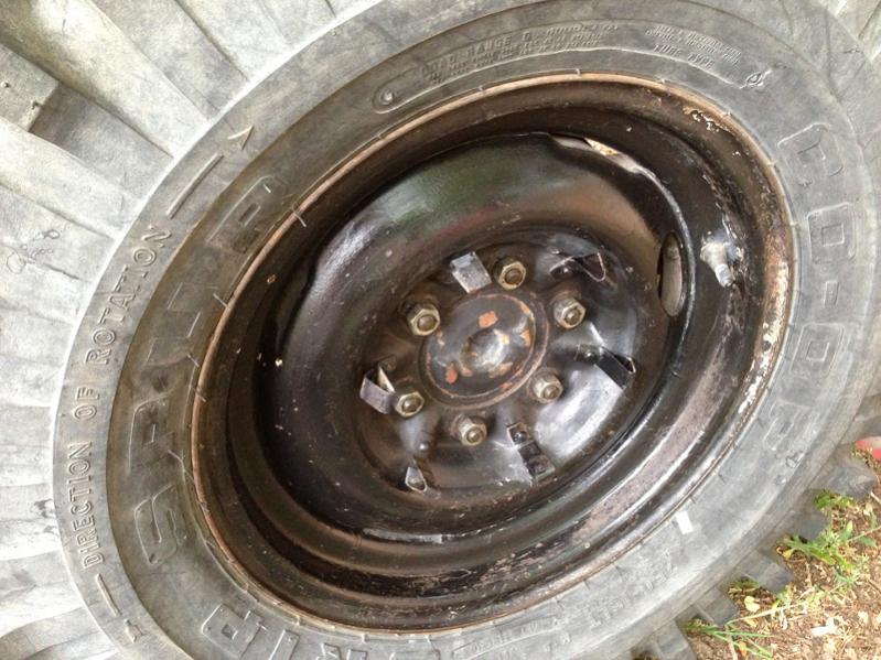

I have taken delivery of 4 genuine Toyota Steel Rims (16") with Hub Cap Clips. (Thanks Darcy!)
A couple of the Clips are broken and need replacing.
I want to keep them as original as possible.
Can anyone advise as to where I can source replacement Clips/Rivets?

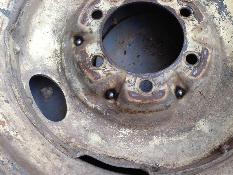

I drilled out the donor rim from the back, hammered what was left of the rivet through the new rim, and welded the backside. If you are careful, you can make the new weld look like the rivet. You never know when someone will be looking at the back side of your rims so it has to be right :)
