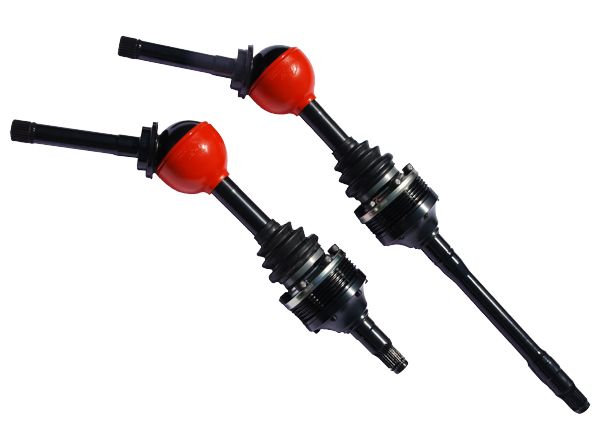

Anybody read the article in Toyota 4wd about the RCV axles? chromoloy axles, new boot design....claimed to be equal in strength to a SAS on our IFS Land Cruisers......
They did it on the 4Runner they are going to have the shootout between solid axle 4runner and ifs 4runner.... did not see it on website yet but wondered if anyone had any experience or thoughts...

I subscribe to Toyota 4WD Owners rag and I've never read a review that wasn't super duper ;)
IMO for two grand they better be dam perfect. The orange boots are harder durometer than the black boots they offer by request but the black (still hard durometer...not sure of the Rockwell # for either) generally seal more effectively for enthusiasts/non-racers.
However they don't always swipe the ball perfectly after a few miles in the dirt...allowing CV lube to escape. So in that event you can't just slap on a screw type clamp to address it in the field. You have to remove and completely disassemble the RCV joint replacing the boot(s). Pick your poison I guess.

Comparing the prototype RCV units they sent me for test fitment prior to a production run the RCV doesn't quite articulate to the same degree the OEM CV. In essence I'd have to give up a little suspension travel to get the RCV's to work on my rig...

The part that really is salt in the wound for me is that I lived up to my end of their offer (they contacted us!). I shipped them, at my expense, a Toyota OEM CV axle assembly. Yeah it was toast but its what they wanted/needed for prototype modeling. I was supposed to get, not free but at a discount, a pair of their CVs for testing and write-up. All I received were a pair of CVs that were not machined to the proper tolerance to allow fitment. Some deal.

I don't know about the history and the politics etc behind what went on with the first gen set. We have a new set at the shop to check fitment. The boot now has a clamp and the fitment issues Dan had has been addressed. I am also not convinced about the $2k price tag and if needed on the 100 series. Other Toyota IFS applications maybe.
