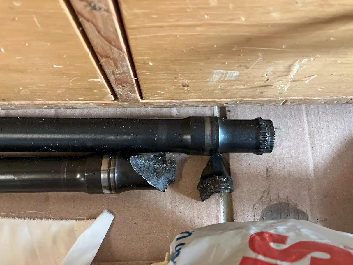

So after 3 years and countless hardcore wheeling trips on 39" tires my RCV both let go at the same time & both axles broke at the same place just inside the cage :confused:

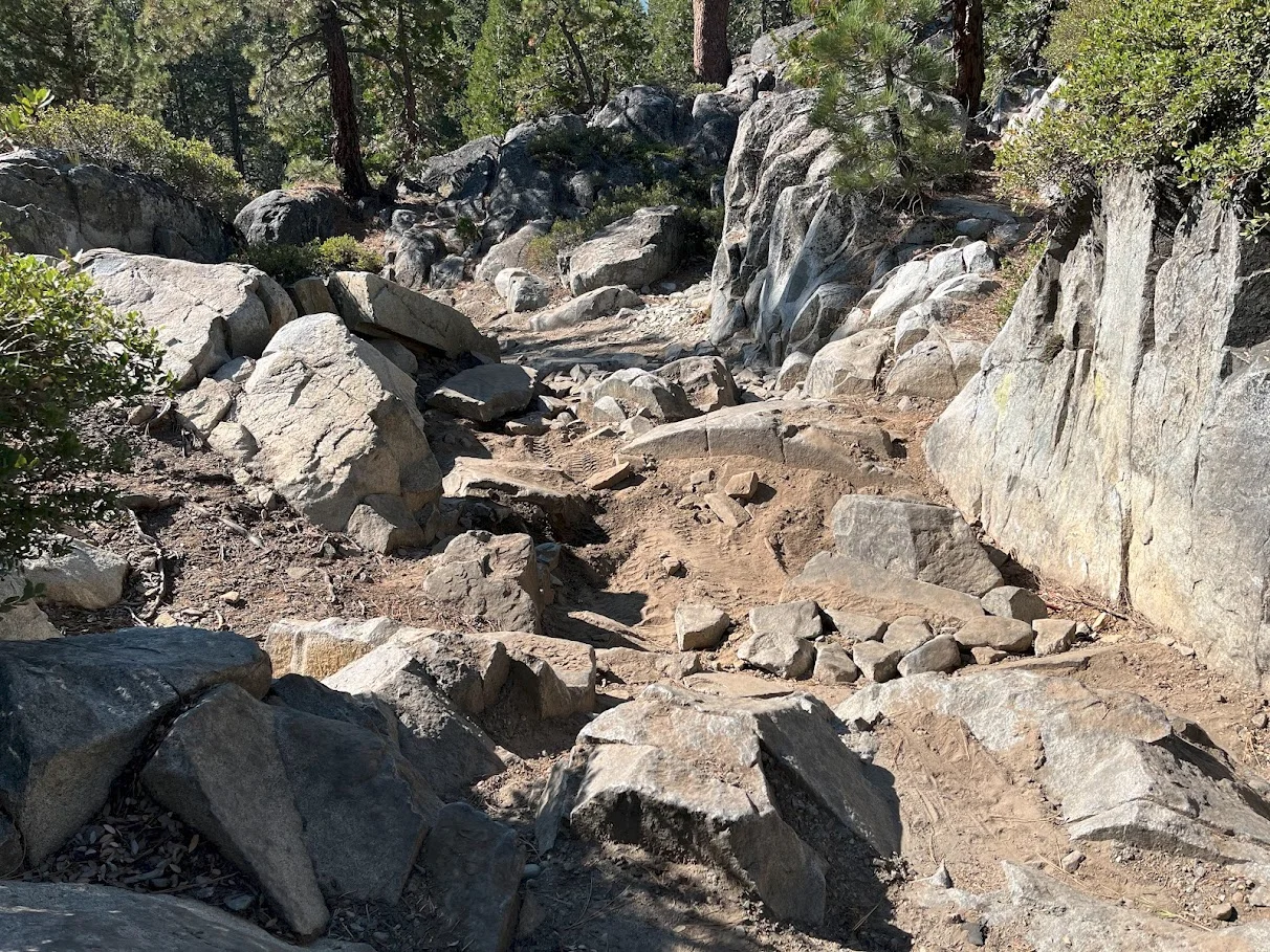

The thing is that I was not even on a obstacle, there was no bouncing,hopping,shock load, nothing like that.
Just diff hung on the rear axle housing. Really this is where I was rear diff was hung up on the rocks in the middle of the picture & trail, my fronts were where the smaller rocks are filling the hole in the trail.
It is the first time in 8 years of ownership that I had a major brake on the trail.
This leaves me wondering why they both let go like that, was it fatigue ? 8 years of wheeling with 35s then 37s and now 39s
Are the 39s just to much for that axle ?
Defect in the axles ?
I always felt The 8" third would let go before the RCV 🤷‍♂️

I did upgrade to the 300M axles 30 spline and 28MM instead of 26MM and 26 spline.

The timing for both to meet go together is odd for sure.
But 8 years of harder wheeling in a fairly heavy rig, stuff is gonna fail.
Things fatigue, and fall at some point they were obviously both at their limit, one failed the other got a sudden shock load and failed too. Strange coincidence.
you've just upgraded, don't over think it. Run them.
Wheel, break, fix, repeat.
You gotta pay to play.
Guys running heavier axles in lighter buggies still have failures. At some point something is gonna break if it keeps getting stressed to is limits whether it's abused or not.

Everything has it's limits and nothing lasts forever. Your axles hit their limit. Like mudgudgeon said, one probably failed causing an overload on the other. You're not a reckless driver beating on your truck or they wouldn't have lasted as long as they have. The same can be said for the quality of the part. If they were defective, they wouldn't have lasted this long.
