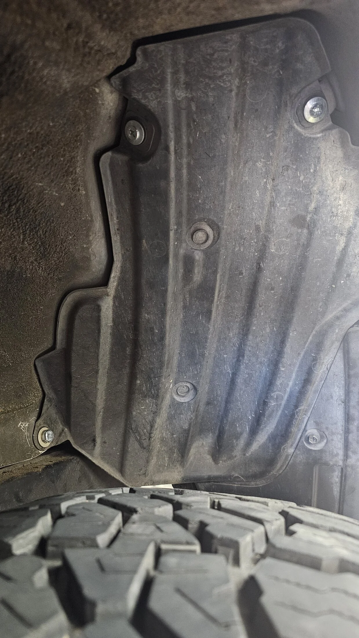

Another super-annoying, non-Lexus like rattle coming from the back. You could hear it from the rear driver's side seat, but only when you got up to 40+ MPH. Didn't find anything here on 'MUD specifically, but found a thread on CL that explained it, once I finally found the rattle :) and was looking for a part number.
I tried the usual suspects, top rear shock nut and bushings, spare tire loose, rear upper and lower control arms, KDSS bushings, gas cap, bottle jack, rear door strut (which IS loose and lightly rattles, but you can only hear it when riding in the cargo area), door latch parts misaligned, etc, etc. Nothing. Was about to take apart the e-brake, and see if that was it. When riding in the back it was most noticeable when listening down into the jack compartment (with jack removed).
Was loosening lug nuts to get to the e-brake when I hit the plastic fender liner at the rear of the wheel well, and lo-and-behold, totally loose. Banged on it, and sure enough, that was the culprit. Tried for a minute to find part numbers for the crappy plastic clips that hold it in, and gave up and went with 2 short stainless screws and washers up top, and a 8x1.25 short bolt at the bottom with lock washer and Loctite.
Problem solved.

I know this is an old thread, but let me pose a question for you as I have that rattle on my '23. When I looked in both rear wheel wells today, I only have the plastic fender liner at the rear of the wheel well on my driver side. There isn't one on the passenger side. There don't even appear to be any holes where the plastic clips would go on the passenger side. Pic #1 is the driver side and pic #2 is the passenger side. I have no idea if there ever was one on the passenger side. Does anyone have any thoughts? Would there only be one on the driver side to protect something specific?
Parts diagram confirms that there was never one on the passenger's side. There are differences back there that might justify this, AC on passenger's side versus fuel filler neck on driver's, etc.
