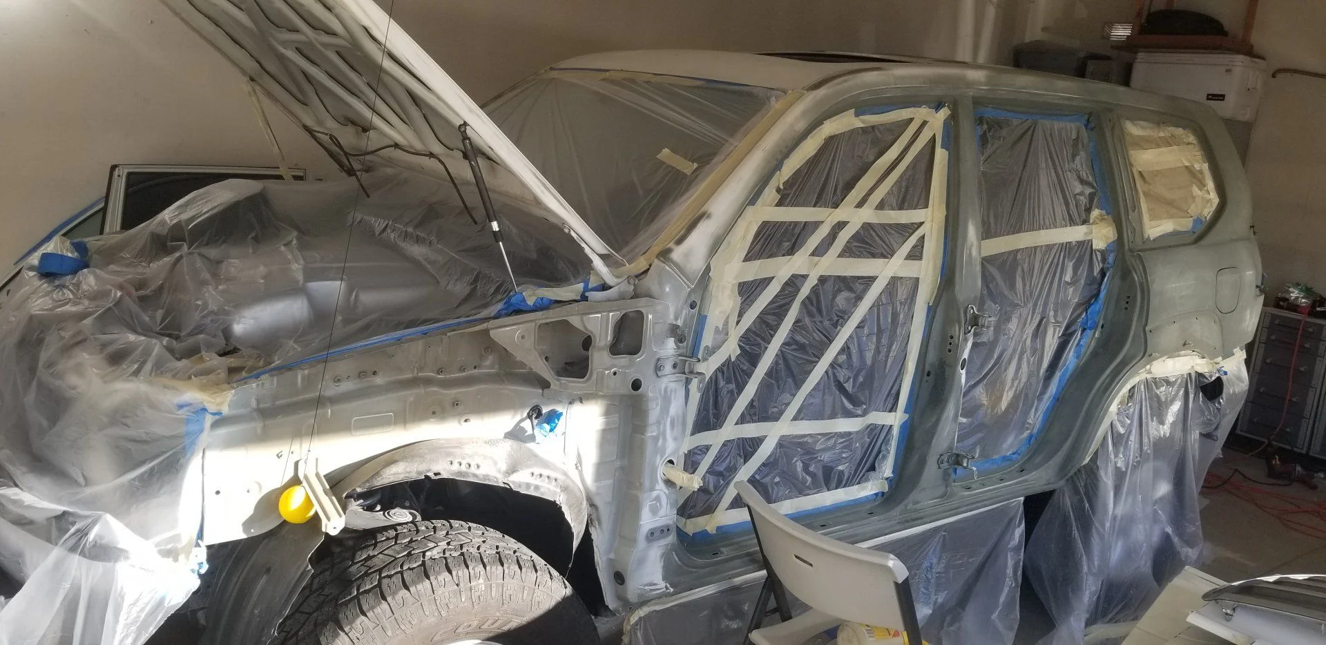

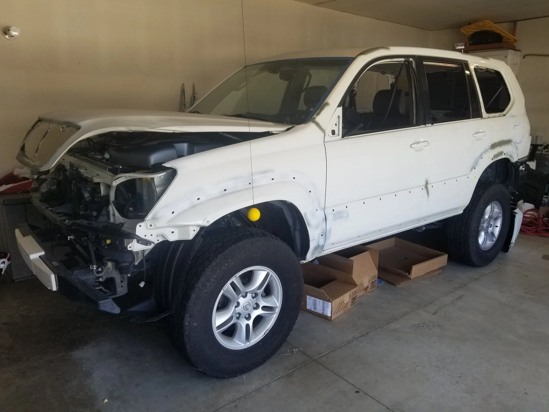

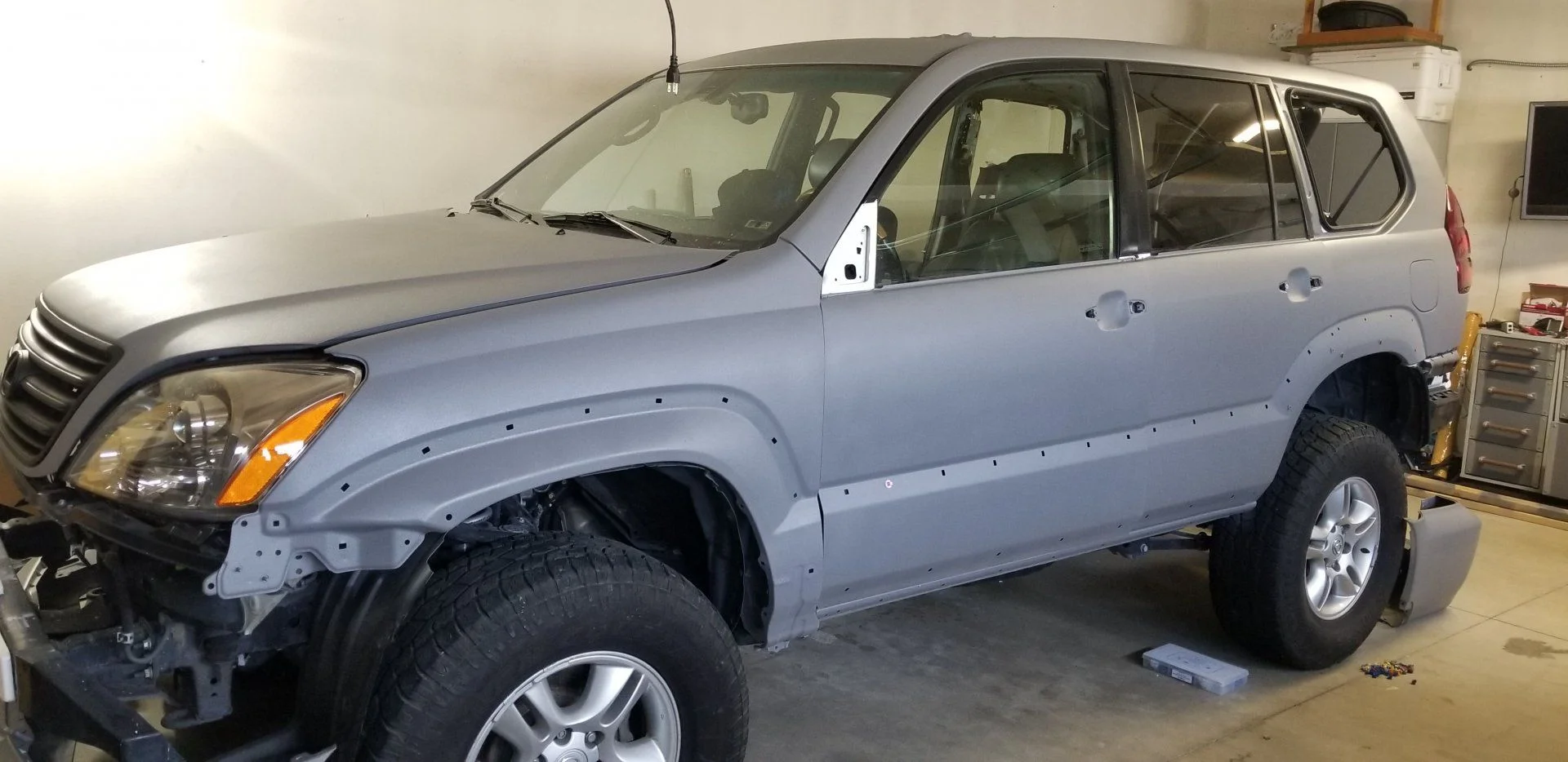

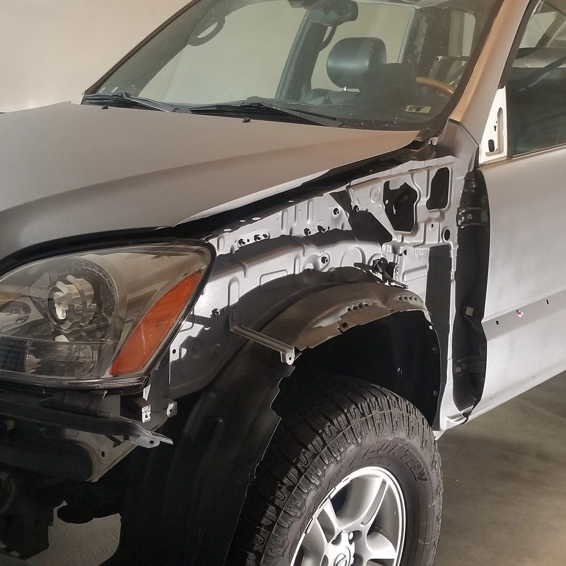

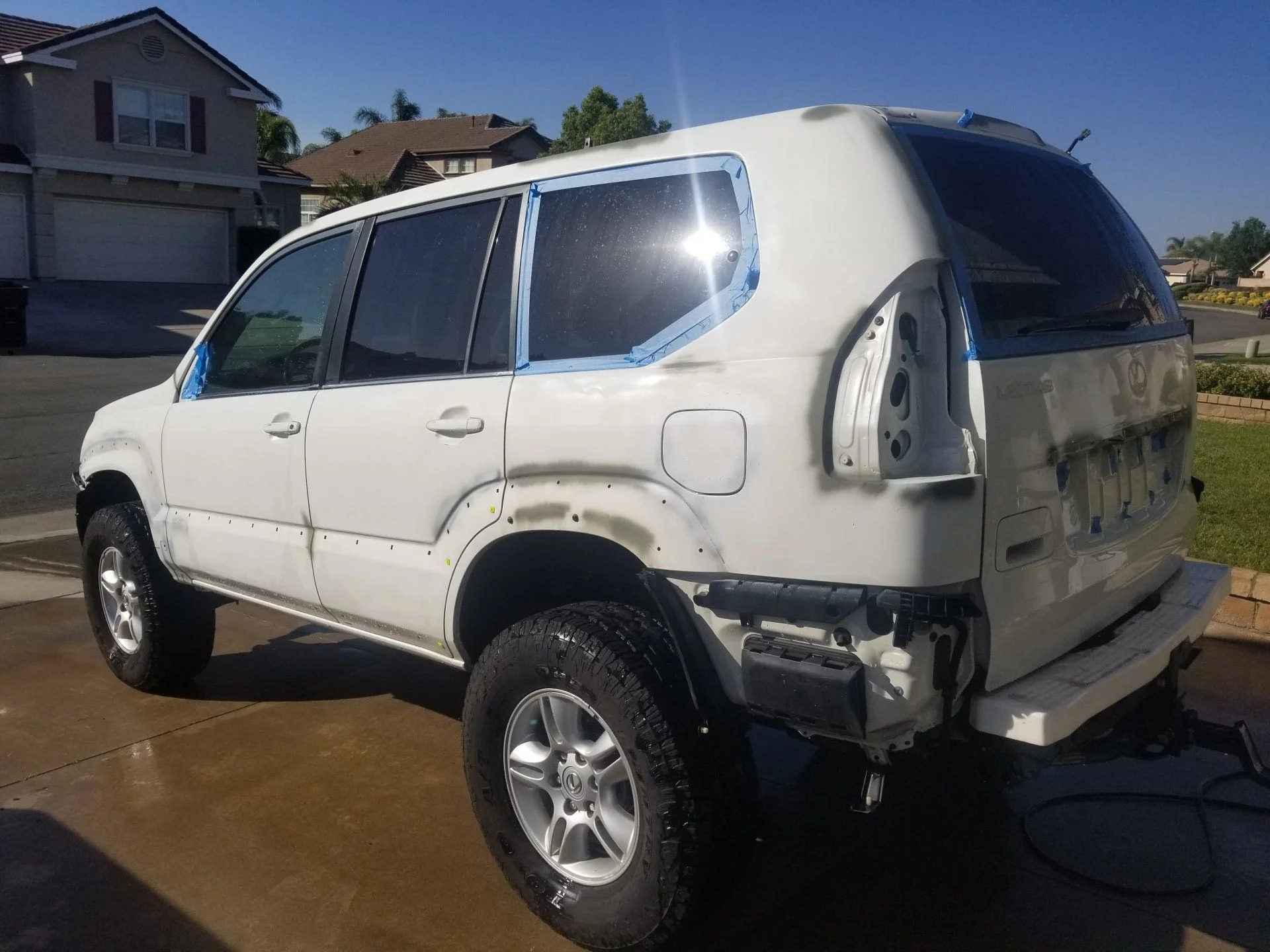

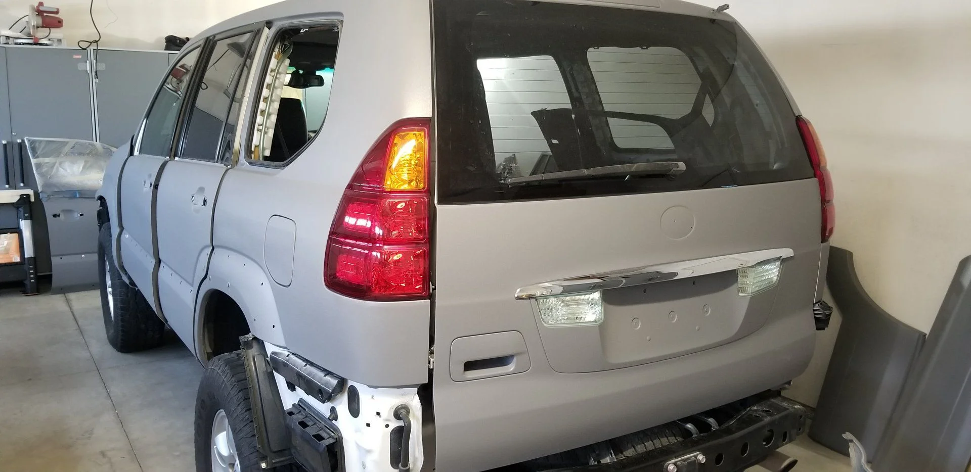

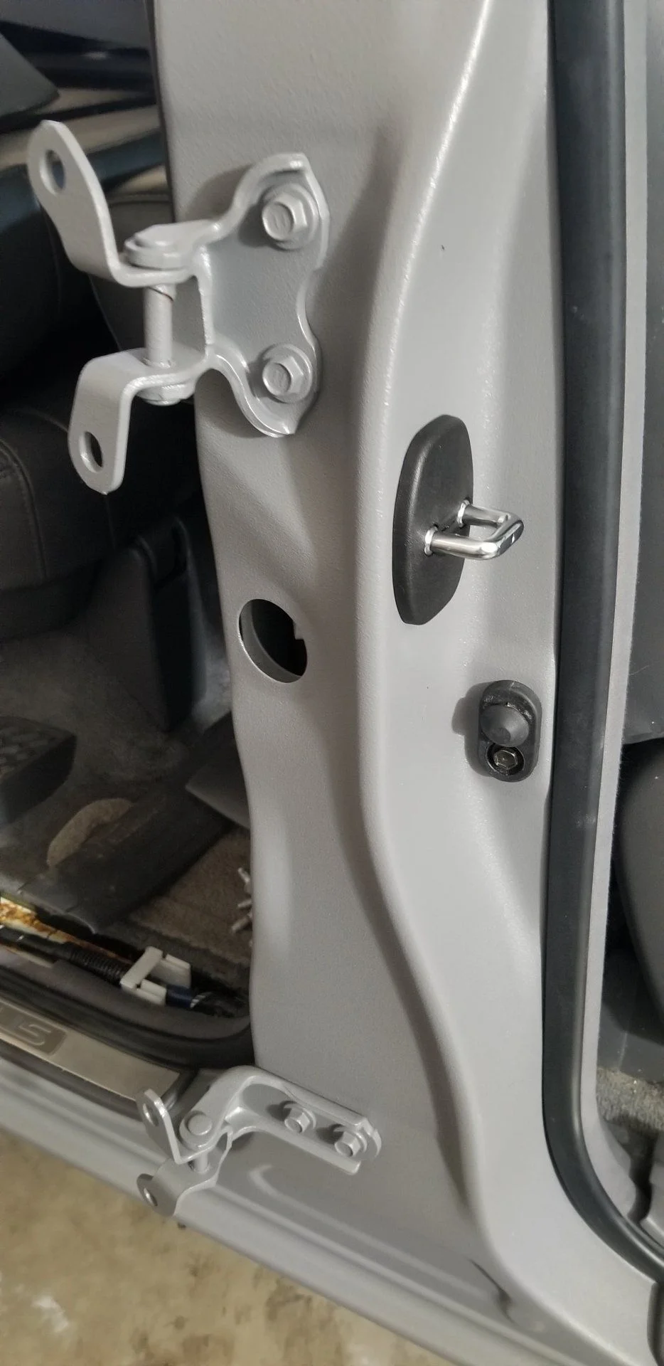

I decided to raptor spray my 2004 lexus gx. The car was peeling very bad. I have already lifted it and gone through the motor refreshing it so decided to take build to the next level since I enjoy the car. The raptor color is going to be nardo grey from the new Audi. Going to use a nice paint gun with a 2.2mm tip. so far the trim tear down has been very simple. lots of clips and 10mm bolts and a few 12mm. ordered new window trim and oem headlights. a few new pieces of rubber to make it look like new again. Sanded the entire car with 120 grit. I am at the primer stage right now and using the upol epoxy primer on the whole car. trying to decide on rims and tire combo and roof rack to add.

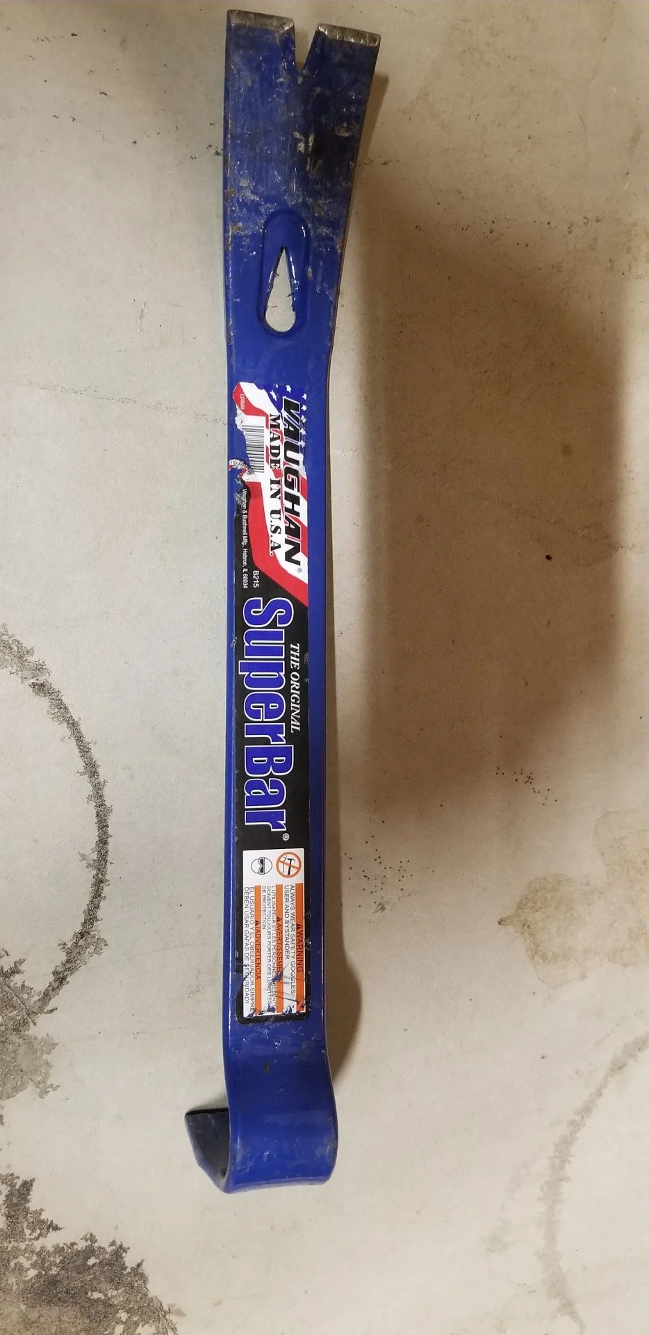

The yellow hook stanley tool did great removed the soft rubber door trim and didn't break the tiny clips.

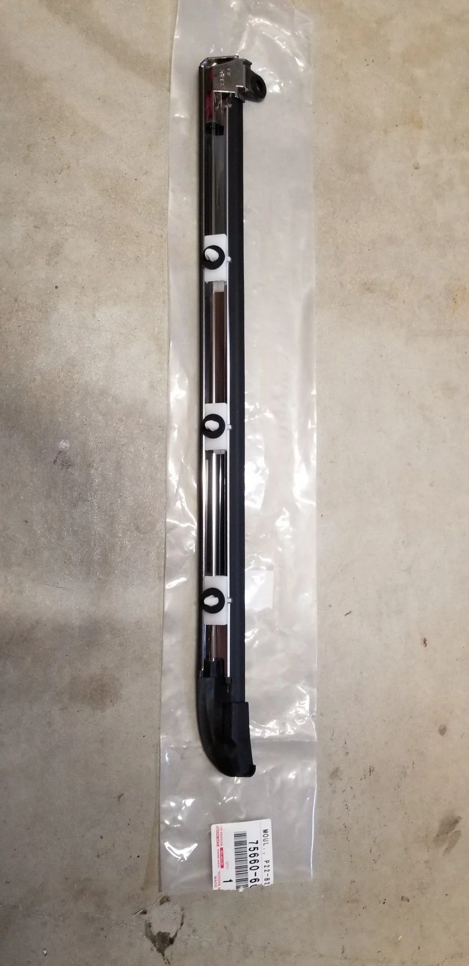

The outside window seal with the chrome was very hard to pop off without damaging. they use an adhesive on the right side maybe you can try and heat it up a little to soften the black goop. mine were very damaged coming off. I used the blue pry bar to just pop them off though. I wanted new ones to make the car look new again.
the rear window trim popped off with those three clips. but had to use a lot of force to get them to pop.
