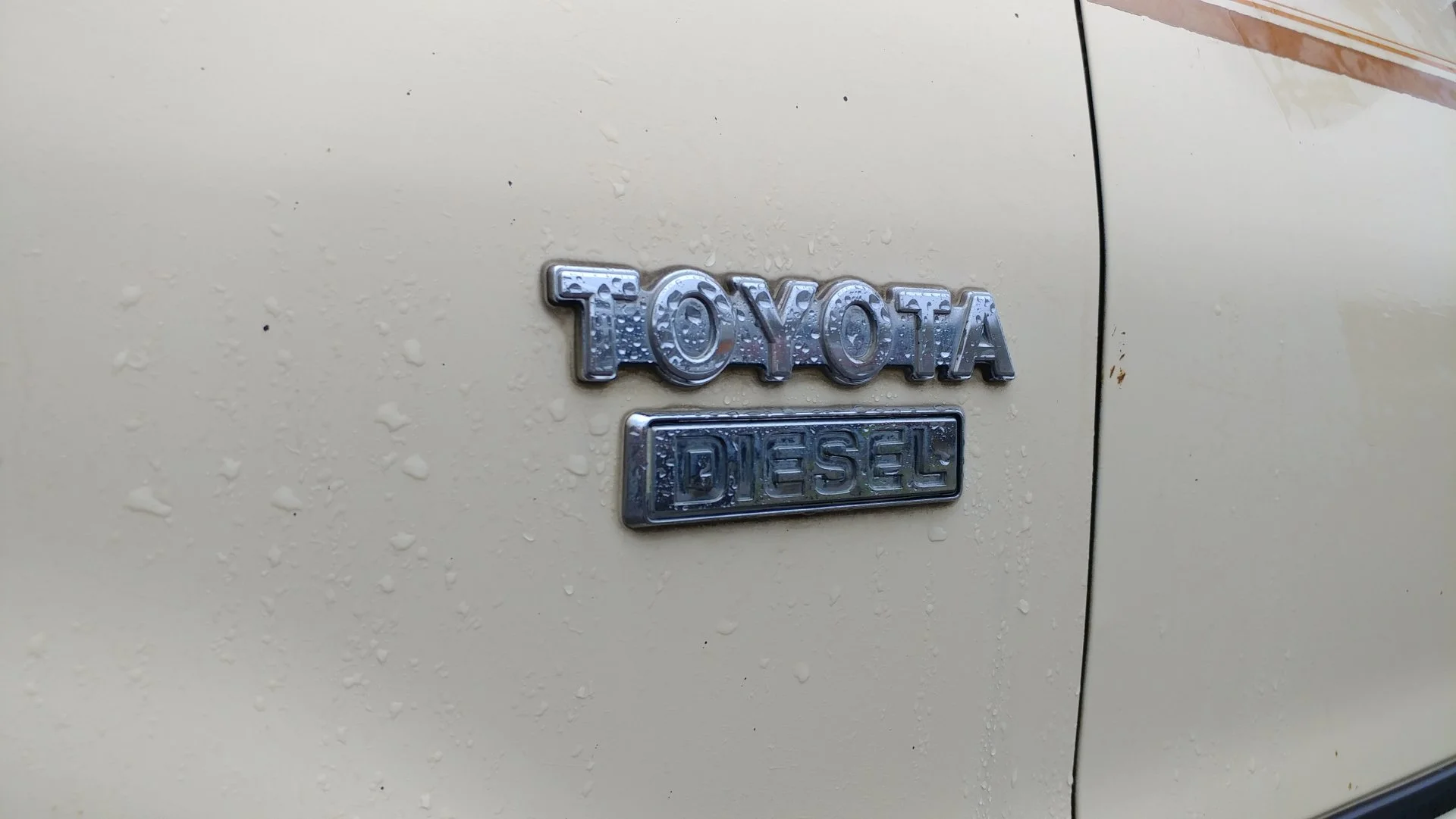

This is my 1983 Toyota pickup.
This is one of the things that makes it special.
This was my grandfather's pickup. It has an L in it mated to a 5spd. While not owned since new, I'm pretty sure Pa was the 2nd owner. He drove it around and liked to show me how he could shift without the clutch.
My dad got it from him in the early 2000s and he put over 150k miles on it. It was a commuter for several years and then he started driving another little pickup and this one became a farm truck. After a while he mostly parked it. I told him if he ever needed to rehome it, it was to come to the farm and live with me. And so it came to live with me on the farm a few years ago.
