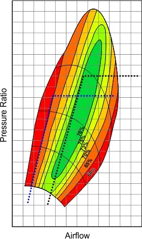

So what's better Dougal? A ct26 running at 18psi? Or a gturbo at 18psi?
My point was 18psi is an arbitrary number. It's too vague.
A ct26 pushing 18psi is way beyond its efficient range.
It's adding more heat into the air than a gturbo that's not only moving a greater volume of air, it's creating less heat during the compression process because it's more efficient.
If you have a small turbo that's 75% efficient, and a larger turbo that's also 75% efficient, theoretically the both heat the air the same amount, but that's not the only thing that's relevant.
The larger turbo shifts a larger volume of air which has a positive effect on performance, and provides an opportunity to tune in a way that produces as much or more power than is possible with a smaller turbo AND with lower EGTs.

My scenario of a ct 26 at 18psi, it would be operating toward the far right of the efficiency map. Working too hard.
A gturbo at 18psi would be in the centre, well within its design parameters.
This would mean denser air potentially accomodating increased fueling (or more complete combustion of existing fuel) therefore more power. So the benefit would be much the same as adding an intercooler?
To flip that, hotter air is less dense. If you can avoid heating the air by compressing it, then yeah, its a win.

how quickly a turbo spools up is dependent on turbine and turbine housing design, size, and efficiency, andis also affected by compressor design and size. A large compressor will take longer to overcome inertia and spool up.
A smaller turbine housing will help spool a large compressor sooner, but will choke exhaust flow sooner too, so you lose out on top end performance.
At a given turbo speed, a larger compressor is going to be pushing more air. It may take longer to get up to speed, but at every point along the way it's pushing more air too. It's not as simple as saying one spools faster than another.
As a turbo spools up, at slow shaft speeds, initially it's off the map to the left, as it spools up it will do most of its work in the verge of the map.
Under hard acceleration, full throttle, lots of fuel, mid to high engine RPM, the turbo is gonna spin faster and efficiency moves toward the right of the map. If it's poorly sized, or incorrectly wastegated, at some point its gonna push all the way to the right of the map , like the ct26 at 18psi.
I blew up a ct26 in a scenario like above, but it boost was peaking at 22psi. Way off the map, and in choke flow (the compressor spinning so fast it just chops at the air, and can no longer compress it).

You didn't say cooler. You said they're "completely different" but they're not. The only difference is compressor efficiency.
Above you've said a larger turbo has greater mass air flow. But that's not correct either. The bigger turbo can only flow more air mass if it's more efficient or on a bigger engine.
A bigger or smaller turbo running at the same efficiency push exactly the same mass of air into the same engine.
An engine fed 18psi at 70C doesn't know or care what size turbo is feeding that air.
The CT26 is an old turbo design with no compressor or turbine maps available. Gturbo make a range of turbos that are more modern and efficient but also have no compressor or turbine maps available.
There is no data to prove and answer, but it's very safe bet the Gturbo has the turbine and compressor operating more efficiently over the whole range.
Which is kind of the whole point.
A small turbo that's working hard (or an outdated design) and outside its efficient range produces more heat than a larger turbo that's within its efficient range.
Doesn't change the fact that using an arbitrary number such as 18psi above is only part of an incomplete picture.
It would be more useful in conjunction with intake air temperature information.
Swap out ct26 and grurbo for any other turbo name in the same scenarios if you like. The name of turbos is irrelevant, they were to provide an example of known turbos on this forum.
