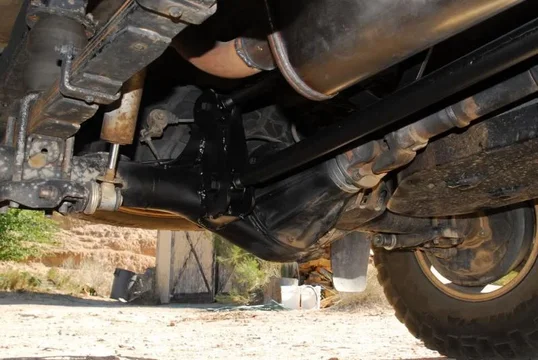

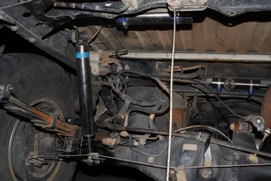

Okay, here's what I'm thinking so feel free to give input advice. If I went with a U-bolt flip, I'd have to have new lower shock tabs to go from this
to
and keep the upper tab locations because the / \ design has negative effects on a dd, especially when carrying extra weight (from others' experience)
Then I could go with a rebuildable and revalvable shock for not much more (depending on perspective) :D
Or, what about placing the shocks on the same side of the axle, creating a new upper mount (cross member) like this?
Have the room to do this since the spare is on the tire carrier bumper. Benefits/problems with this type of design?

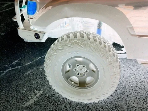

Why do you still have the '88 in your sig? And don't force me to post the pics of your greased-up (armoralled) tires, and snazzy wheels :flipoff2: Besides, I've got a plan, it's the implementation that's in committee!
[STRIKE]The runner is still in my sig because I'm too lazy to edit it plus does anyone give a sh*t about a rusty brown IFS 4runner?[/STRIKE] FIXED!!!
Post away, I'd actually like to see them myself. :flipoff2:
Don't you know that doing anything via committee is a bad idea?
You can do a better photochop job than that!!!

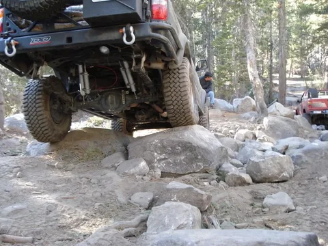

Got some lower shock tabs and a U-bolt flip kit, surprising how much space it gained under the axle. Duane (Techtafab) did the gluing, and also let me use his very cool ramp to measure for shock lengths. We were both a little shocked (har har) with the IFS flex :flipoff2:, mostly due to the fancy coilovers and recent BFH clearancing following Moab. By ramping the rear I was able to get the other rear drooped tire to come off the ground before the front, :hhmm:. May have to experiment with the shackles now, and consider orbit eyes (thoughts?)
