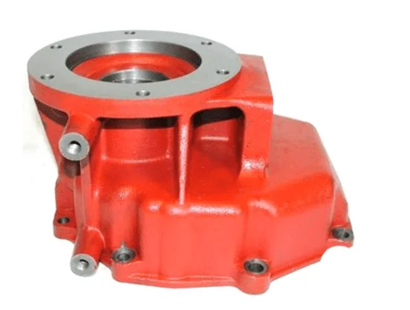

Just to make sure we're on the same page, this is the NV4500 4wd tailhousing I'm talking about:

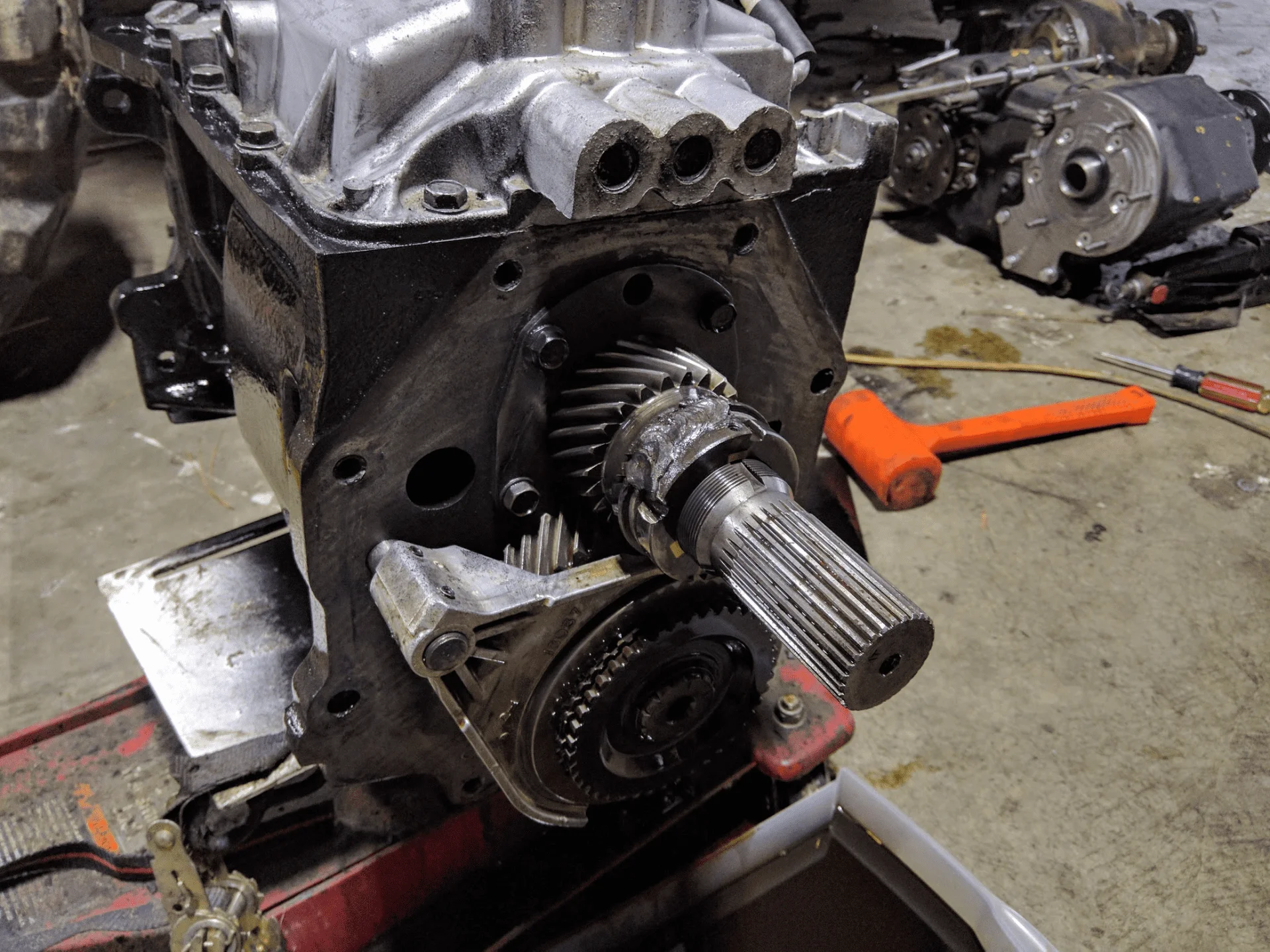

NV4500 with tail housing removed. There's very little room to make that tail housing shorter.
Yep, you are right. I didn't remember the gears taking up that much space.
