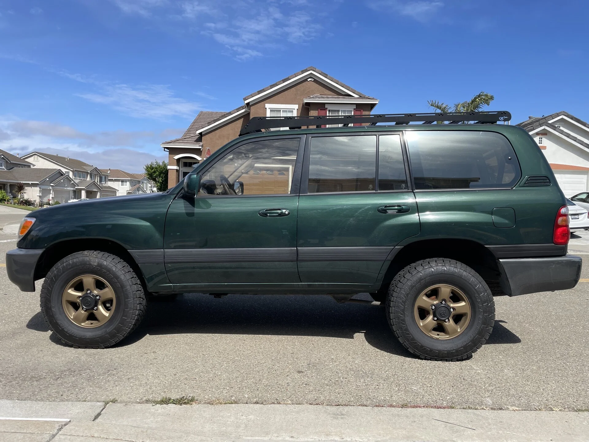

That being said, I have just recently installed medium load (0-440lbs) ironman springs accompanies with ironman torsion bars and bilstein 5160s. Been following the ironman instructions on youtube plus reading a few threads on here to ensure I install everything correctly. After install of the rear I immediately noticed a difference in height between the front and rear of the car. I thought well maybe I need to put the spare tire back on and so I did. Next I went to fully fill my gas tank up to ensure I had some more weight added to the car BUT still it seems incredible high compared to the front. (BTW the rear seats have been stowed away and are not in the car)
I went back and watched the video of installation. I had everything correct. I had the D/S spring on the passenger side. and the N/S spring (the taller one) on the left driver side.
How much rake is too much? I have already adjusted the front to be around 2inches of lift. I am getting around 60-70mm of droop as well.
Maybe I'm jumping the gun and need the suspension to settle alittle bit.
I included measurements below and how exactly I came up with those numbers.
One thing I don't want to do is crank the front up any more, I like where it is sitting.
From what I have measured I am almost at 2inches of rake. Its very noticeable.
What are my options here? Do I need to invest in a metal rear bumper lol?

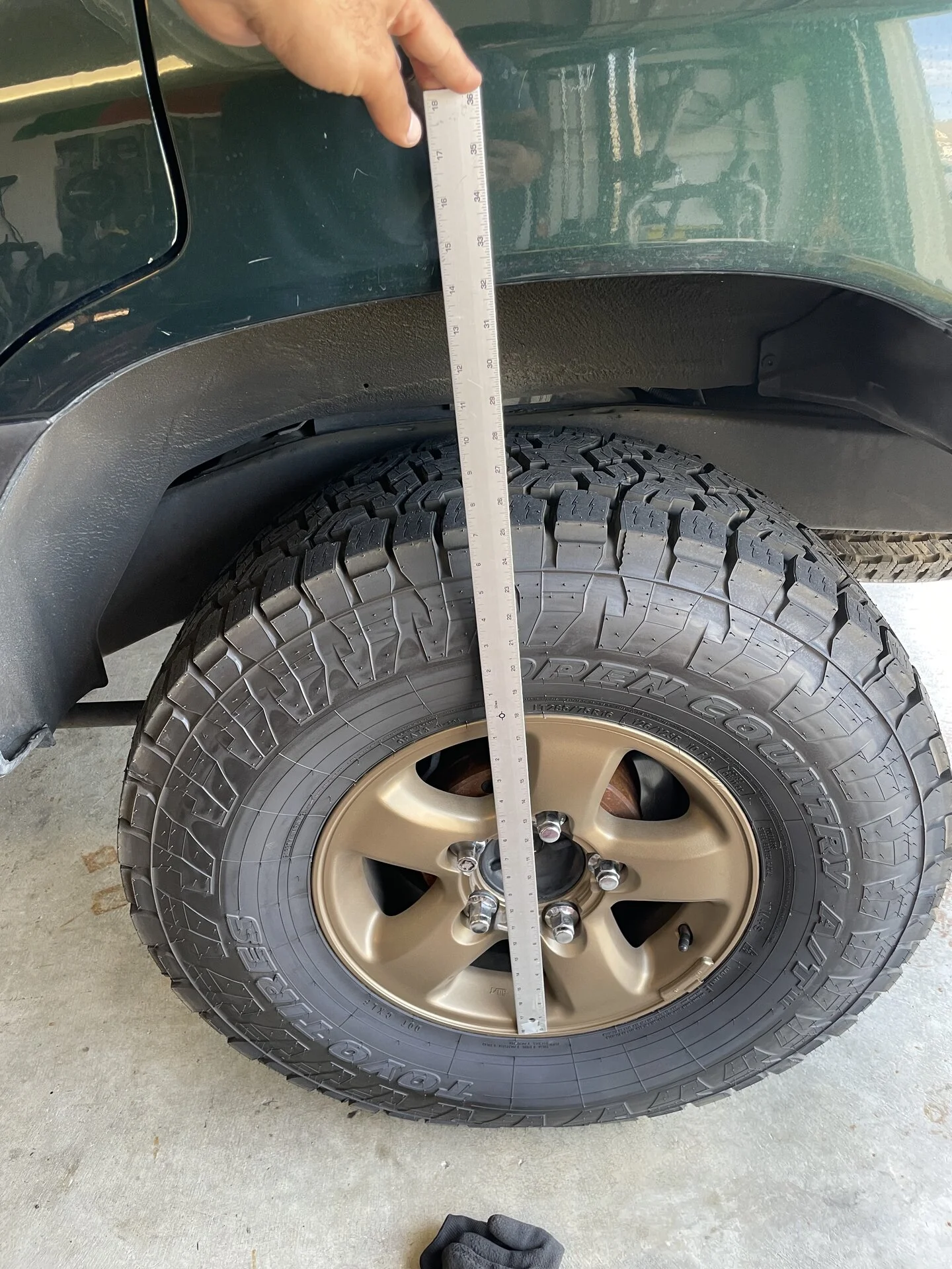

Measured with a tall metal ruler from the bottom of the rim. The ruler is seated on the lip of the rim and crosses thru the center of the hub.
Before (inches)After (inches)
Front Left (Drivers Side)27.2529.25
Front Right27.33 (close)29.3
Back Left (Drivers Side)29.531.9 (basically 32)
Back Right29.632

I think you could get more data measuring from center of the hub, as that's what a lot of others do. I mean assuming those are 18s I guess you could take 9 off, but still...
1) it will settle some…maybe 1/2”
2) I think it looks good as is
3) as soon as you load gear, cooler, stuff in it, it will be perfect.
what you don’t want is for it to sit nose-high when loaded. Worse driving characteristics, blinds oncoming traffic, harder for you to see over the hood and it looks like crap.

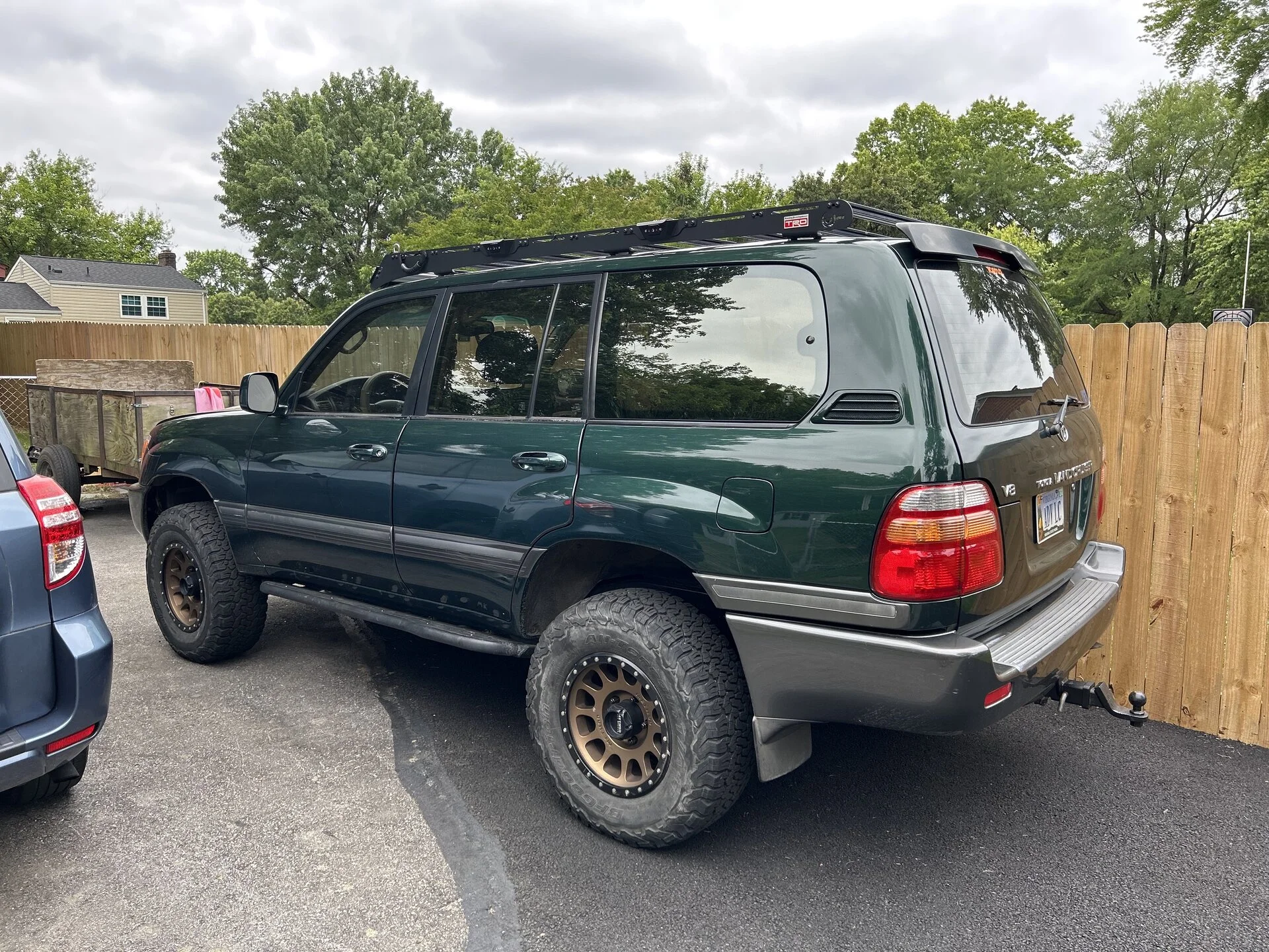

@Dmonies I also have about 2.5 inches of rake and a very similar truck! I have OME springs but I think they are the same weight level. I agree with the advice above and would say this is a good scenario for any towing or when loaded down for a camping trip. I keep a good amount of tools and some recovery gear in the back which adds some weight. I think in the future with a steel bumper it will be perfect as well.
@Dmonies I also have about 2.5 inches of rake and a very similar truck! I have OME springs but I think they are the same weight level. I agree with the advice above and would say this is a good scenario for any towing or when loaded down for a camping trip. I keep a good amount of tools and some recovery gear in the back which adds some weight. I think in the future with a steel bumper it will be perfect as well. View attachment 3337351
wow okay, did the rear coils settle a bit for you?
I'm sure they settled a small amount but I got the truck once they were on and still have this much rake. I do have my front a little bit higher with just 56mm droop driver side and 61 passenger side. I was using the same measurements and I am around 30.75 inches bottom of 17" rim to fender

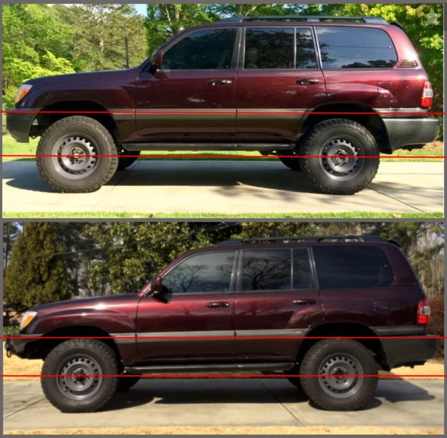

I have the IronMan 13B; 0-440 lbs. springs and TBs. Initially, we had set up the front with too much lift - not enough rake. That lasted a day. The ride was horrible. After dialing the TBs down, the rake and ride were great.
This is day one - before and after dialing the front down.
This is how the truck sits now
  • Rear: 23.25”
  • Front: 22”
  • Rear: 23.25”
  • Front: 22”
