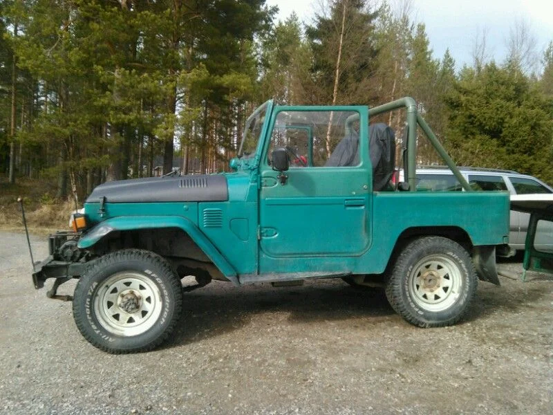

Weather is slowly getting warmer here in Finland and i start to dream about taking the top off from my BJ40. Here where i live we get rain so often that i would need to have somekind of rain cover that i could put on when parking the BJ or when we get rain while riding. It would need to be easy to put on and off.

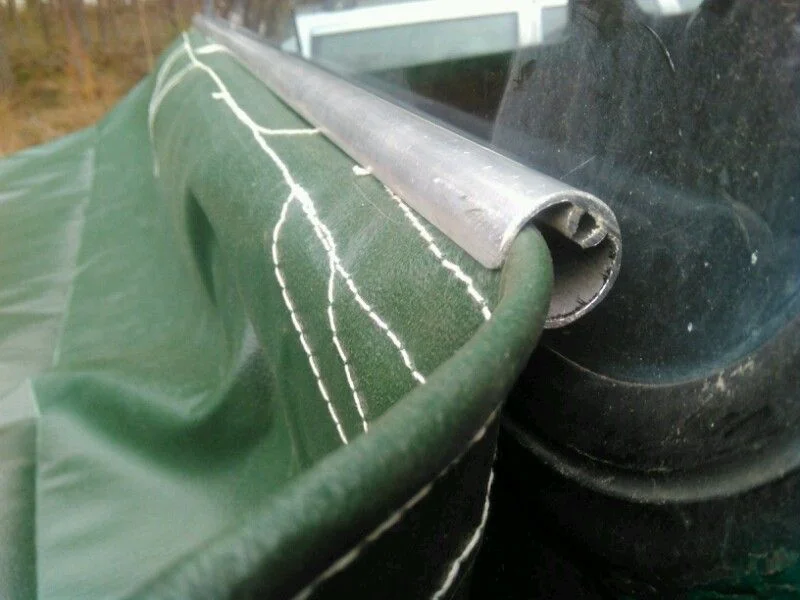

I allso found from my junk pile a aluminum profile that might go as C-channel? It´s a bit short, but not too much. I will look if i could change the rope inside the tarp edge to a thicker one and still fit it on the profile channel?
Those factory made bikini tops would sure be nice and i wish i had the funds to buy one! I´m a bit on a budget with my BJ and it has a lot of work to be done to it in the near future, so i will save those limited funds for more necessary parts!
:cheers:
That profile i got is just a bit short. Not sure if i could make it work? Rope inside of the tarp edge seems to be thick enough. I tried to pull it off the c-channel but couldnt get it to fail even if i pull as hard as i can.

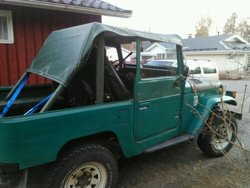

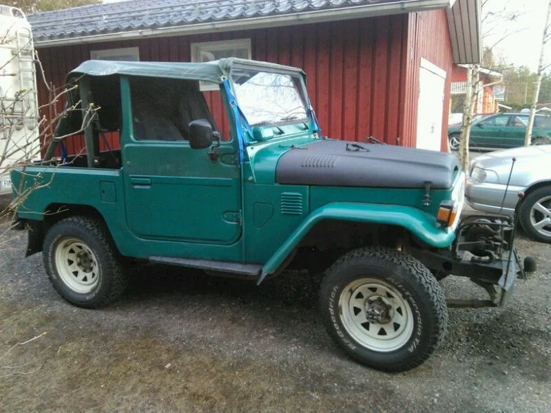

I got the c-channel and tarp installed today. It stayed in place in 100km/h speeds too in my test ride.

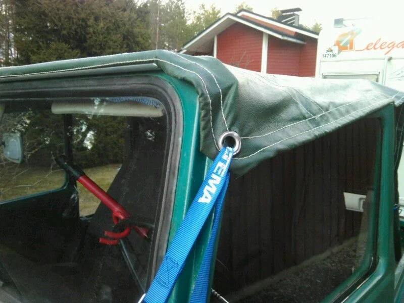

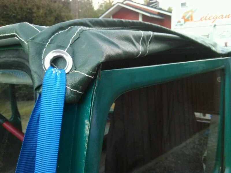

First plan was to cut the tarp a little narrower so it wouldnt go over the door frame. But after installing and testing i think im keeping it as is (even though its not too pretty). When i park the car i can fold the edge of the tarp over the door frame and prevent rain getting on the dash. When i go to drive i fold the edge of the tarp over it self to free the top of the doorframe so i can open and close the door freely.
Not pretty, but functions really good, espesially considering the money i spent on it. 19.90€ for the tarp and around 9€ for the straps, c-channel was free from the scrap pile.
I still need to test if i could paint those straps black to make them look a bit better?

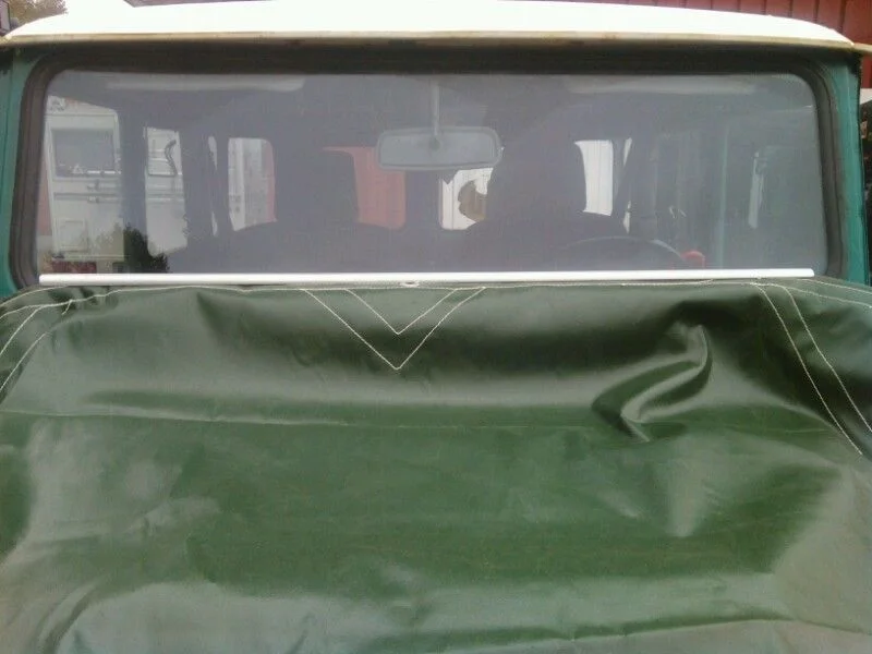

Theres a funny effect on that C-channel when driving without the tarp in it. It whistles (to the ladies??:smokin:) in the wind after speed get over 60km/h.
I thought that those holes that i drilled in the c-channel to mount it was making this whistle and put tape over them but the whistle was still there.
When i put my hand over the windshield frame and c-channel the whistle stops. It doesnt matter whitch part of the channel im covering if i just use my whole palm to cover big enough part.
I still need to experiment a bit with the whistle and try to think of some way to either cover the c-channel or fill the groove in the c-channel when the tarp isnt there.

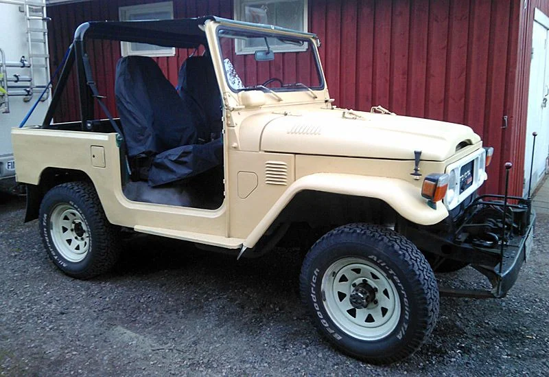

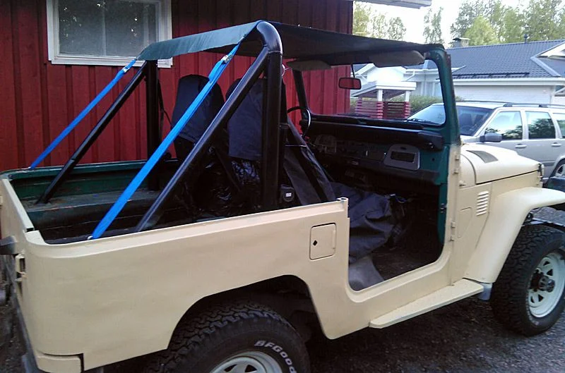

I got another tarp and cut it smaller to make it look a bit better. I allso sew those straps on the tarp so they are a bit easier to attach when putting the tarp on. It doesnt give as good cover from the rain as the bigger one, but i can use that big one when i park the BJ and know its going to rain. (I allso painted the BJ to temporary color until i get all bodywork done to it)
