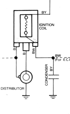

FSM shows it on the + side. You typically install it on the + side of the coil for RFI suppression. The one on the negative side (on the distributor) would be to protect the points contacts.

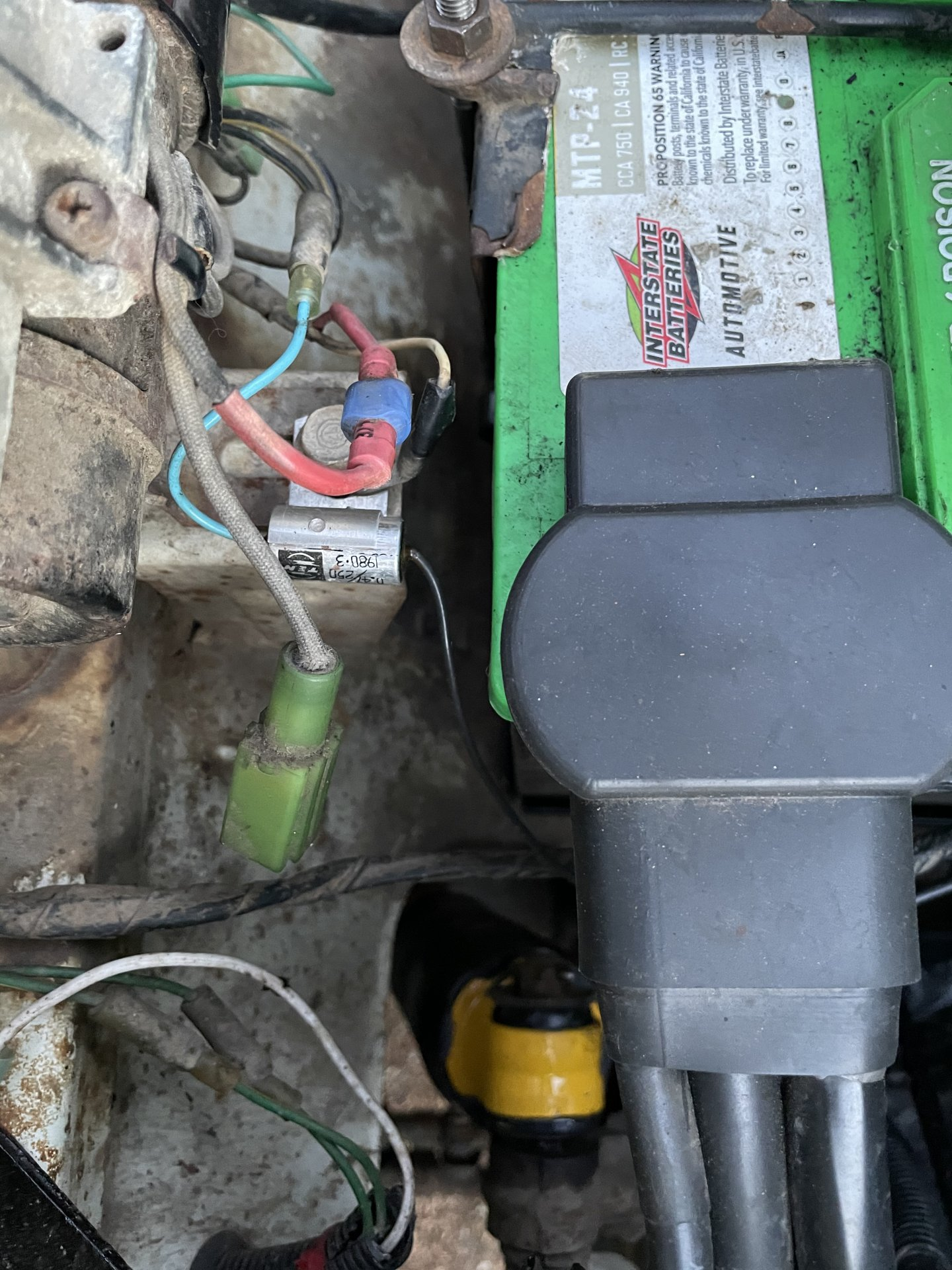

I replaced a bad coil and now have radio noise. Nothing but the coil was changed.
The noise is louder with more RPMs.
Any suggestions?

The capacitor from coil + to ground seems like the best idea. I will try it and see

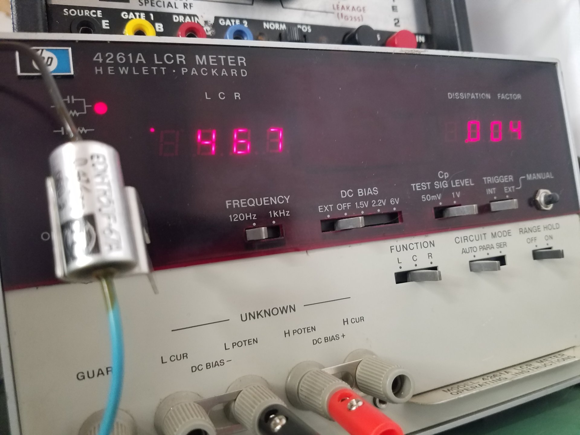

They are usually specified .5 mfd (really 0.47uf) 200-300V. The one Matt sells fits the bill.
I went looking for a RF noise suppression capacitor, after hitting numerous "parts" stores and getting the same confused look from every one of them, I found a store that not only knew what they are, but actually had one in stock! I didn't care what the specs were. They did have it listed under condensor, not capacitor.
Put it on the coil+ to ground and everything works just like it should.
