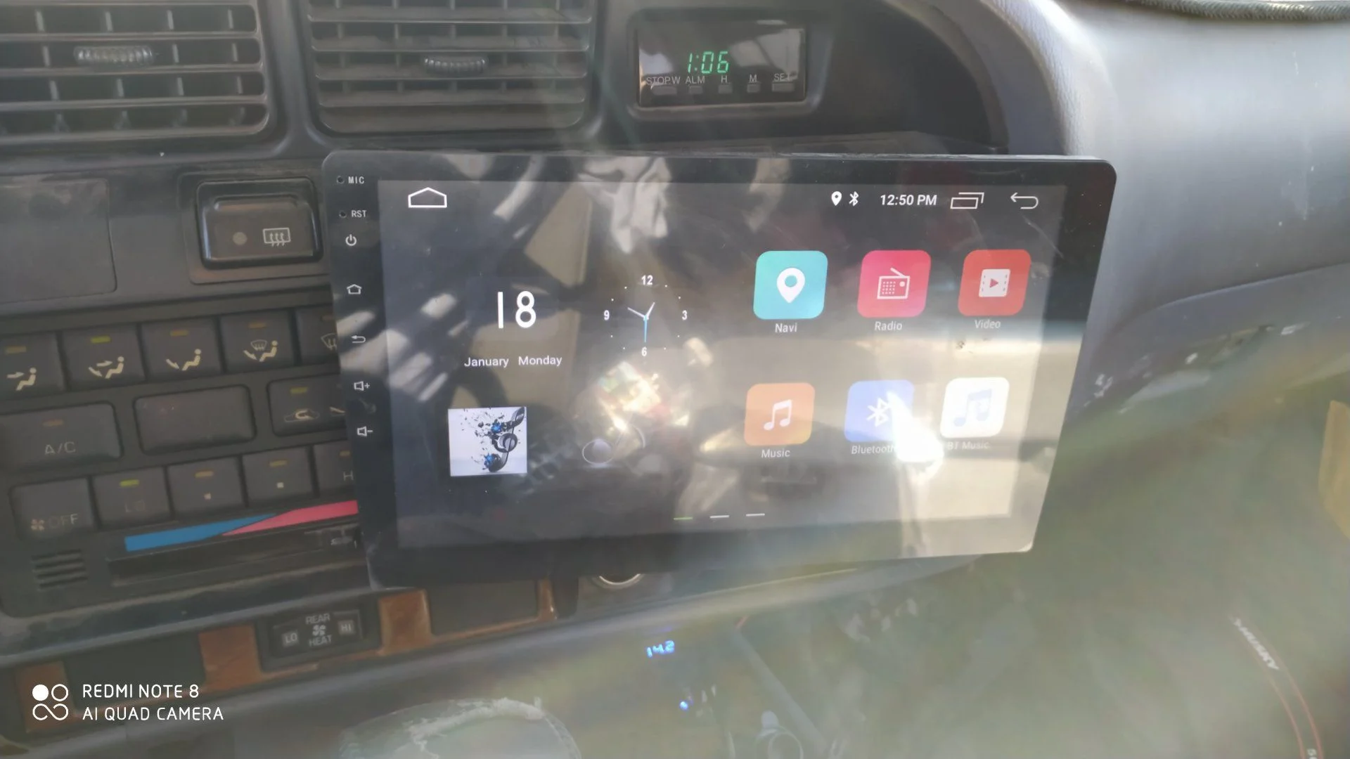

I install a cheap chinese double din 10.1 android unit for over 2 years now. For only 180 bucks, it's work fine but it's take about 15 second to boot up when you start the car.
