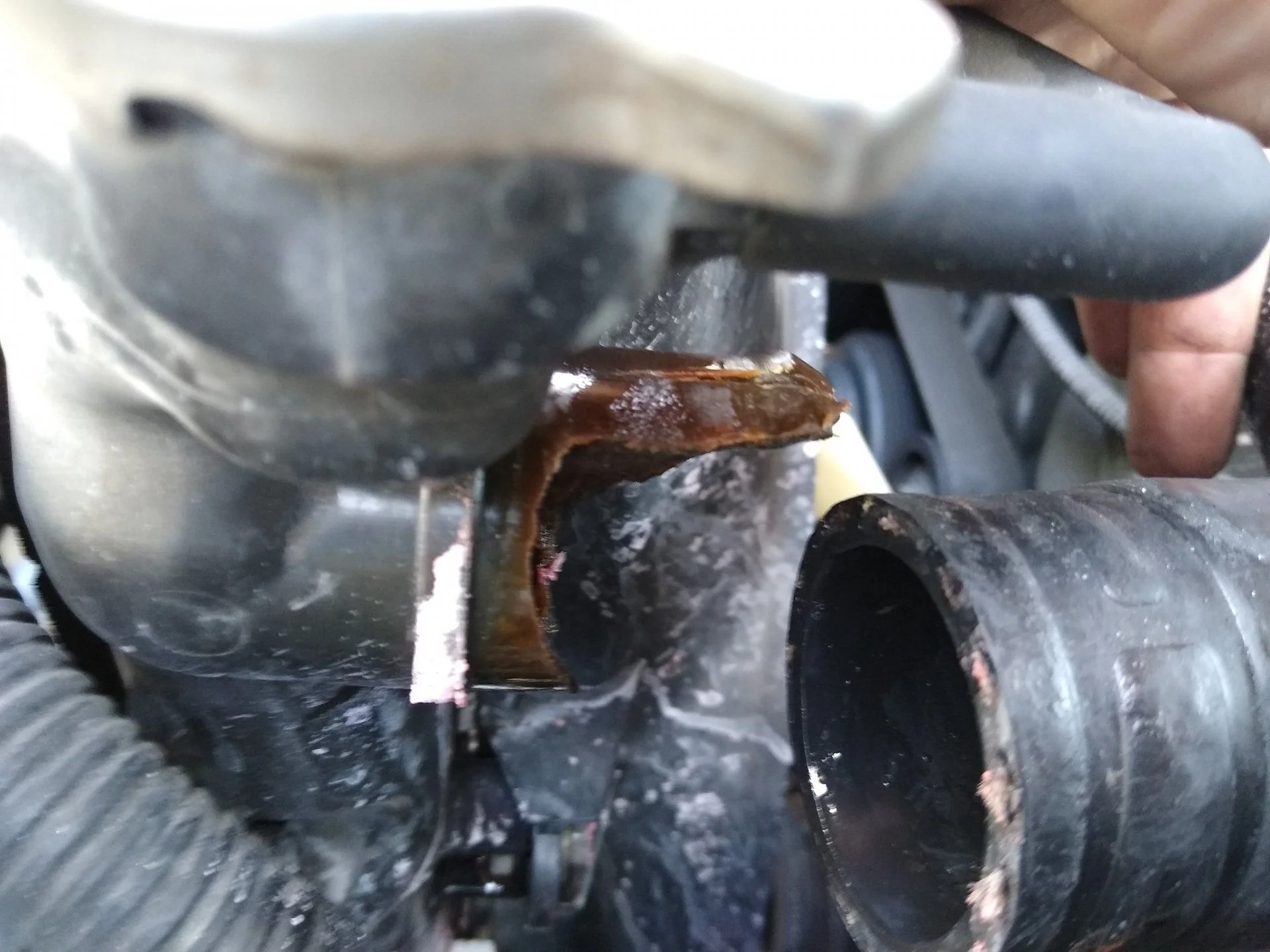

Half the neck of my radiator disappeared and started leaking :(
1.) How do I make sure no chunks of plastic are in the engine. I'm assuming it would either be stuck in the radiator or the thermostat.
2. ) How do I get to lower radiator bolts out? Even with the shrowd detached and slid back you can't reach them. I can't see them from the bottom bc a support is there and from the top you don't have mutch room to rachet. Maybe 1.5" gap between the shrowd and the radiator down there. Did you use a rachet or wrench, or take off the fan and then shrowd? All I can find is gx470 YouTube videos to remove the radiator.

I updated my OP about the radiator vs just hoses. I found a crack/half missing chunk in the upper neck. Is there a write up around or vid on radiator removals? I can get to the lower radiator bolts.
