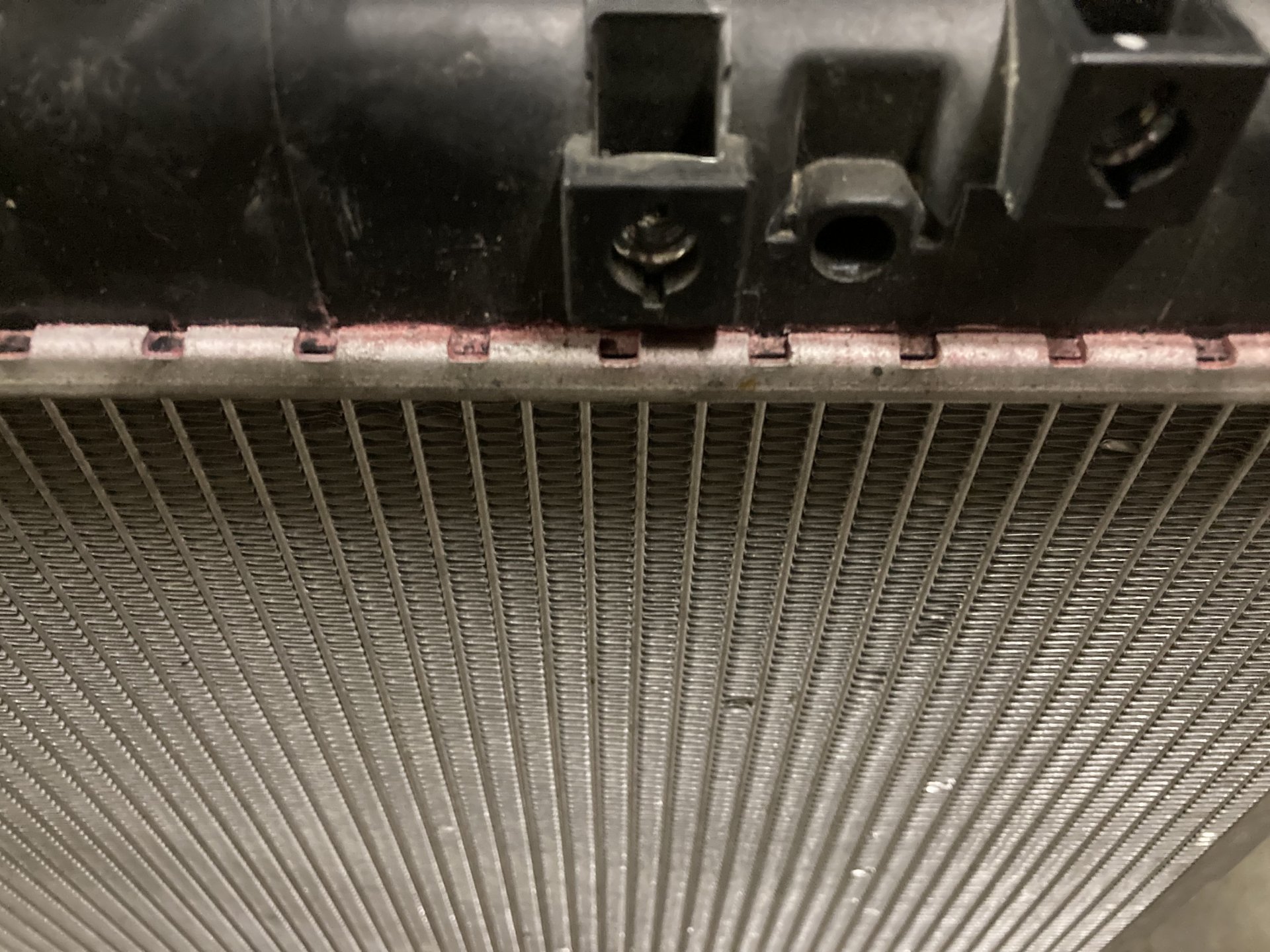

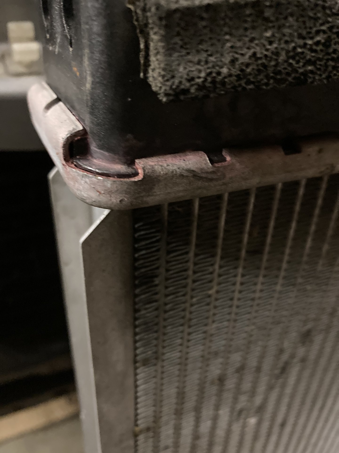

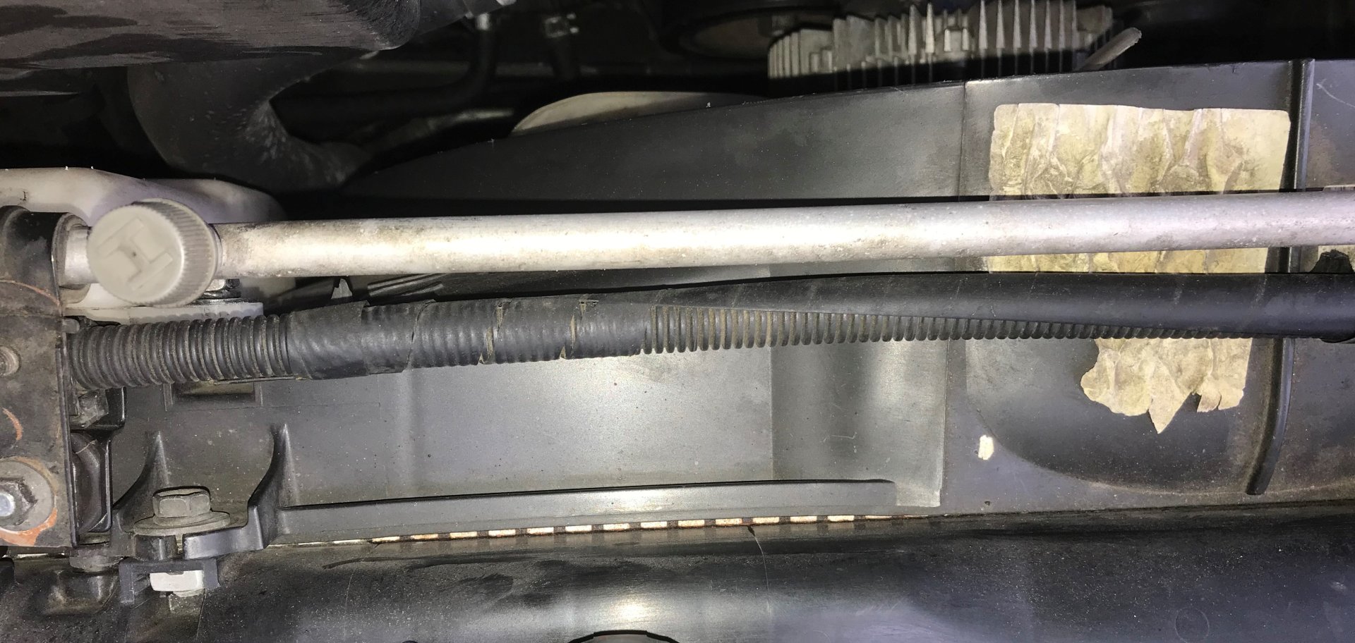

Quick update on mine: The upper tank is stained with coolant in multiple locations where it meets the aluminum, with no staining anywhere above.
Also some evidence of where coolant was dripping down the side the radiator to the lower tank.
I never found any evidence of a leak on the bottom end. So it appears that @nissanh was right and the upper plastic tank was no longer sealed well to the aluminum core, which didn’t come to light until freezing temps hit.

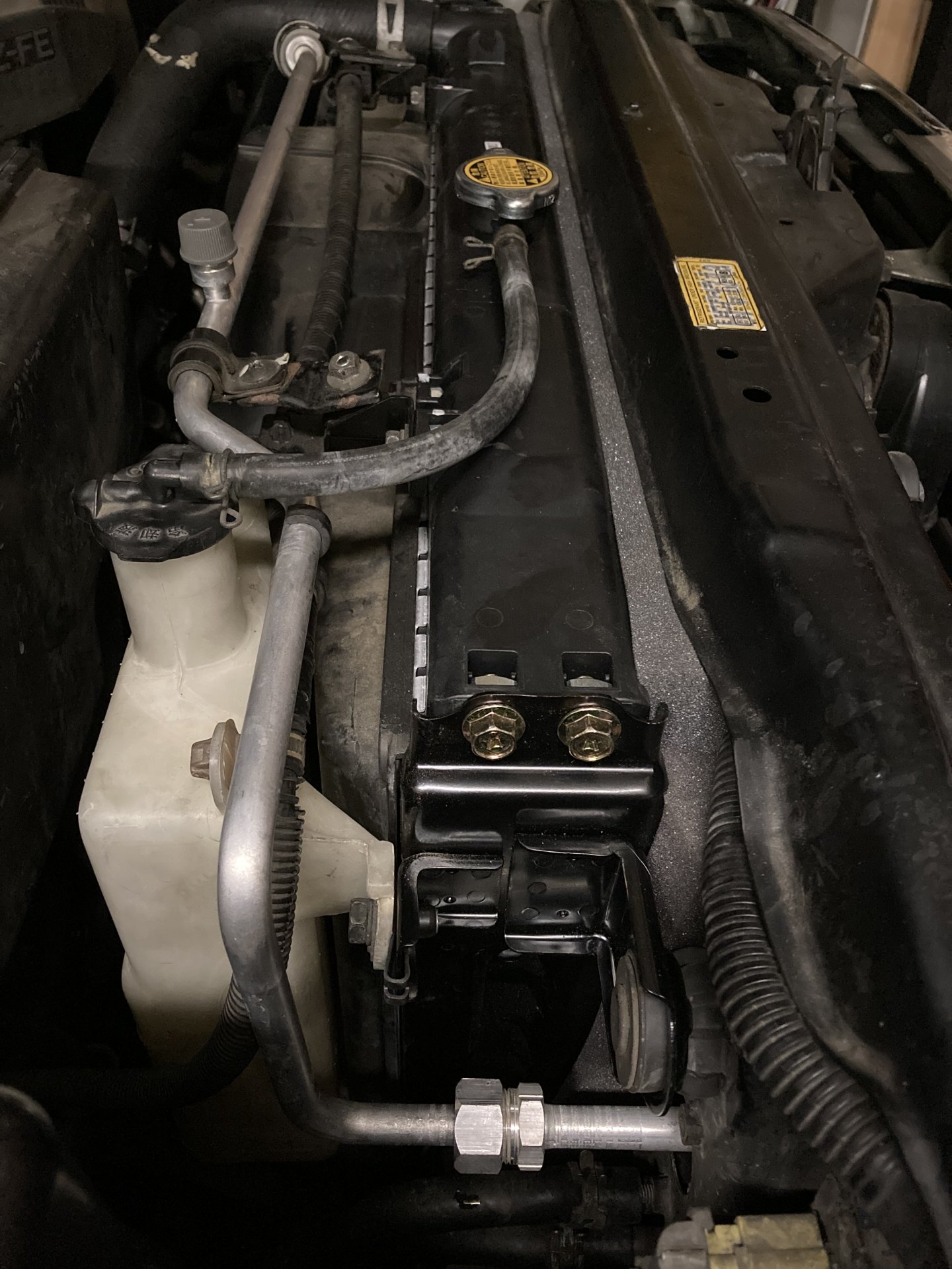

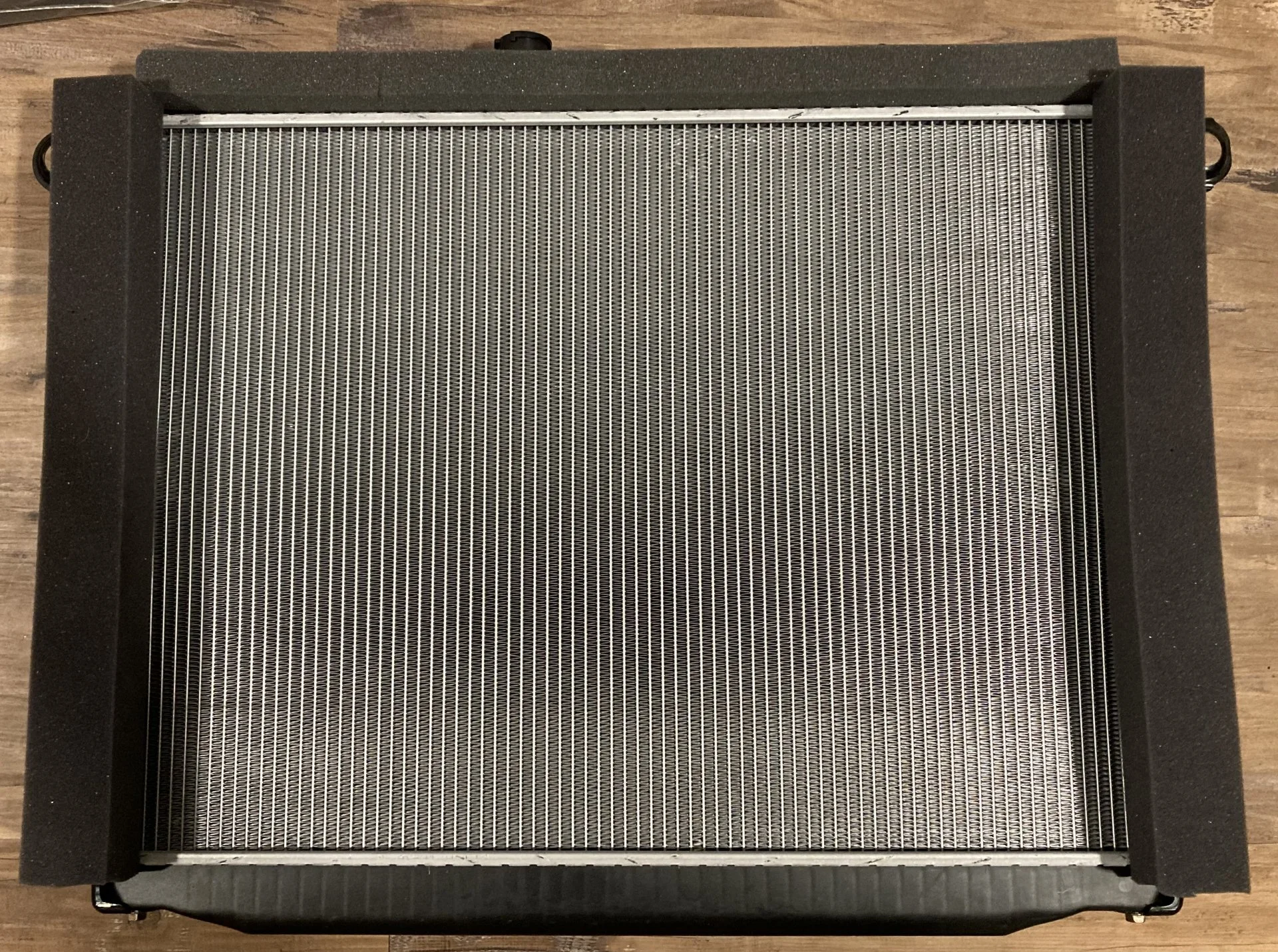

I dropped in a new Denso rad that I put fresh foam on, along with a new thermostat and o-ring. Will fill and bleed the system tomorrow, but hopefully good to go 🤞🏽

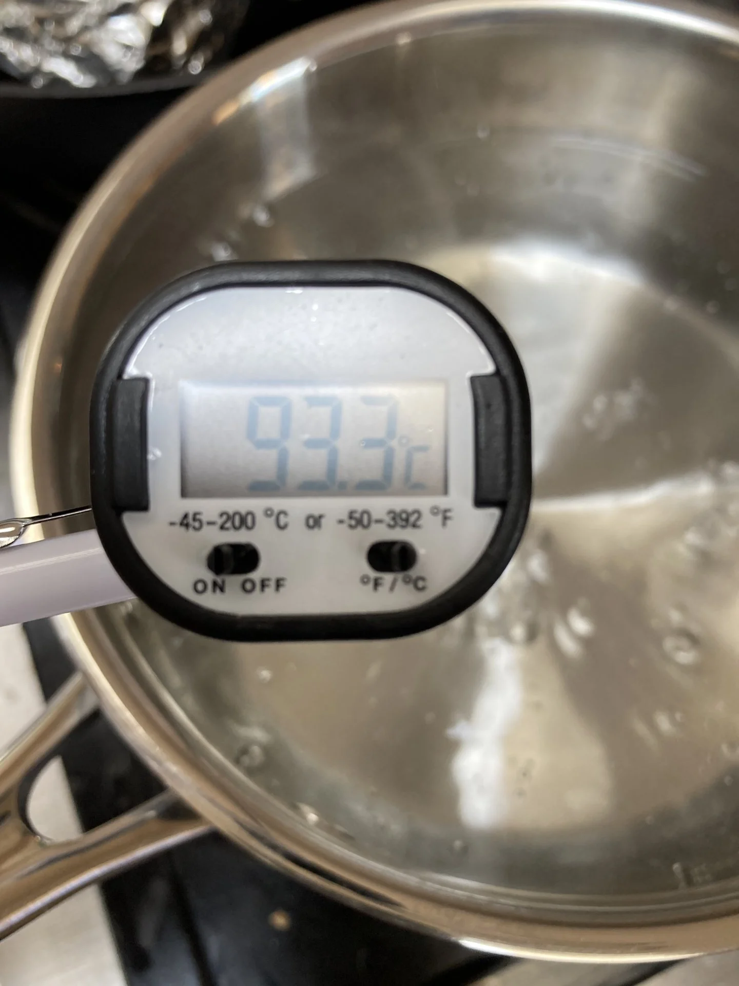

Just checked the 2 yr-old OEM thermostat by heating water to 93*C, dropping tstat in, and checking that it opened quickly and then gradually closed as water temp cooled to 82*C. The thermostat worked fine.

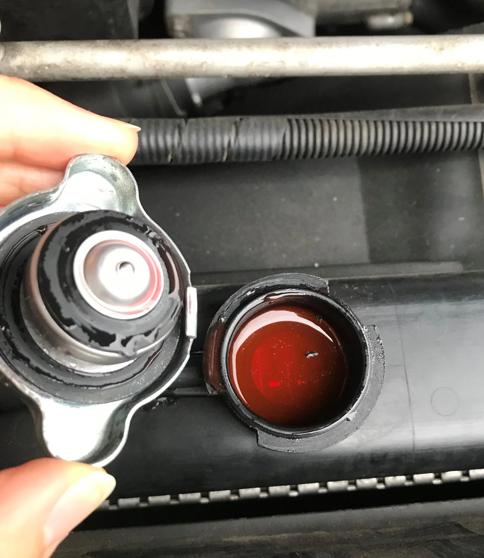

Well I got curious and caught a break in the rain so I went out to take another look. Truck has sat since Saturday evening and it was raining today in the 50F's so no sun to warm anything up. Overflow tank was about an inch above the low level so it probably needs to be topped up. Radiator was still filled right to the top of the neck. Did find a few floating pieces of black plastic in there which I have no idea what they are from which is slightly concerning.

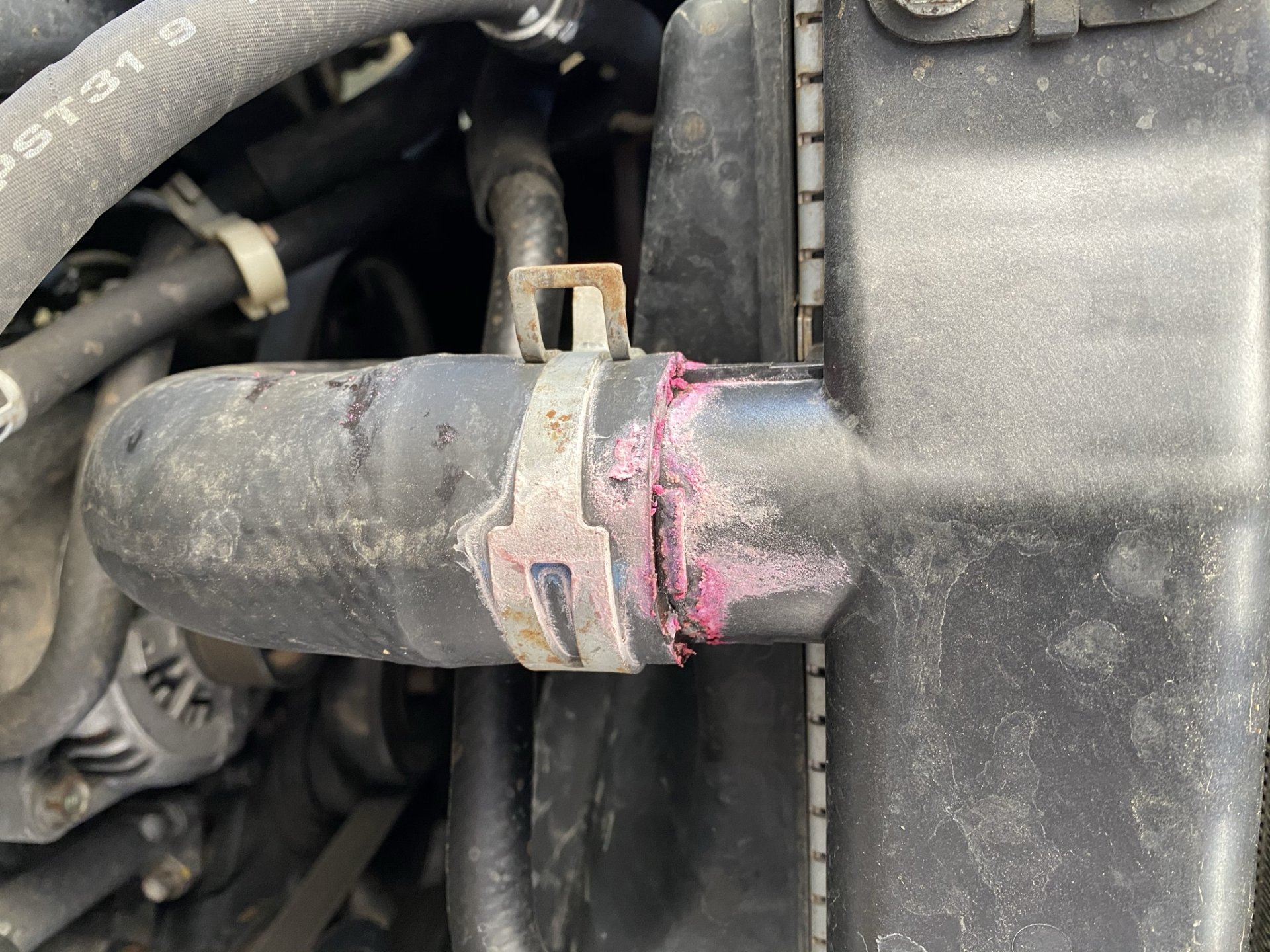

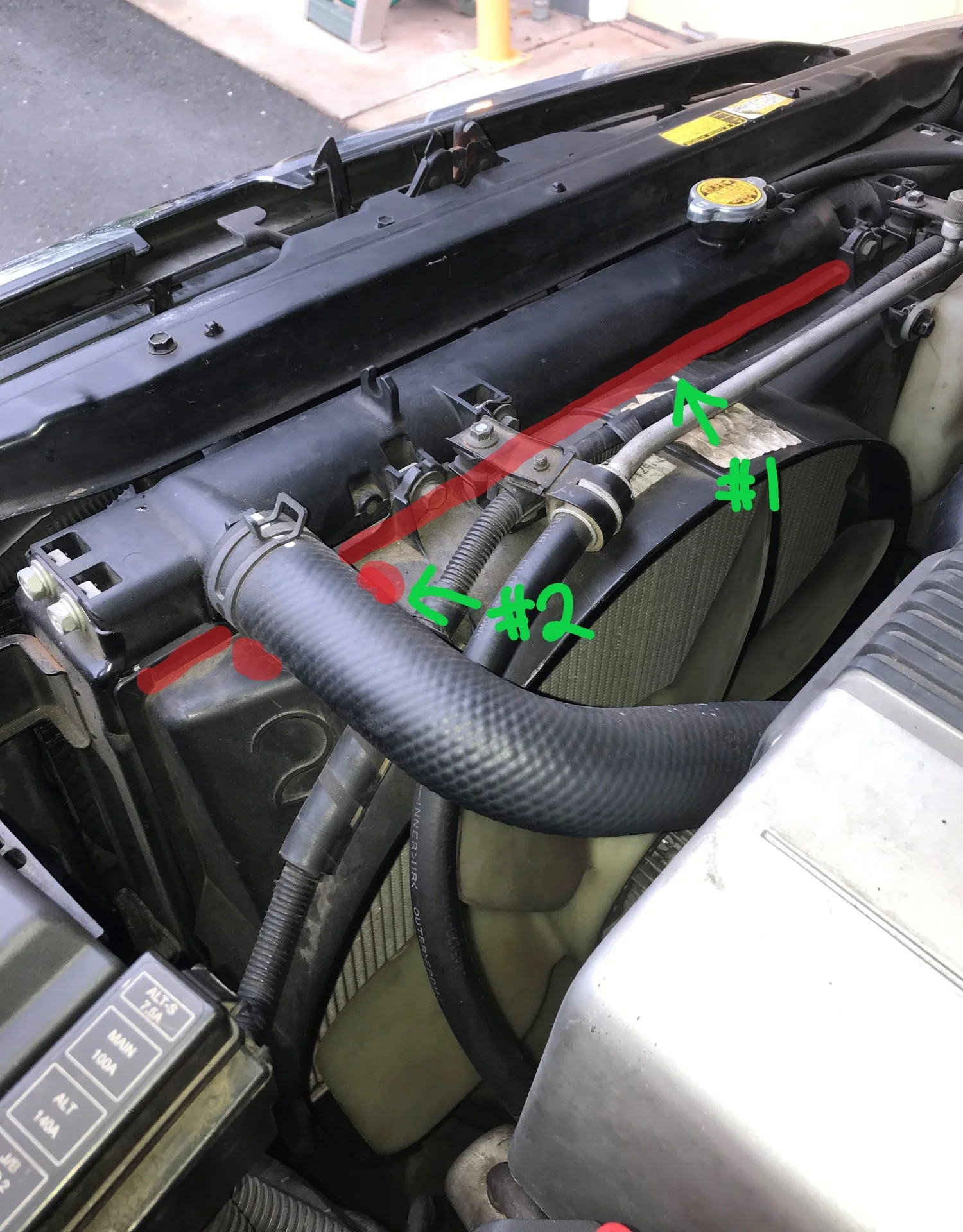

I also took some pictures to show in which locations I originally found the leaks on my radiator. Along the line marked with #1 I found a line of coolant. At the spot marked with #2 under the upper coolant hose I found a small puddle (size of a half dollar coin).

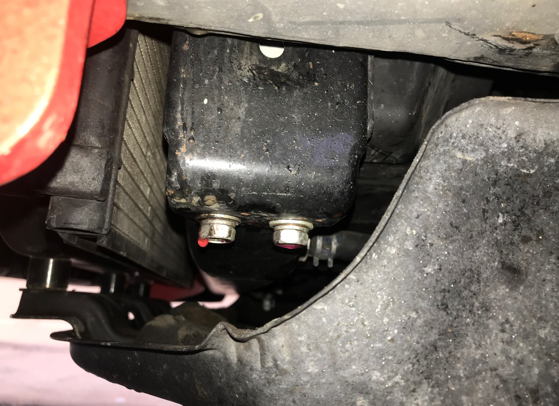

Looking from underneath there were some drips from the lower mounting bolts which I believe ran down from the top.
Looking closer at the top I do see some staining near the filler neck, but I am not sure if that is from this leak occurrence or a prolonged minor leak that has been ongoing.

OEM is best. I bought a Denso because it was in stock at my local Napa, whereas Toyota dealer couldn’t get an OEM for a week (possibly longer). I just didn’t want the downtime, but had that been a luxury at the moment, I would’ve gotten OEM.

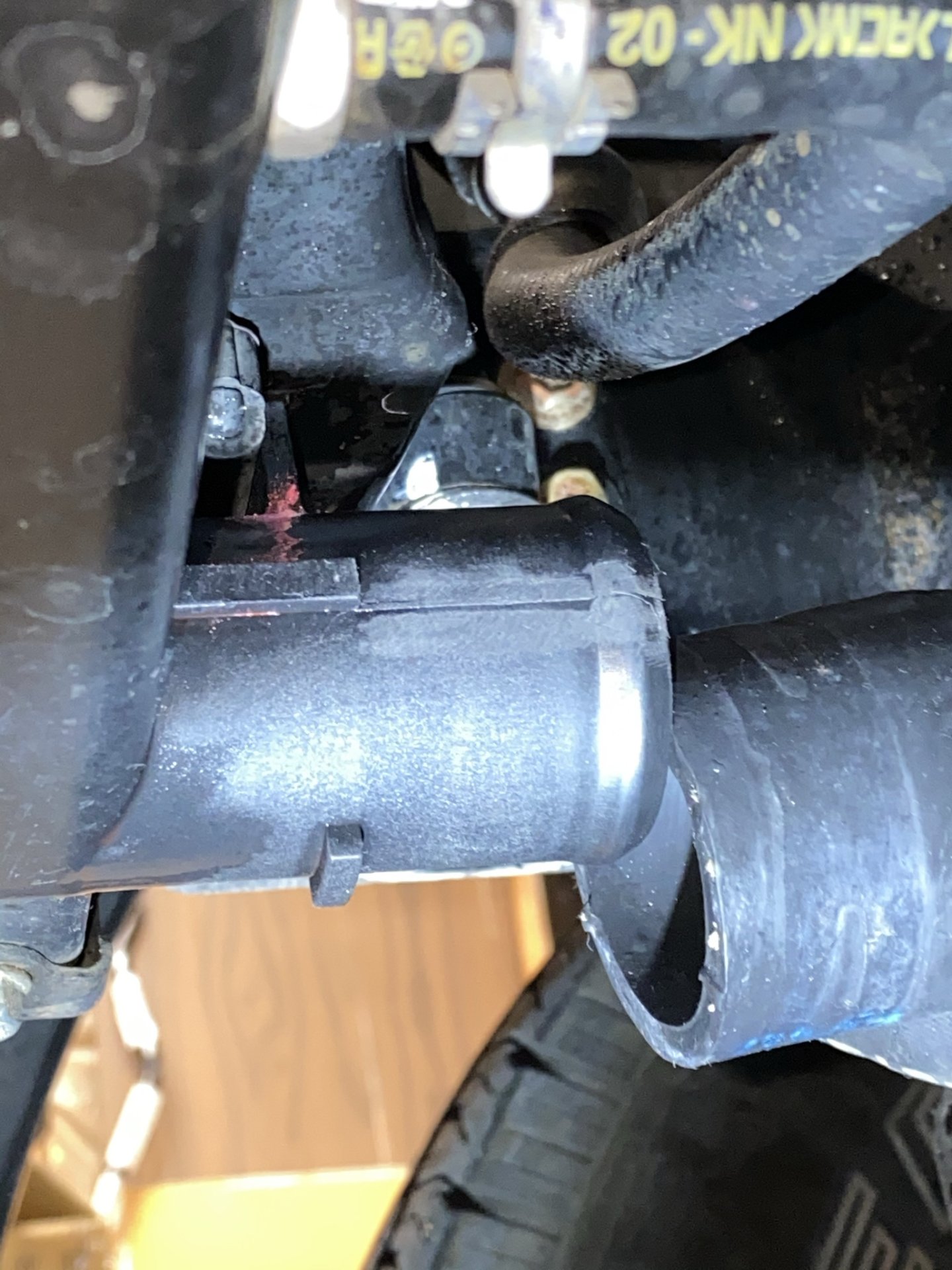

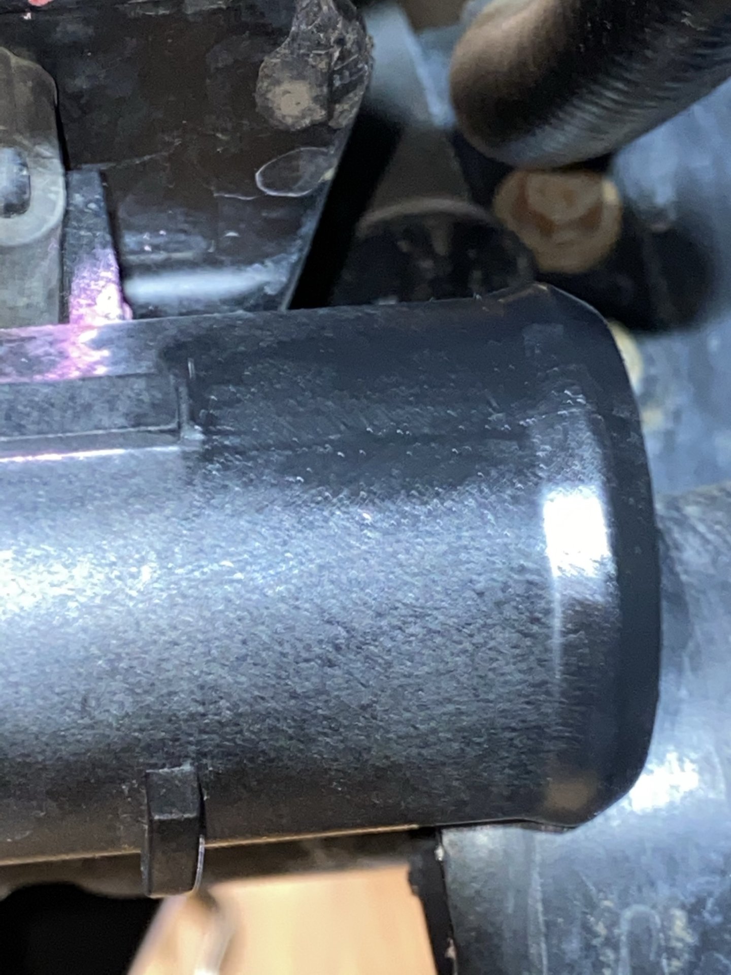

If you using KOYO or CSF. They tend to weep at lower goose neck. I've found, by filling casting groove with FIPG 1282B (any coolant rated FIPG, should do), weep can be mitigated. I let FIPG dry overnight before attaching lower hose.
CSF Rad & new OEM lower hose 1 year after install.
Filed off raised casting keeping shape as round as possible.
Filled in casting groove, using raise blade to form & smooth, then curing overnight.
99.9 % sealed, 1 year later.
