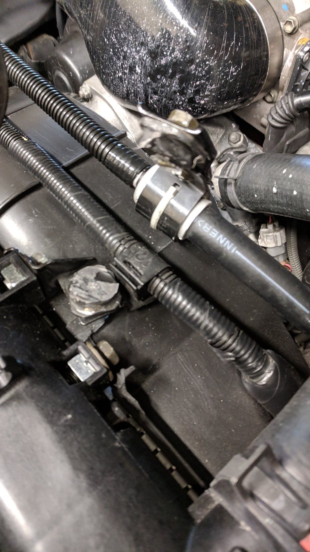

Awesome thread thanks all. Replaced my radiator today. The first photo shows the clamp and bracket for holding the A/C discharge tube and wire above the radiator. The PO managed to break both of these assemblies at the rubber grommet/dampener. Any way to repair or an easy DIY for wire/tube management. I scoured the inter webs for a while and didn't find much.

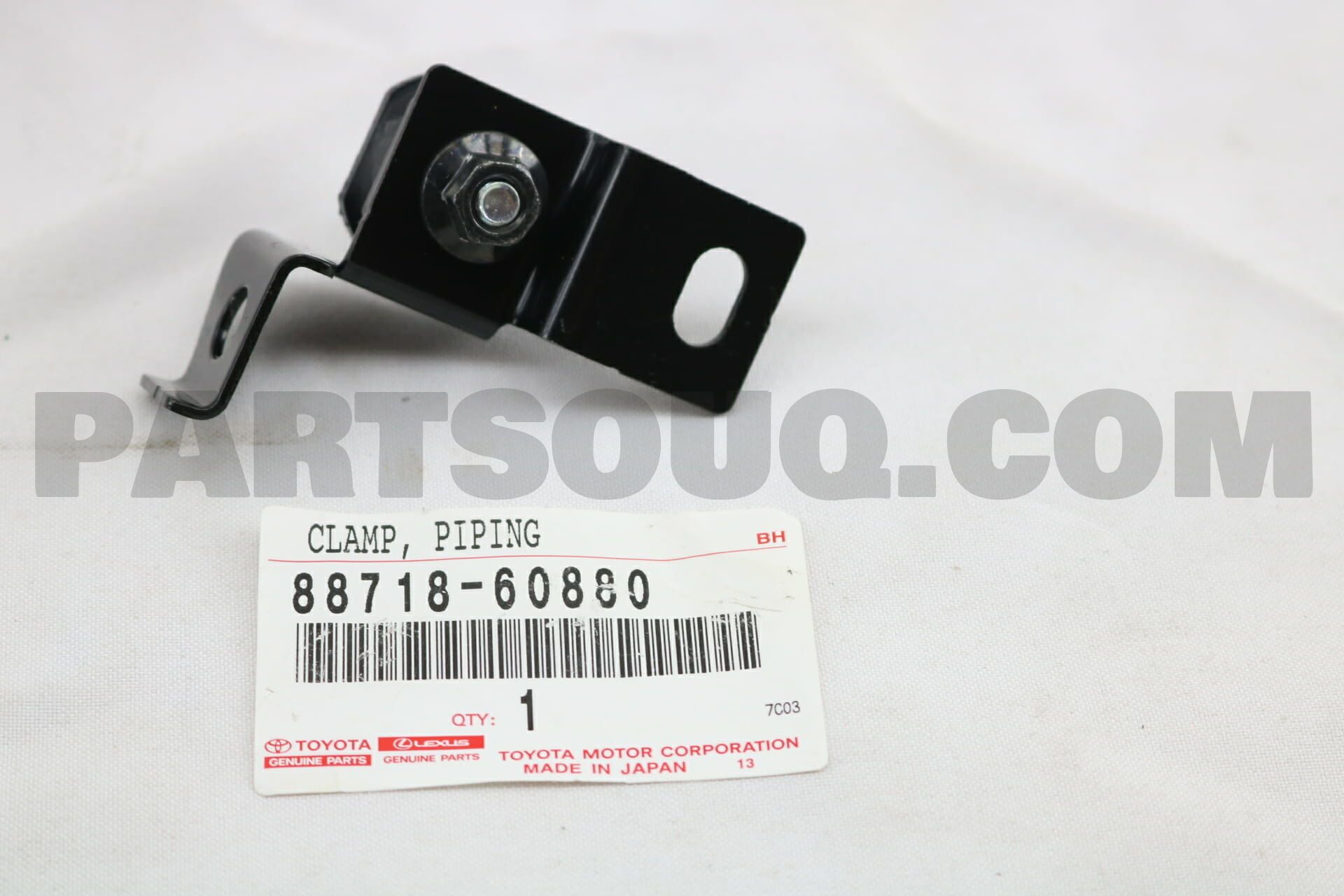

@RockyLC , these things? they are the same part # left and right, both mine were broke. 8871860880
now that I'm doing the 3rd radiator (see the pink?) swap out because I keep getting ones with cracks it's really getting on my nerves having these broken stand offs. I tried all things to glue them together, jb weld didn't work either. Any better fix than 40$ for both?
Hi. I purchased part #88718-60880 and it is not the correct part #.
Do you know the part number(s) for the two clamps in the picture? Thanks!

Did your clamp break or just the rubber?
Also the part number you asked for is posted like three posts ago but if for some reason you don't think it works just call Toyota parts with your VIN or punch your vin in on any of the online parts places and you can figure it out.

88718-60880 x 2 - Already had this but ordered the missing parts below. Thanks for the prompt responses.
90080-11228 x 2
88718-6A400 x 2
88688-6A080 x 1
88688-6A090 x 1
90179-06274 x 2

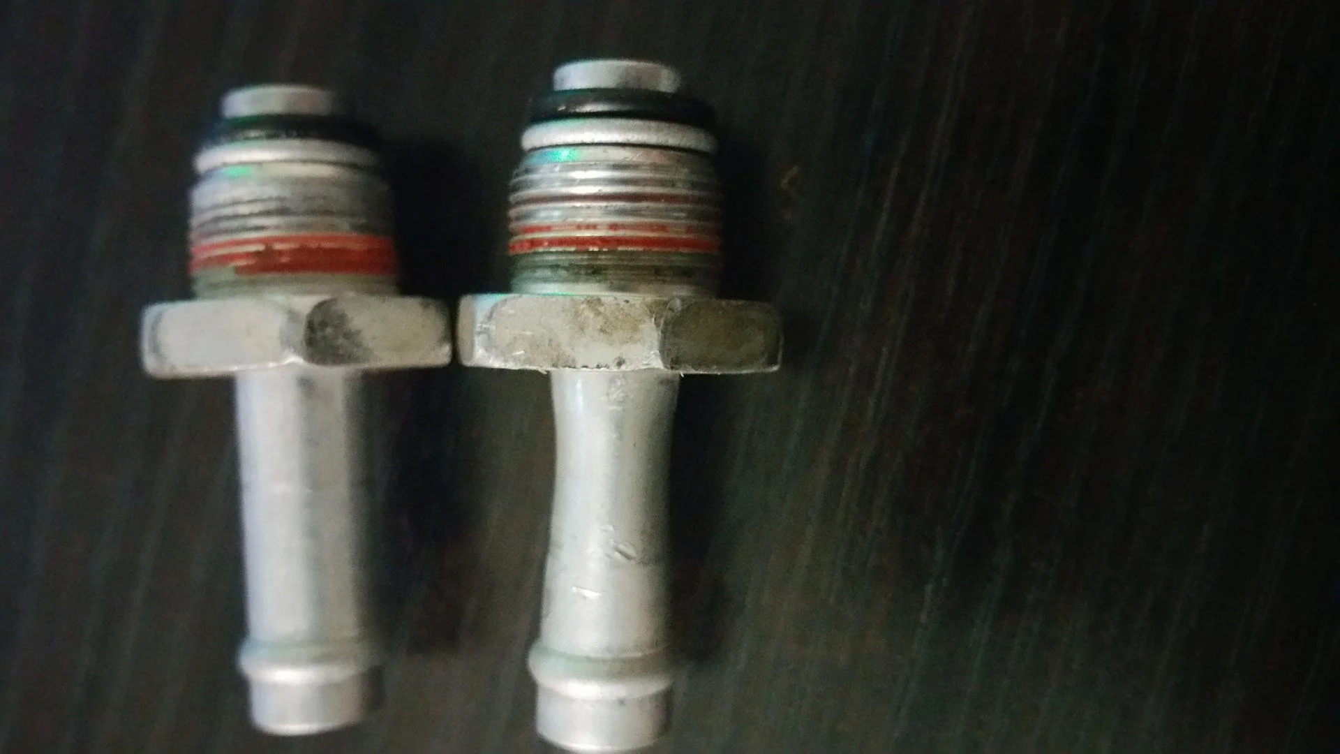

Super old post, but what are the odds you still have these laying around? Unfortunately a new radiator I bought arrived with a damaged fitting. Happy to cover shipping and $20 for a burger and a beer if you (or anyone else) has one they could part with. Thanks!

I have an old radiator that I swapped out last year (leaned up against the side of my garage, ha) that has those fittings, I can check for you tonight if you'd like. Feel free to PM me.

I have a just-replaced OEM rad that I’m about to toss. Fittings look good. LMK if I can help, trash goes out Thursday AM.

Hey, thanks! If the fittings look good I will take them! PM incoming...
Thanks a ton! Sounds like Jack above has me covered but maybe I could talk you into pulling the fittings out before tossing the radiator, if not for my use, at least to keep as spares? Can't believe Toyota doesn't sell the fittings themselves since it's such a small part that could grenade a radiator if it is bent or fails. I'll PM you if the fittings that Jack mentioned don't work out.
Huge thanks again to both of you guys, this forum is a really incredible resource thanks to guys like you. :cheers:
