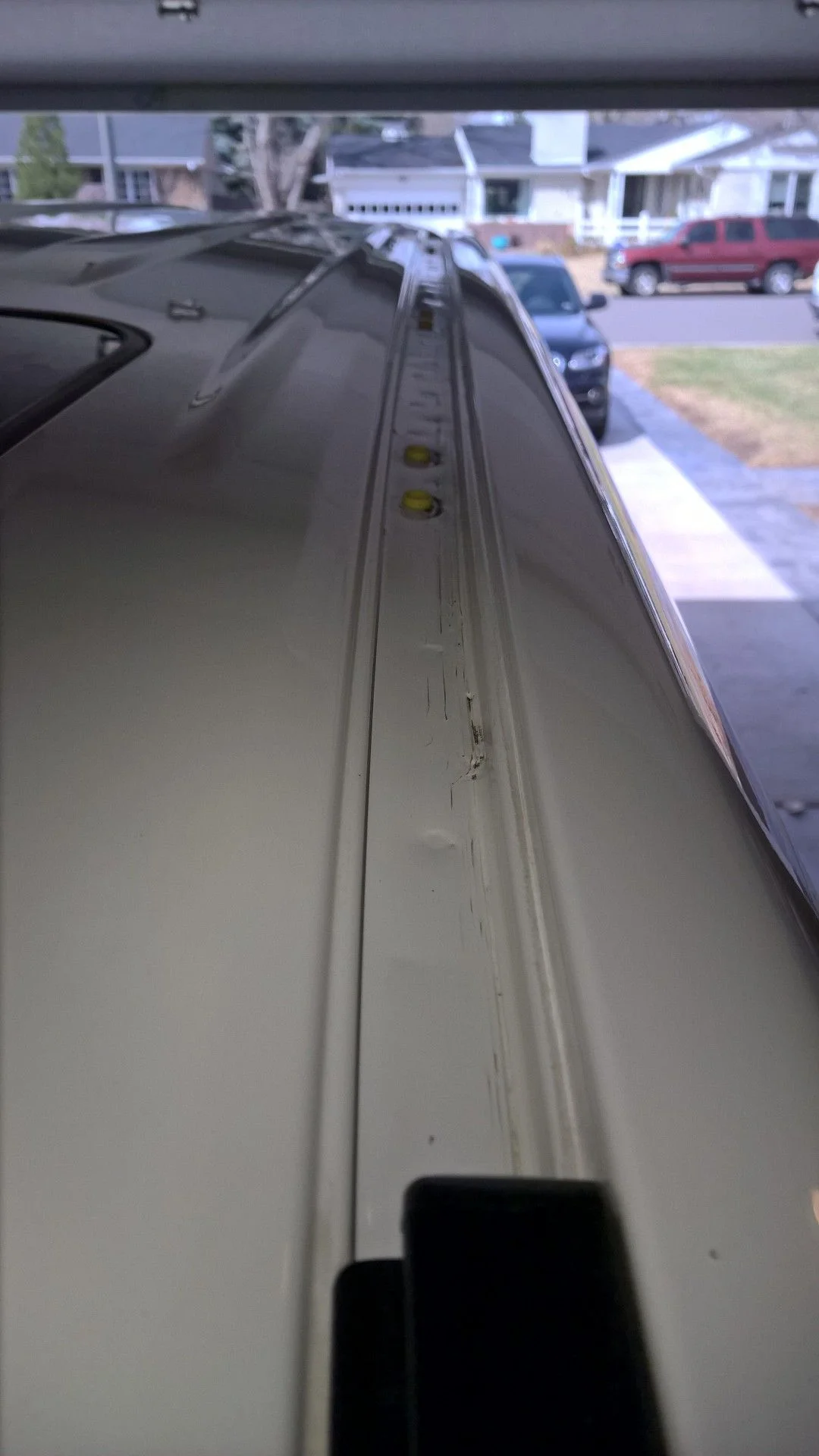

Question for everyone: I know the channels aren't parallel, but does anyone happen to know if the channels are straight, or curved?
I've been noodling a DIY design that would have a continuous mounting rail on each side. Pretty easy if they are straight, more work if they are curved. They look pretty straight, but I can't really tell for sure without removing the factory rack.
Slight curve to the channel, refer to pic.
