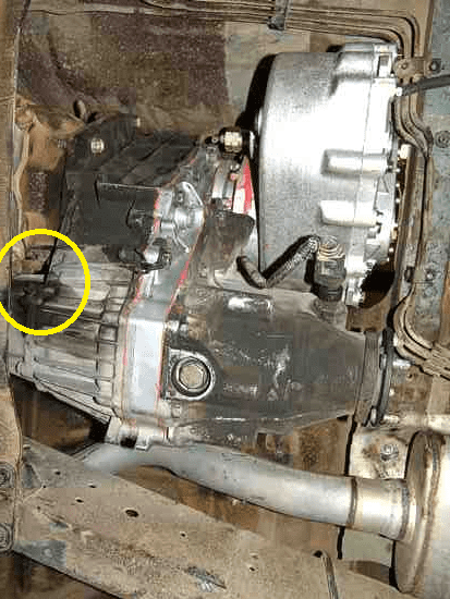

Quick fix of transfer case leak
I've not seen this T-case before. Is this like what is on the USA 80 series?
I don't see the hole you asking about. Any better picture?
Perhaps you can edit and circle the hole.
Hi 2001LC So I think ive identified the problem. Your photos and comments were a great help and now that Ive got a better idea of things ive been able to reread them and realise that the adapter box is dry and that the hole must therefore be acting as a weep hole for any oil that gets in there. The fact that the oil is gear oil indicates that the oil seal where the TC mates with the adapter box must have gone. Its a bad leak. I dont think AT 205 will help! It probably went whilst I was fiddling around replacing the rear output shaft.

Okay. Sorry I can't be of much help here. I see your line but not the hole. In the picture I'd say the upper dark area, is leak that @JunkCrzr89 referenced above.
The lower dark area where I think your line is pointing I've not a clue. This is not the T-case on USA 100 series. I work on 100 and 200 series only. If this is same as in the 80 series. I suggest you go to the 80 section of mud. They'll be much more help for you, than I can be.

Yep. That would be the hole!
