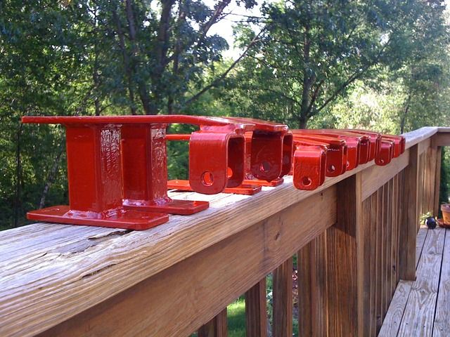

Brackets are ready. Will start shipping shortly
Finally a sunny day.
Here are some pictures of the current batch sun tanning:
The deck does not have an engine or wheels. Nor does it go Brrrrrrr. Hence low priority.
Thanks Rick, I kept my hands out of the picture so you won't examine my finger nails. LOL.
