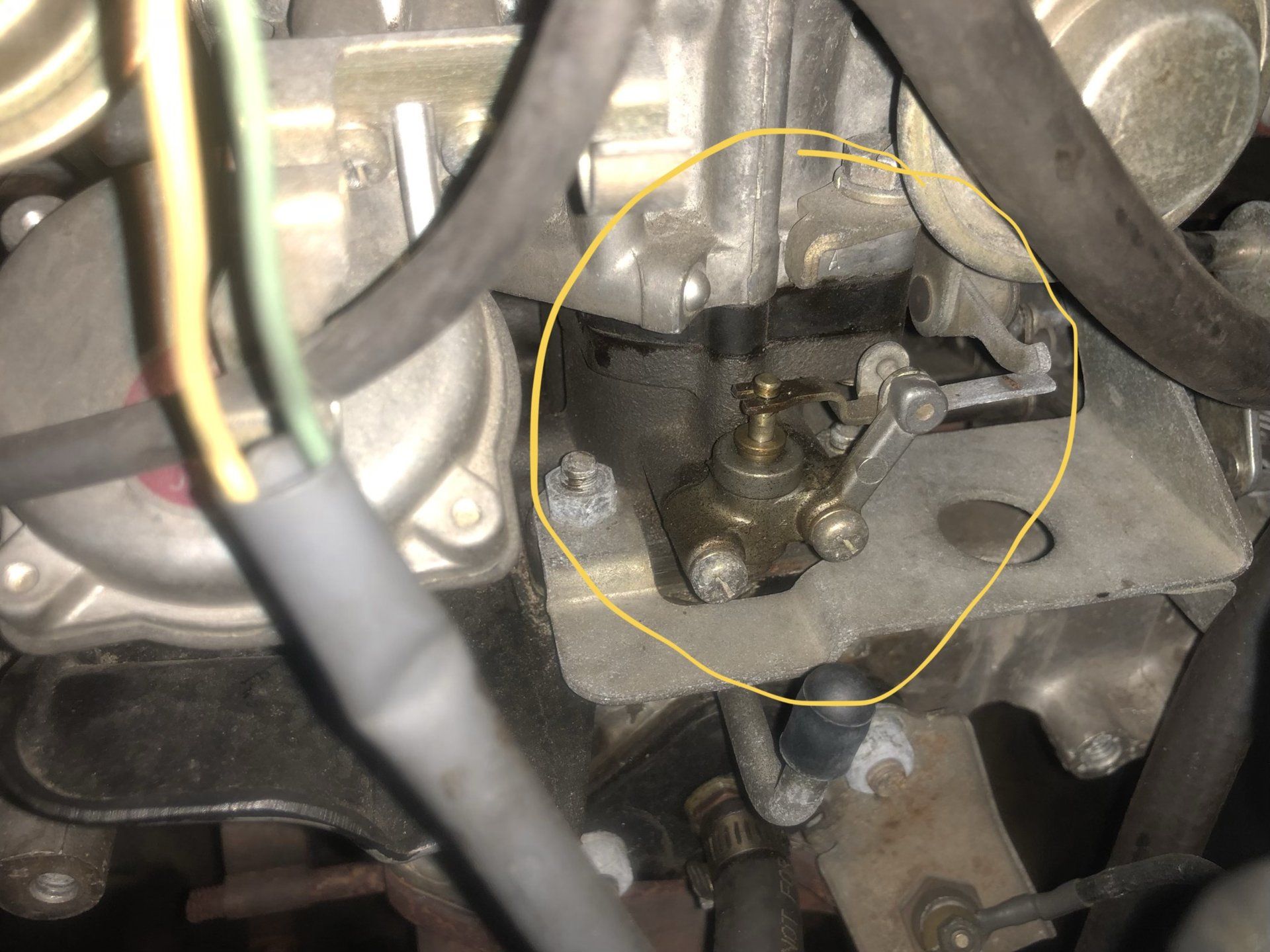

Looking at a rebuild on carb, want to run truck while that’s being done, and have a back up. Looking at the CityRacer non US OEM and other aftermarket. For. Desmogged application. The others don’t have the Slow Idle cut off. Is it internally or is this something I don’t need in desmogged application? Seem to not be present in non US OEM.
I have seen some other desmogged 60’s without this.
Item circled in picture. Thanks for the help.
Not needed if desmogged. I just swapped over to a City Racer. You’ll prefer it over the Aisin carb.
Reason for rebuild is st idle there is a stumble and rpm drop every 10 seconds or so, like some extra fuel was dropped. And when AC idle up is on, sometimes at idle, drop in rpm and idle rich until throttle applied again. Figure it’s a carb issue, clean fuel filter. Might try red neck tune up.
That's the secondary slow cut valve. It was added to USA 2F carbs to ensure that fuel is not dribbled out of the secondary idle port if the secondary throttle is not fully closed. Like many things, it is not needed, but is nice to have.
Jump into the rebuild. I just did my first carb rebuild and my 60 was out of service for one day. Source a good rebuild kit, have a FSM handy, and pinhead’s YouTube videos. $80 total and it runs great.
Your secondary slow cut valve is also missing it’s rubber boot. I don’t think those come in the rebuild kit unfortunately though.

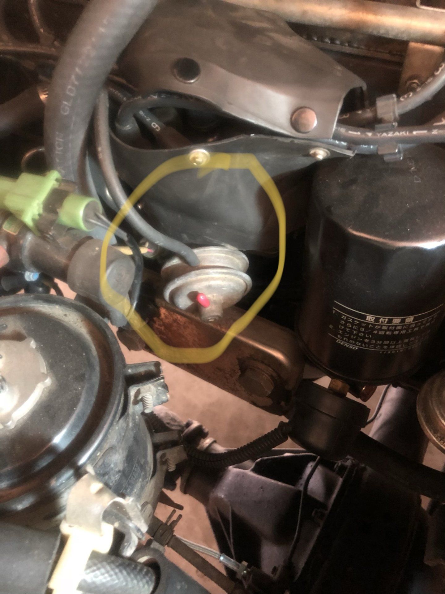

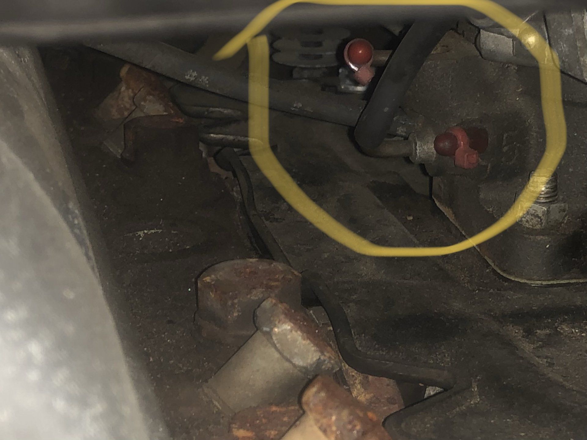

Ok, so as I run vacuum checks around the truck. I am at 18 with BB dead on pin, and 19 with it advanced a little. But I am getting no vacuum to my dist advance or choke break (like a pound or two). Since this is where the ac idle up interacts with carb I am thinking my issue is down there. The vac to dist and choke is coming from my rear vac ports pictured. BTW, I think my vac advance on dist is no good also, not holding vac.
Vac pots are pretty much all bunk at this point of their age.
Choke breaker and openers can be rebuilt by a company in TX, Rebuilders Speciaties something or other, I can get you a contact number, just tag me if yes. Vac adv are not able to as of this time. I did send them one unmolested and one completely dissembled. I’ve not heard if they think they can rebuild them or not, figured it was worth a shot. I’ll text the guy and ask again if he’s had time to look them over.
