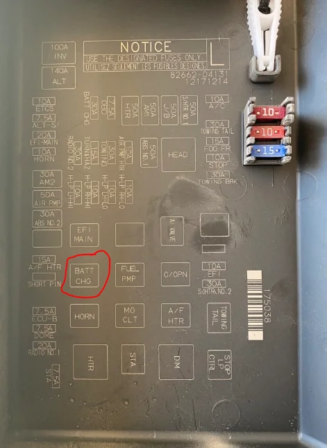

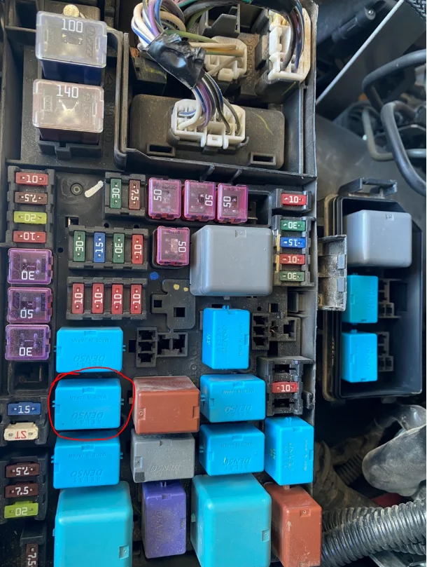

I need an ignition source for a relay I am going to use for my secondary charging system. My Tacoma uses fuse relays I am not familiar with how they work (exactly, but i do understand the concept). Based on the Toyota diagram I know my INV and BATT/CHG fuses work on ignition. Anyone tapped into these before? If so what should I use to do tap into it?
If all your using it for is the signal side of the relay, then I would probably come off a fuse with a fuse tap. I would most likely come off the ALT-S fuse that way it only triggers the new relay when the engine is running, effectively mimicking how the oem charging system works. I have said all this without looking at the EWD for your rig though:)

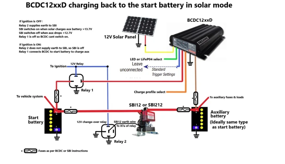

To answer your question, Yes. Dual battery with a charger. I’m just looking for switched power so once the ignition is on it will switch the connection between solar and the two batteries to alternator. I am going to just start testing this coming weekend, until I find one. According to what I have found the Batt/Chg is switched with the ignition. I am just not sure the best way to come off of the denso relay/fuse. If some one has done it, I’d like to know how. If not, no biggie, there is likely another that will work with a simple add a fuse. I attached the diagram.
The RedArc doesn't run @Batt voltage anyway. Recommend a dash switch carrying alt voltage (small current) to the BCDC kick-on wire or to the relay in your diagram and just turn it on whenever you want when the truck is running.
