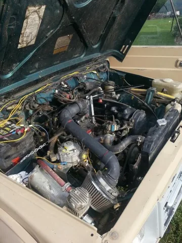

So I talked to him a little this afternoon and he seems like a nice enough guy. He said the conversion was done using forklift components. He works for a mining company and it sounds like he probably had some experience with the forklifts where he worked. Is there anything that I should look at or specific questions that I should ask about the conversion?
I don't know Samis very well, but on Toyota stuff all you add is the fuel regulator and a new carburator. Pretty simple. Run one wire to the solenoid. Run your water lines to the regulator.
My guess is that they are going to be very similar. I will have him send me some pictures from under the hood.
I see the regulator in the lower left of this picture. I will look for the coolant lines.

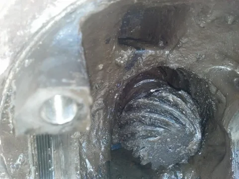

Well we get to Murfreesboro, 20 miles from home and right as I pull away from a light I get a POP, GRIND, I am not happy with you, kind of noise from the rear. Limp it into the Walgreens on the corner with some chirping and grinding as we go.
Erin took her mom and Hannah on to the house and I stay to assess the damage. I was hoping to pull the rear shaft and limp it home. Erin got back with my tools but while she was gone I crawled under to find that it appears that both pinion bearings have taken a dump and the pinion will now move almost an inch in and out of the housing and the pinion itself will touch the housing on all 4 sides....:bang::bang: When she got back I went ahead and pulled the shaft and tried to move it in FWD, no dice. It will roll backwards, but as soon as you start forwards the rearend binds and locks it up.

Well there's your problem.....
Apparently those inner bearings are important after all! And it is apparent that routine maintenance was not on this guys radar, notice the nice coating of "swamp lube" on the housing.

Sounds to me like the guy had never gotten the gears broken in fully. Gears don't need a break in period for wheeling, but it is critical to do it right if ever driven on the street. The noise you described sounds to me like the gears destroyed themselves due to overheating. Of course that could also be the same result from having a milkshake as gearlube.
On another note, you shoulda mentioned that it had SX's on it and I woulda told you not to try driving it on the highway at all anyway. Sounds like they did okay, but that's unusual for those on the street. And you probably took about 15% of their tread off on that drive. Jus' sayin, bias ply tires are "streetable", but not exactly "street friendly".
