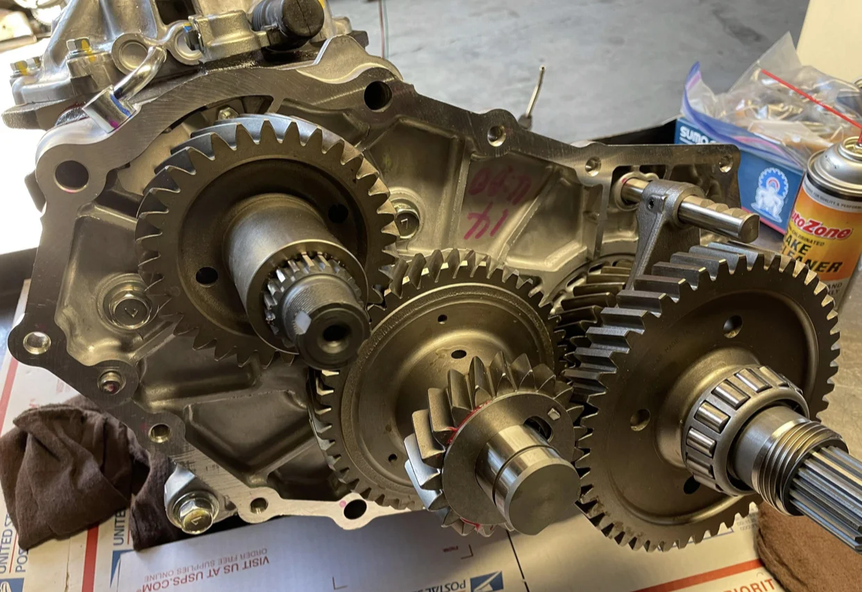

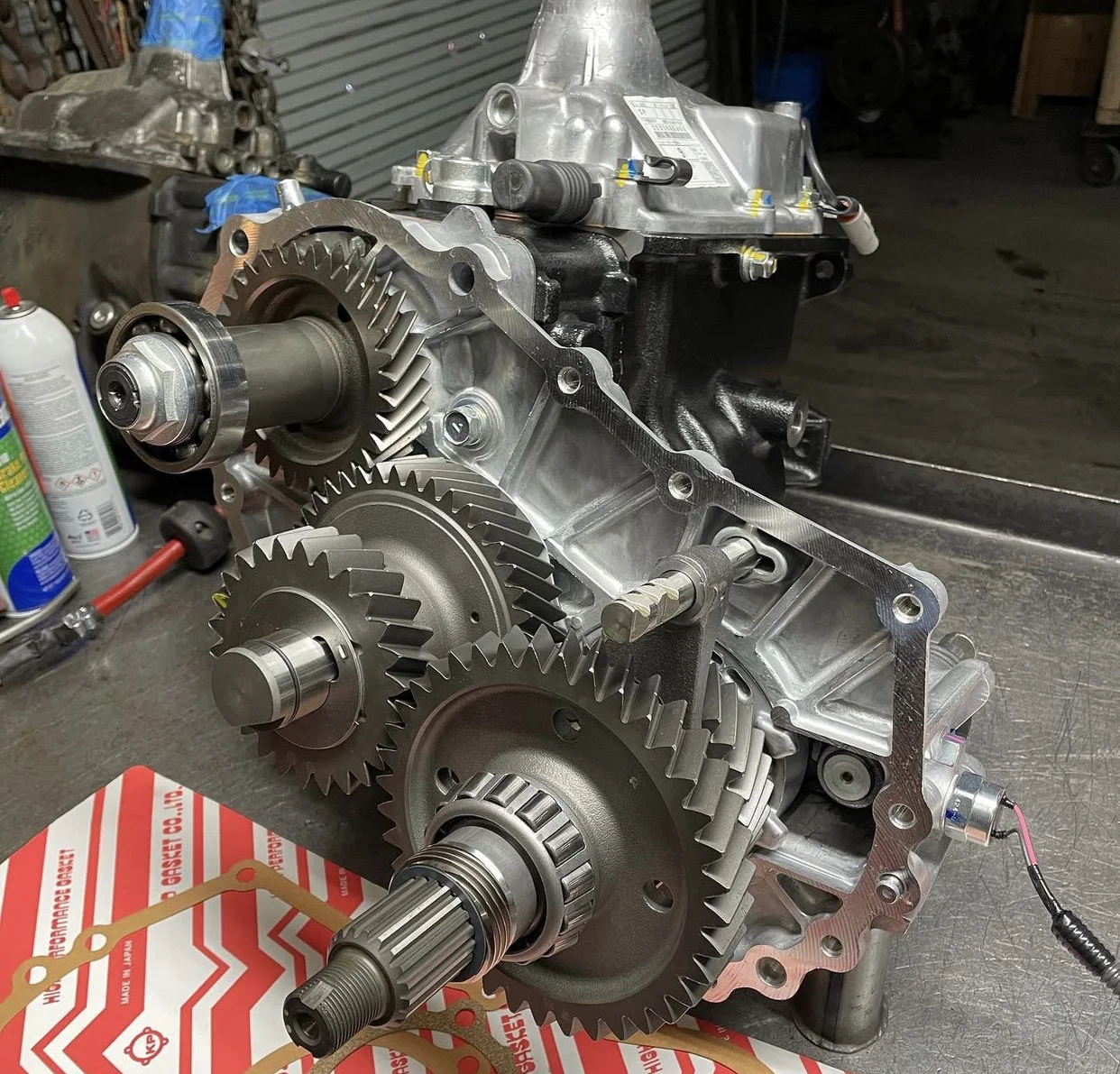

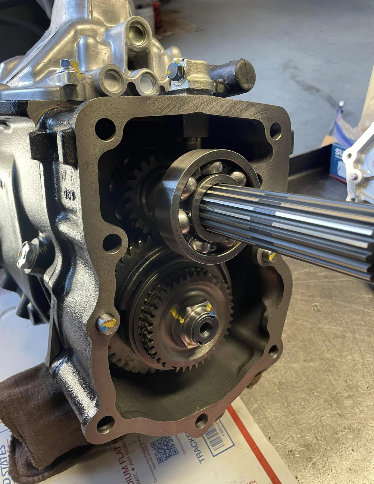

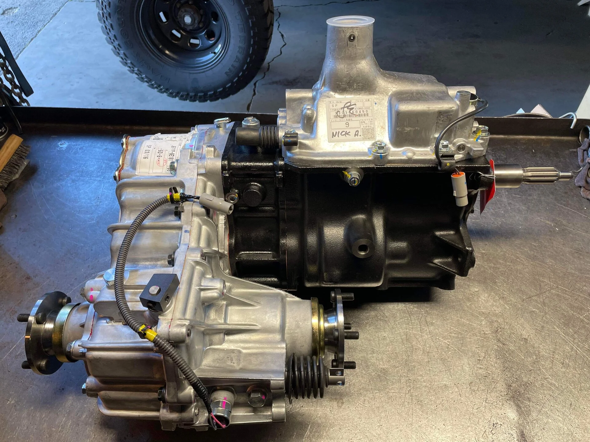

Enter the H55... Huge shout out to Valley Hybrids on this one!!! They were a pleasure to deal with!

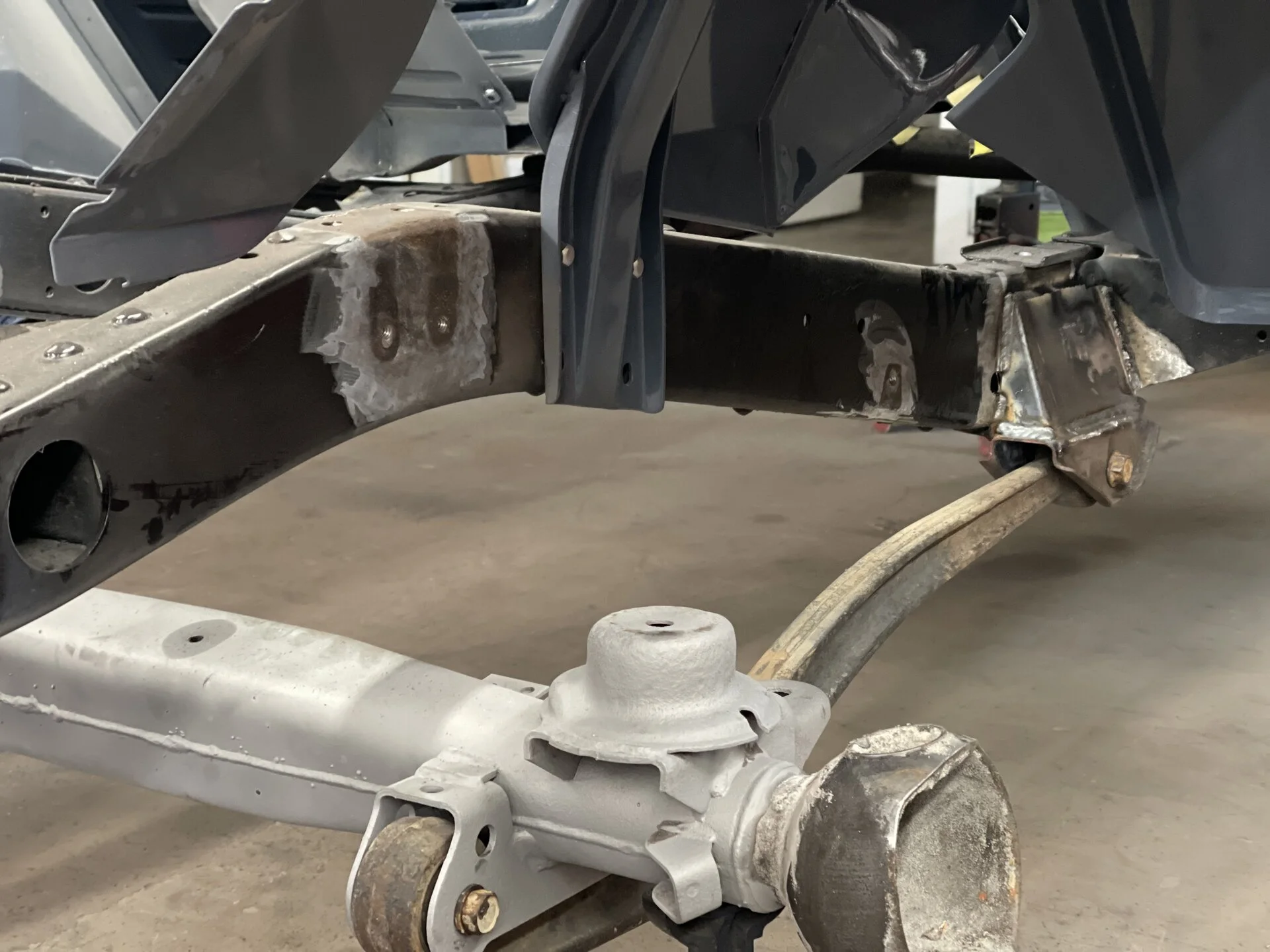

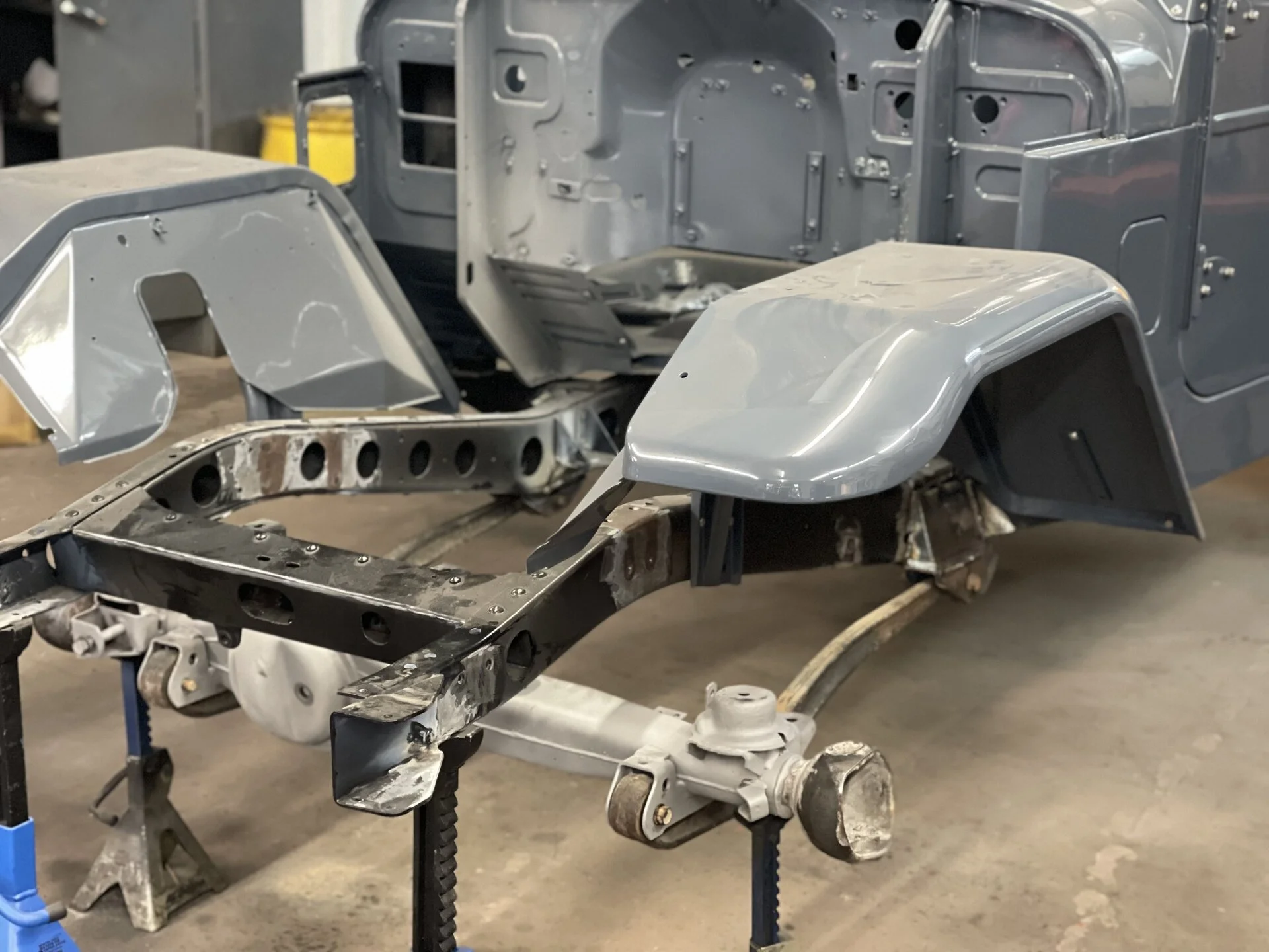

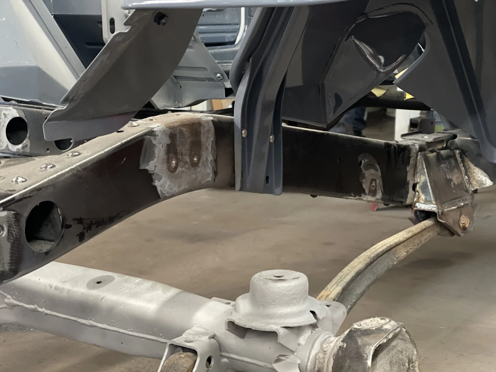

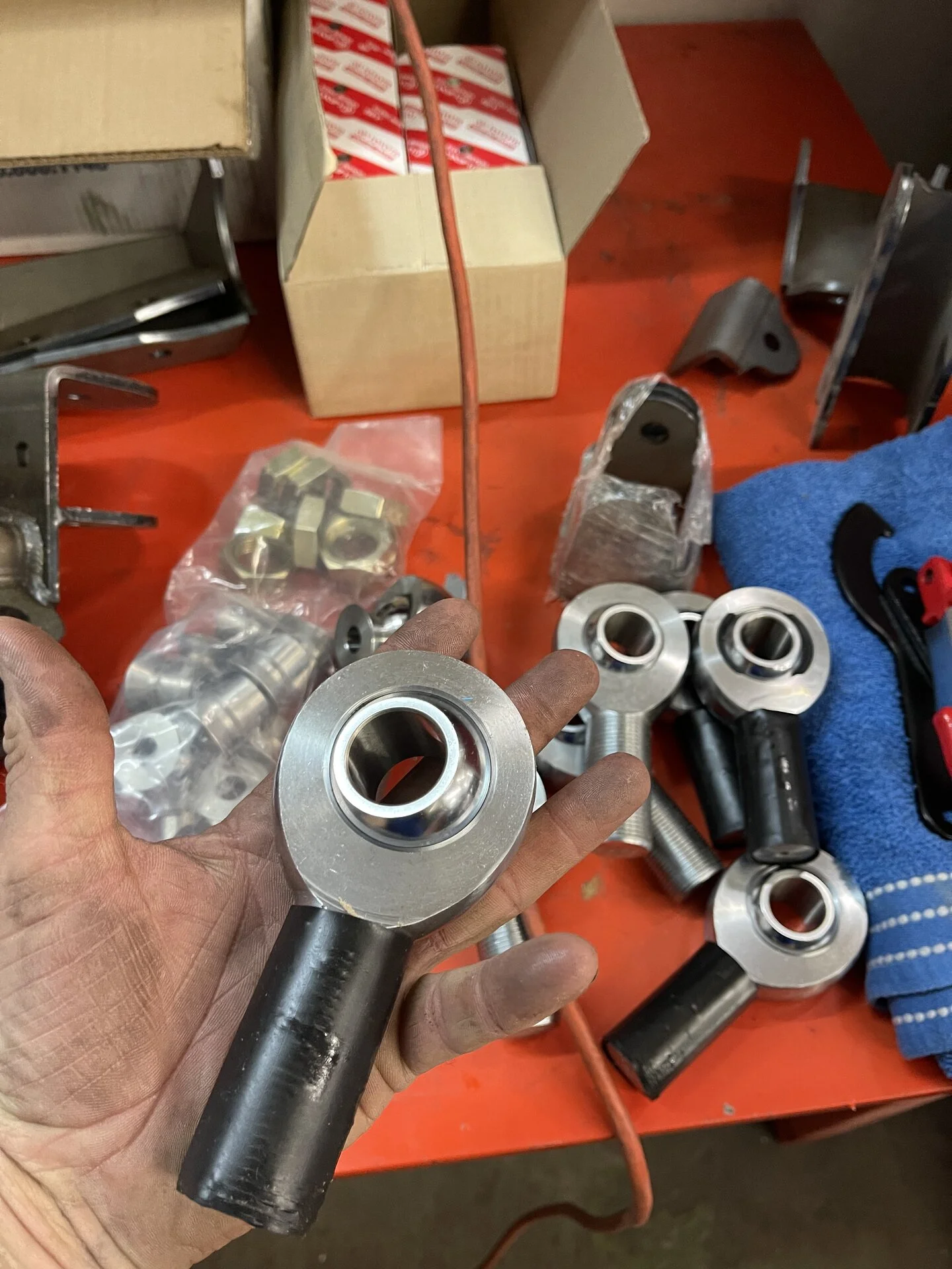

Mock up if the 80series front axle. We will be using the correct delta radius arm once ride height is set and caster is measured. Rear is a triangulated 4 link

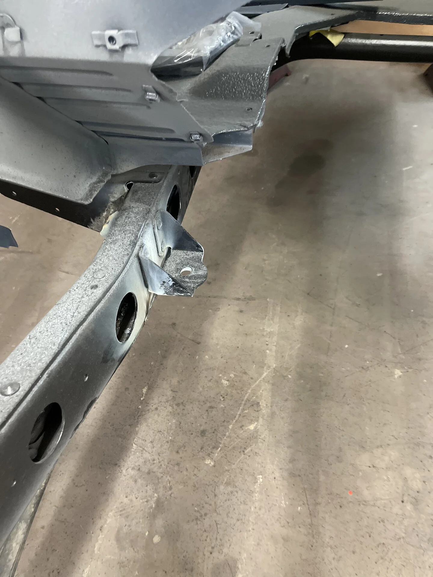

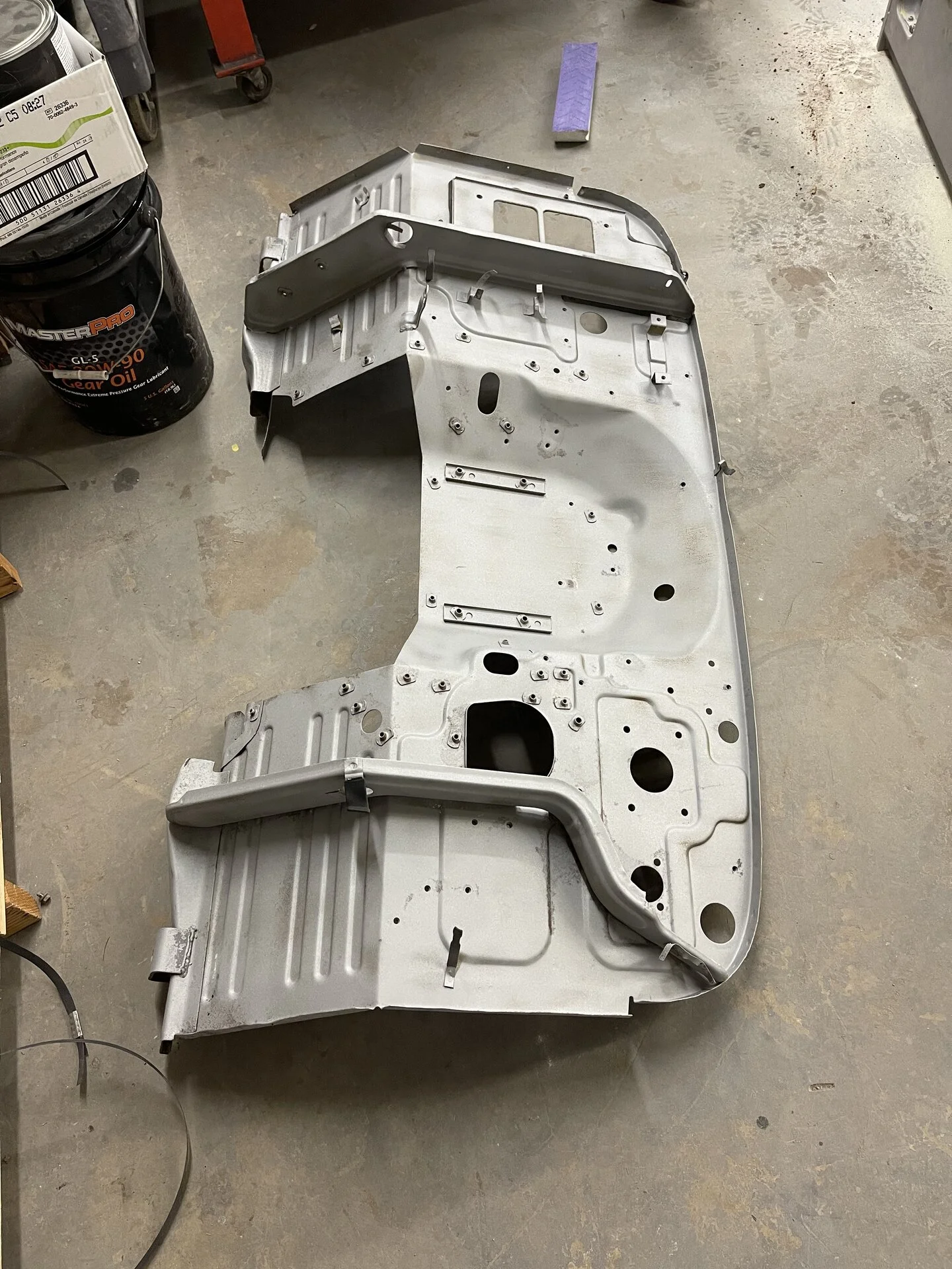

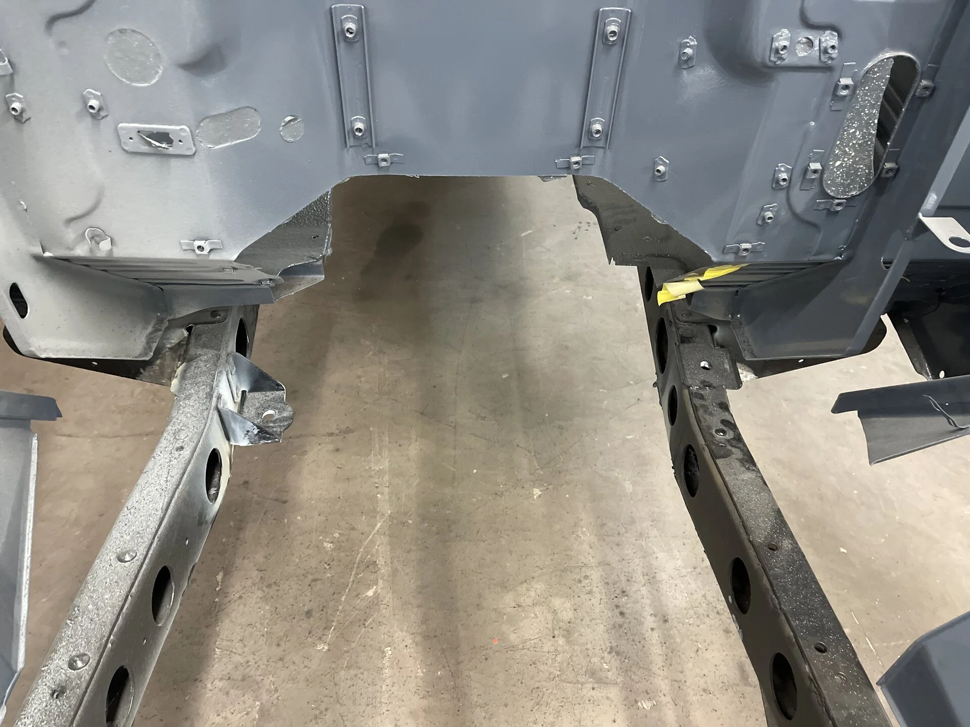

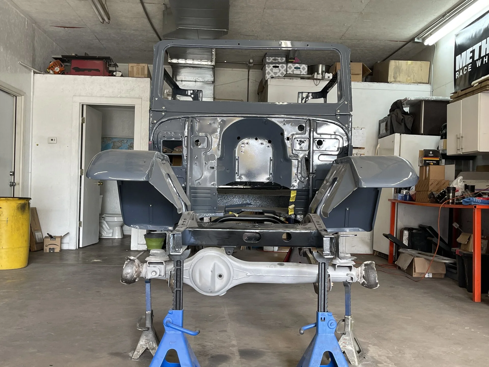

with needing room for the 1fz and also able to upgrade to much nicer brakes we opted to change firewall to later design. Finally got it back from sand blaster today so we can get going with the swap
So.... what changes were made in later model firewalls that allow for a better swap?
Brake master cylinder sets, father toward , driver-side it also allows for the use of a bigger brake booster. If you notice the early model, the brace ran straight up and down the later model bends the brace way over towards the driver side.
