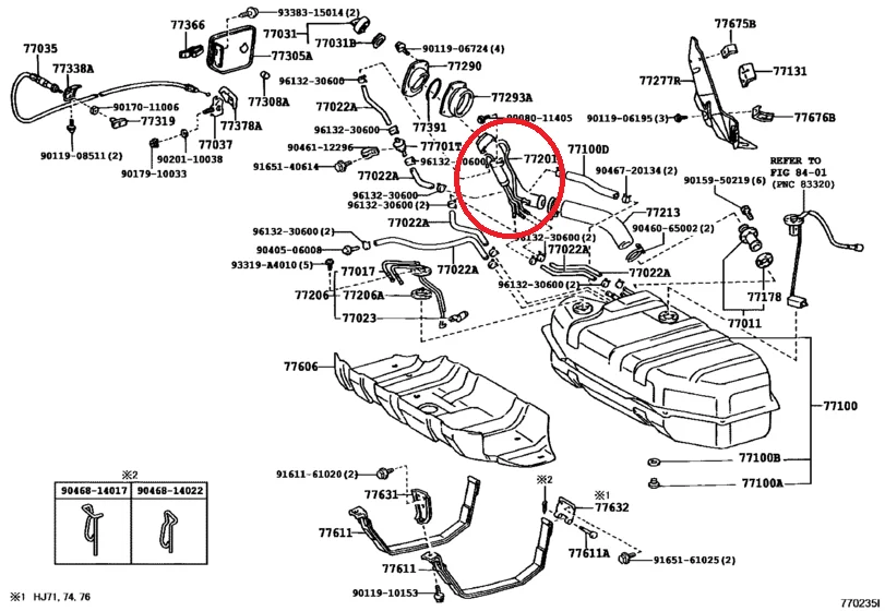

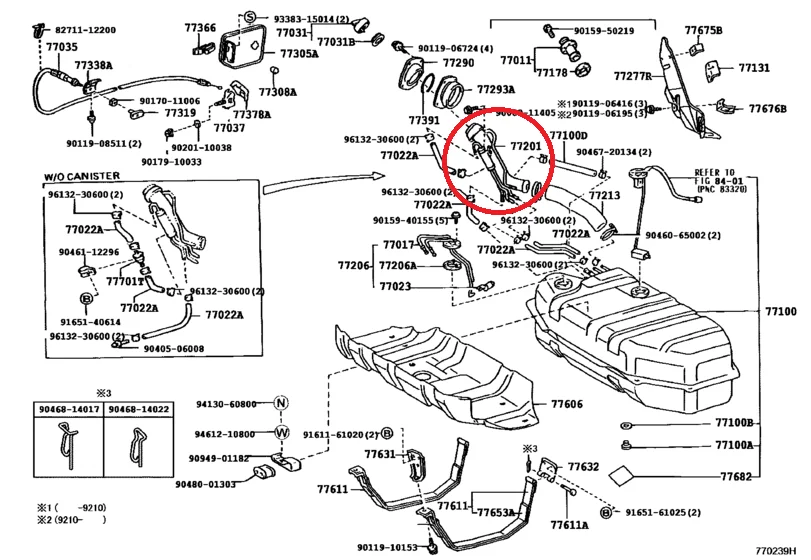

Hi,
I'm in the process of dismantling/restoring/replacing the fuel tank, filler neck and various fuel related components on my 1991 PZJ77. I think I might have to replace the filler neck but that part is no longer available (77201-60360). There is also a very similar part for later models of the same truck (77201-60361) but it too is NLA.
I notice that 77201-60200 for the PZJ73/70, HZJ73/70 and LJ73/70 is still available. Does anyone know if it is compatible with the 77? Schematics show them as being very similar but there must be some difference given that they have different part numbers...
73/70
77
Hello,
You could also try a part from a 76 Series truck, namely from an HZJ76.
Juan
