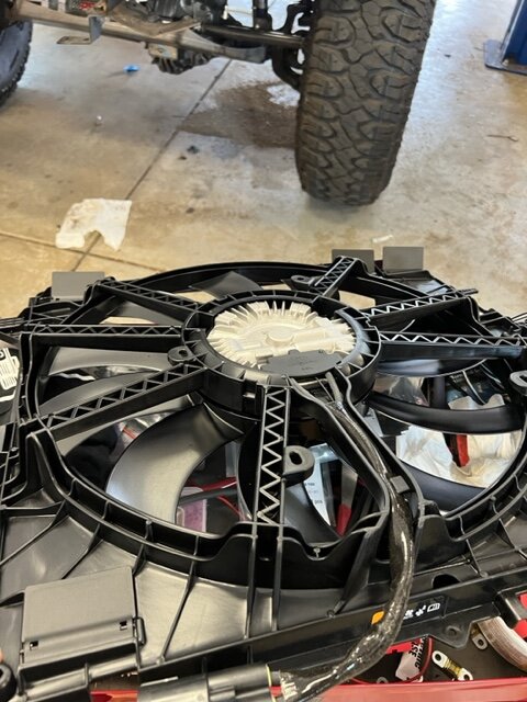

I'm posting this here because I think it deserves to be separate from my build thread, but the full story visit my M37 build thread in Hardcore Corner.
So, this time I'm trying to do it smart. I was over on the Holley forum and got some info on PWM fans and I'm running with it. They recommend using the 6th gen Camaro fan. It's an 850 watt fan - so it moves A LOT of air. The nice thing is they start slow and speed up as the computer directs them so they are only loud when they need to be. The Terminator is capable of generating the PWM output, but there are people out there (Vintage - yes the AC people) who make a thing that makes it work standalone. The nice thing is that the fan is centered in it's shroud and it's shroud is pretty generic, so unlike all the European ones I've seen, it should be easier to mount. It's 18.5 to 19" wide and is a great fit for an fj40 (or power wagon) sized radiator
So, first step is too bench test it. I bought a cheap pulse generator off of eBay and hooked it up to a spare battery, and amazingly it worked right out of the box. At 100 hertz, it starts at 80% duty cycle, and ramps up as the duty cycle moves towards zero, I didn't get it past 20%. Interstingly, it didn't turn off until 90%. so the on and off aren't the same point, but that shouldn't be a problem.
With this working, next is to get it hooked up to the PWM out from the terminator, then attach it to the shroud.
If you type "camaro 6th gen fan watts" into google, the first result is.
"The Gen6 fan is a 19" Brushless Spal fan with 11 curved blades, 850 watt motor, will deliver 4188 CFM at 90% duty cycle, and has a soft start "

These fans are wired straight to a battery (with a 50-70a fuse) and the ECU controls it with a PWM ground signal. There is no separate controller.

I should have the fan mounted to the shroud and hooked up to the terminator in a day or two.

If you are DBW I like to set the x-axis on your control table to TPS (set y-axis to duty cycle) and use the gas pedal to control the fan to dial in the speed/duty cycle. All the fans I have tested have had required slightly different duty cycle to turn on/off and run certain speeds

@texcwa - Yes, it certainly would. This pretty much assumes a modern wiring harness and no ammeter. Since this would only be needed with a V8, a much more capable alternator as well.
