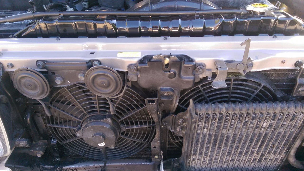

JDM aux fan
"I bought 2 12" fans off Amazon for 100 bucks each don't know the name but they have a 2000 cfm rating I tied them into my rear defogger relay since I don't need that here in Arizona the relay is located in the driver side kick panel"
https://forum.ih8mud.com/attachments/1464826164501-2073075432-jpg.1267990/
