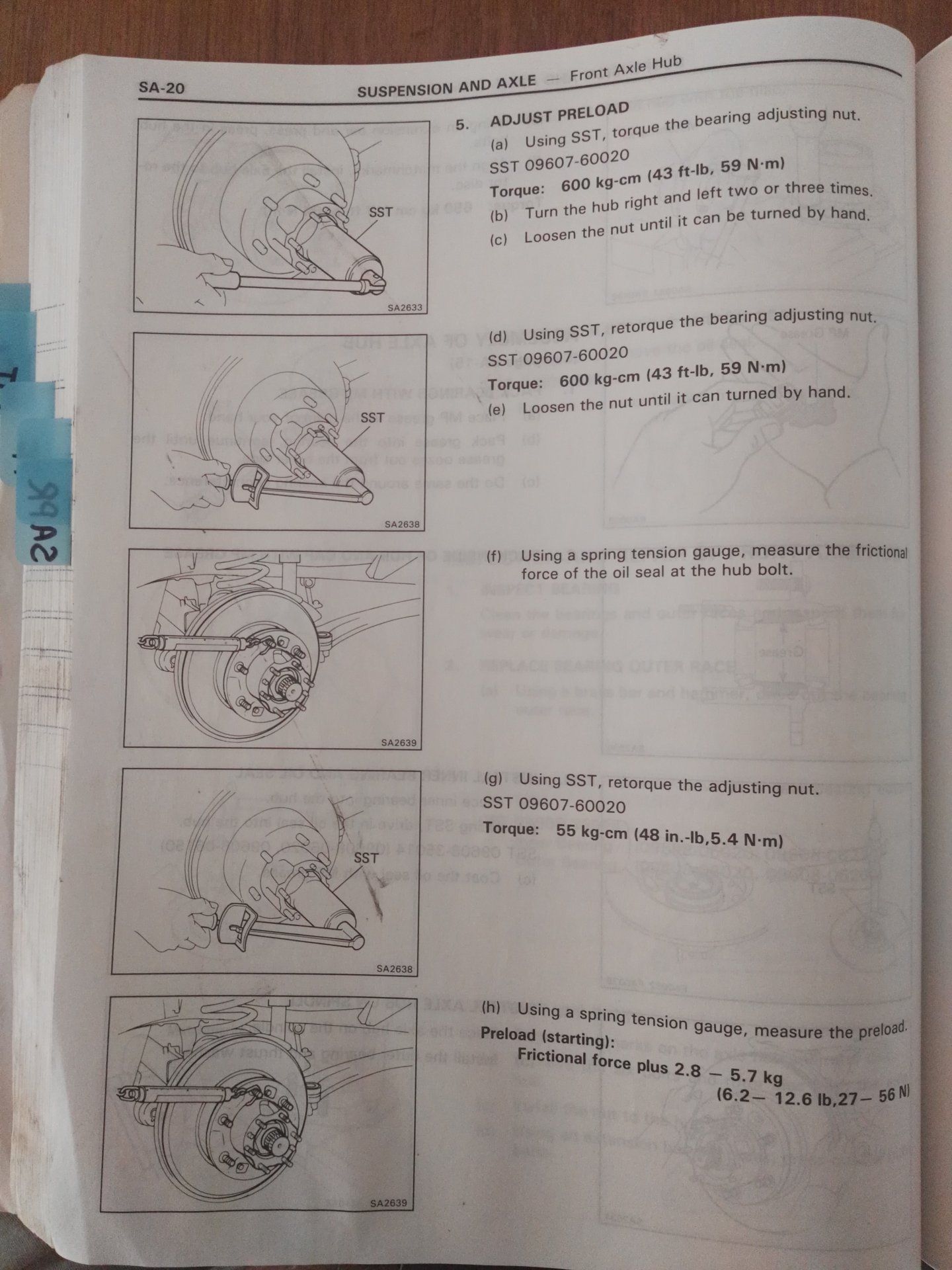

The FSM that you get may differ from the one they give us? Using this method usually results in loose bearings, sooner than later.
5. ADJUST PRELOAD
(a) Using SST, torque the adjusting nut.
SST 09607–60020
Torque: 59 N·m (600 kgf·cm, 43 ft·lbf)
(b) Turn the hub right and left 2 or 3 times.
(c) Using SST, torque the adjusting nut.
SST 09607–60020
(d) Loosen the nut until it can be turned by hand.
(e) Using SST, torque the adjusting nut again.
SST 09607–60020
Torque: 5.4 N·m (55 kgf·cm, 48 in.·lbf)
NOTICE:
Check that the bearing has no play.
(f) Using a spring tension gauge, measure the preload.
Preload (at starting):
28–56 N (2.9–5.7 kgf, 6.4–12.6 lbf)
6. INSTALL LOCK WASHER AND LOCK NUT
(a) Install a new lock washer and lock nut.
(b) Using SST, torque the lock nut.
SST 09607–60020
Torque: 64 N·m (650 kgf·cm, 47 ft·lbf)
(c) Check that axle hub turns smoothly and that the bearing
has no play.
(d) Using a spring tension gauge, check the preload.
If it is not within the specification, adjust it with the adjusting nut
after removing the lock washer and lock nut.
(e) Secure the lock nut by bending one of the lock washer
teeth inward and the other lock washer teeth outward.
@sunrk I didn't notice you're in Australia. If your FSM is actually different, please post a picture, we'd love to see it.
If you're happy with the FSM method, stick with it.
There's many who have followed the FSM, had failures and found more long term reliable alternative methods, myself included.
It's not different.
