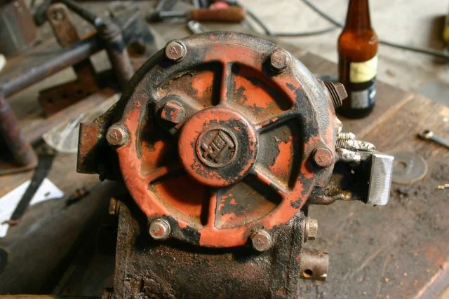

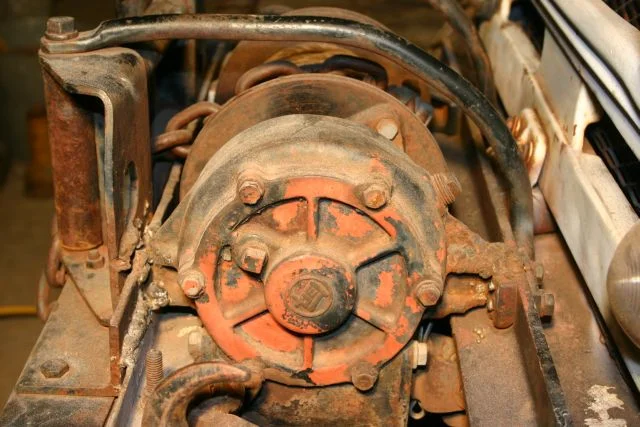

Sounds like a pretty decent repair to me. Kinda reminds me of how a dentist attatches a crown by drilling and inserting a post into whats left of the old tooth. I can picture this.. The missing foot is about maybe 1 1/4 x 2 . I'll send a photo of this hideous mess. Funny, this didn't show up on the pictures the po sent me.:doh:

Been drilling and tapping... I assume you saw my post on the other thread about the value of pto stuff. I figure it's worth a try.. heck, the case is junk anyways. I ground some xtra off, because I now found a really nice pc of 5/8 x 1 1/2 bar stock that will become the tab. I'm just doing the front one first and will set it back in the frame for alignment before I address the rear. .. I still think I should be concentrating on getting that 2f installed, but Ive done that a bunch of times, and this is a genuine challenge, specially for someone who never made a decent weld untill 2 weeks ago.

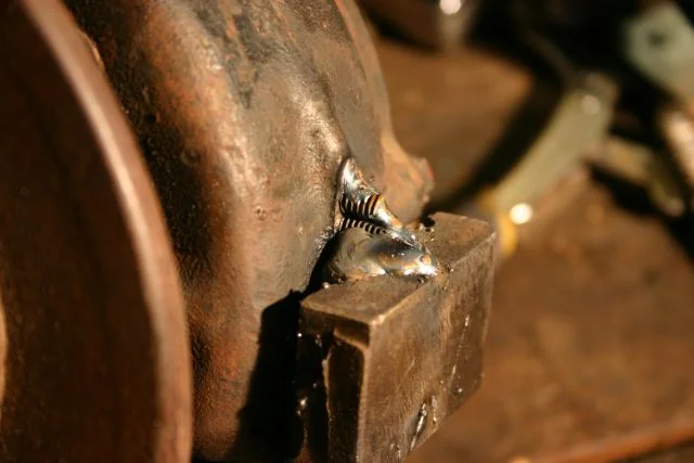

Been welding. Jigged everything up nice and square. The H beam section presents a challenge, but I also got 2) 5/16 bolts in, one above the other at the intersections where it was thickest. The poorly welded rear tab fell off during the process, so I'm now doing both at the same time. Additionally, I'm going to install another 5/16 just above the tabs and weld that to the 5/8 bar stock and then grind it to look like the vertical web. This should spread the load out some more. Good call, Pinhead.
Dang! Out of sheilding gas, and it was just getting fun...that's a 1/4 -20 over a 5/16-18 on the upper web section. I triangulated this last 'external' process by getting two more in below the tab, side by each, and welding them to the 5/8 bar stock. With the bolts I got in behind the tab, and all these extra attachment points, I really dont see these things shearing off. Using a 220 volt wire feed and burning 'em in. And yeah, I know I should have disassembled the thing....

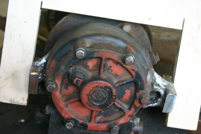

Progress was slowed greatly by Sunday visitors...Here are a couple of photos with the rear tab completed. I need a new tap for the boltholes in the mounting tabs, and then I can mount it in the frame...I feel like it has got pretty good strength, and it looks better than it did before, so I'm glad I tried it.
