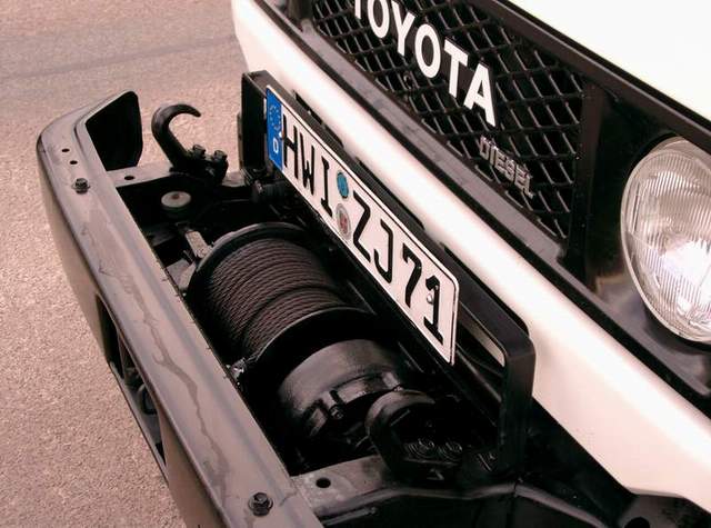

we have had the PTO installed on my wifes DD which was our work horse too...
for working it´s perfekt, doesn´t get hot, doesn´t drain the battery...
and it is defenetly a nice piece of technik to look at...;)
you can only beat that when you have to save weight and need a quick recovery winch.
For that reason we use an electic winch with Dynema cable on our "Travelling Cruiser"....
Soenke,
That winch looks great. What company made that winch and what is the model number? Is that one of the ATS custom winches or is it a Toyota PTO?
Thanks,
John
That is a Toyota OEM PTO mounted on a 70 series...
I thought as much but the fact that it looked so new was what was throwing me.
"I thought as much but the fact that it looked so new was what was throwing me."
John, it looked different when we got it. It had been working on a HZJ 70 in the malaysian forest before...
for getting it in the HZJ71 the radiator has to be lifted a little.
The winch is the same in 40, 60 and 70 just the bumper holder differs and the PTO depending on the gearbox (4 or 5 speed) and the driveshaft of course

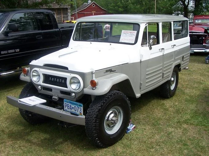

I know what you mean.....this is a 1964 ;)
attachment.php
attachment.php
Matt.....You are the man.
:beer:
That is just a thing of beauty, jeez the amount of work that went into getting it to look like that...:clap:

Soenke,
Thanks for answering an unasked question regarding the winch. I'm hoping that I can find a rusted one in either a junk yard or on someones old rusted out farm truck in a field around here in Central America I was beginning to wonder if there were differences in the winches that came on different series cruisers. There aren't. The winch is the same. What differed is the mounting hardware, drive shaft and front or rear output. Those bits are all doable either off the same truck or scrounged up from Curt or Mud classified, etc. Thanks,
