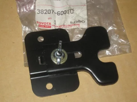

did the 55's have a hinged flap piece that held the PTO lever?
I stripped a PTO winch out of a 77 FJ55 in a junk yard years ago. It had the hinged lock. But I not sure it was a factory installed winch. May have been added from a FJ40. It didn't have the FJ55 billow block bearing. I have 67 date FJ55 microfiche. If it had one it would show in there. It would be next week before I could check.
Here are a few pictures of a FJ55 with the PTO winch. This was from a thread started by D'Animal
https://forum.ih8mud.com/fj55-classifieds-corner/252932-1971-fj55-w-pto-winch.html
If it was born with a factory pto, it should have the hinged plate
good to know, but is it the same as a 40 series? or much like most other items on our swine, are the flaps slightly different?
I have a few of these flaps from FJ40s and they looked the style. I will look at some of my microfiche from the 40 and 55 and compare the part numbers but my guess they are same. The FJ25 had a different flap but the PTO shifter was totally different too.
I'll be needing one of those when the LV is finally done.
I'm a little confused because I've seen the flap style of pto lock that's pictured above. I have found another style that is long discontinued from toyota in new old stock form and was curios if anyone has seen this style before?

Buenos días,
para una consulta por favor.
No he podido encontrar esta pieza para mi modelo FJ43 de 1982, la única opción que tengo es fabricarla, es posible ayudarme con las mediciones por medio de una imagen.
Muchas gracias por su ayuda
Buenos días,

Good Morning,
for a consultation please.
I have not been able to find this piece for my 1982 model FJ43, the only option I have is to manufacture it, it is possible to help me with the measurements by means of an image.
Thank you very much for your help
