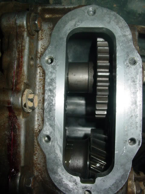

ye. seen the gear spinnlng on the shaft? gear on the pto and the gear in the box.. are 2 or 3 mil apart /;? box ln nuterul and the gear is spinning ..any help is great. thanks
The Prado never came out with the PTO gear fitted.... Are you sure you are seeing the PTO gear !!
This is what you should see..
The PTO is the top gear..
thanks for your reply. well your right bottom gear is the one i was told by a toyota expert???? can a gear be fitted on to shaft. got a pto unit from australia cost me a load of cash to get it shipped to ireland. well thanks again hope you can advise me? ????
Yep just have to find yourself a pto drive gear and short spacer or a gear and turn down the long spacer that's already on the shaft, you can do it all in place its all pretty straight forward you have to pull the rear housing off the transfer case to put the gear in, we did one of mine while the gearbox/transfer case was out and stood it on end to do it that made it a lot easier but you can still do them in place ok :)

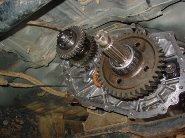

Yup as above. That is what I did...
You pull the transfercase apart until you get to this point...
And as you can see in the upper L/H of the photo.. The pto gear is installed...
It goes on the main input shaft (output from trans) ....
That other gear you could see in the previous photo runs on a idler shaft...Which has been removed in this photo...
Have fun !

If you look at the photo I posted of the case in bits...
The gear is held in place by the bearing which is held in place by the nut...
You will need a gear / bearing puller to remove the bearing...
Once you get to that stage its prettly simple...
Remove the nut.
Remove the gear.
Remove the spacer.
Put on new short spacer.
Put on PTO gear.
Install bearing.
Install nut and stake it...
Put the box back together....
