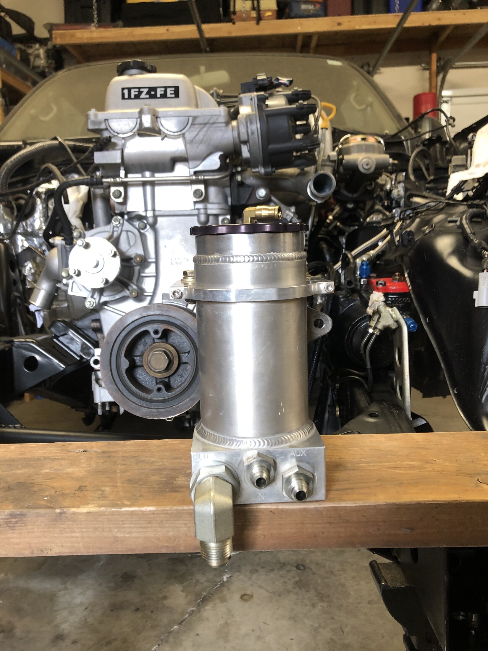

Should go right where the OEM one is, not PCS but here's mine. Has a filter on the bottom that you can't see in the picture.
Looks like you fabbed up a new bracket, is it supported from below? What brand is this? Does this unit have a dedicated port for hydro boost? I am not necessarily sold on the PSC, but it does have an integral replaceable filter that purportedly eliminates cavitation and comes with a port for hydro boost. Can also be had with an external filter.

Yes I fabricated the mount. It’s an off brand and I can’t remember the name right now. It does take the small oil filter that fits the 1FZ.
It doesn’t have an extra port for the hydro boost.
That’s why I tagged @baldilocks has does and he running Hydro boost brakes.

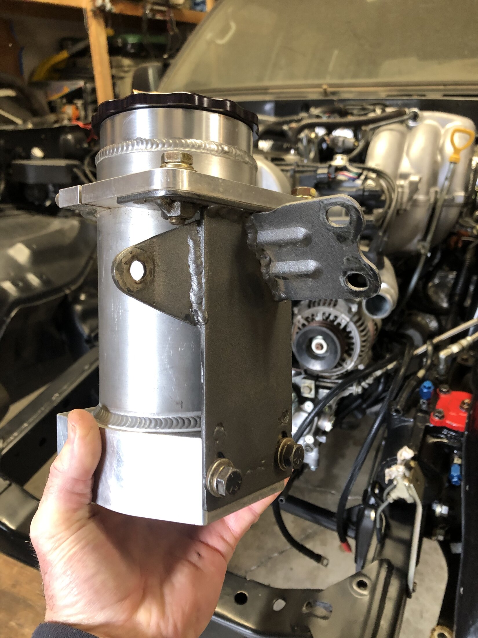

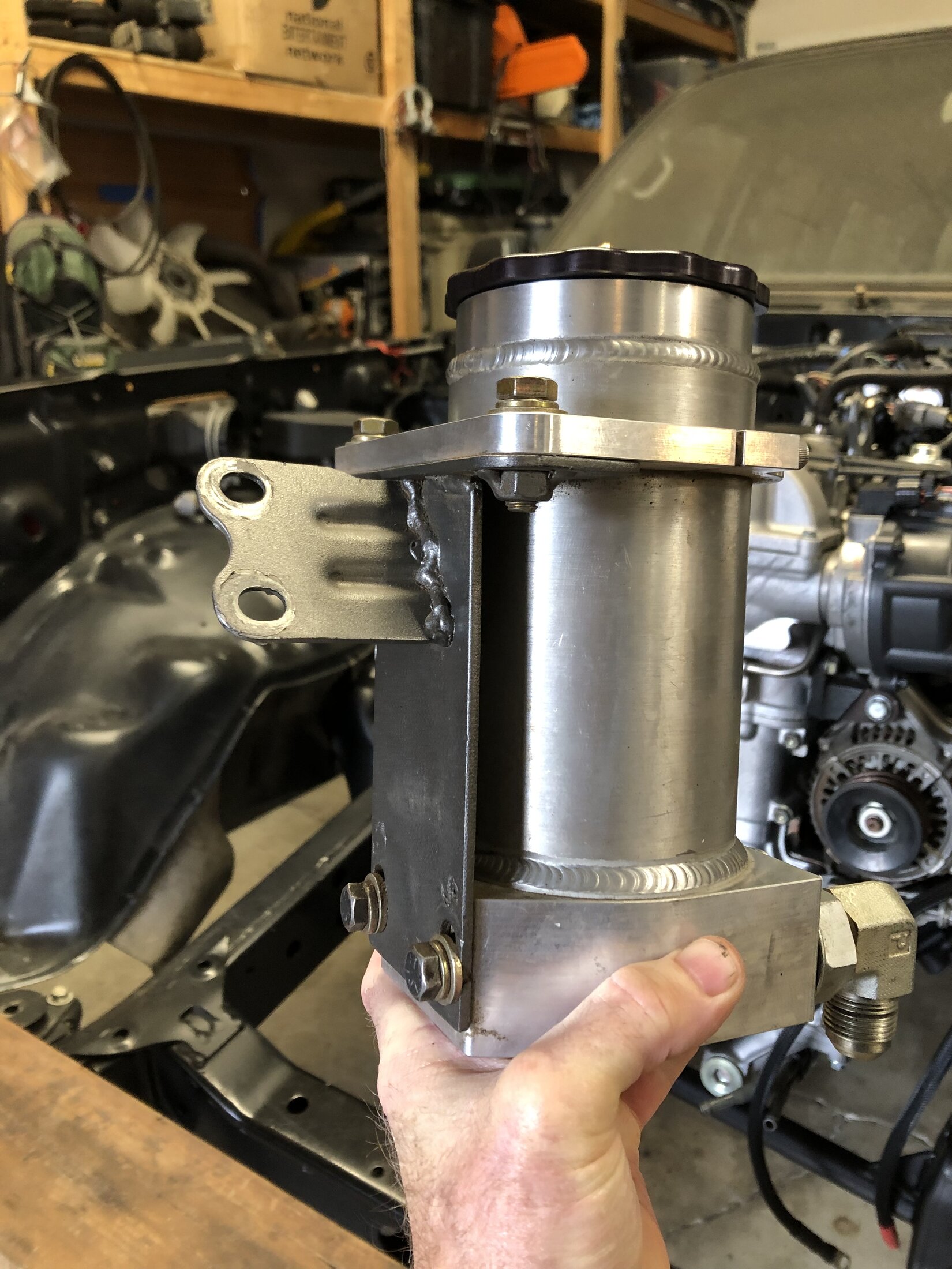

Hello, my reservoir is from PSC and has two return ports. I blended an obvious portion of the Toyota PS reservoir to the bracket I made. Works out well.

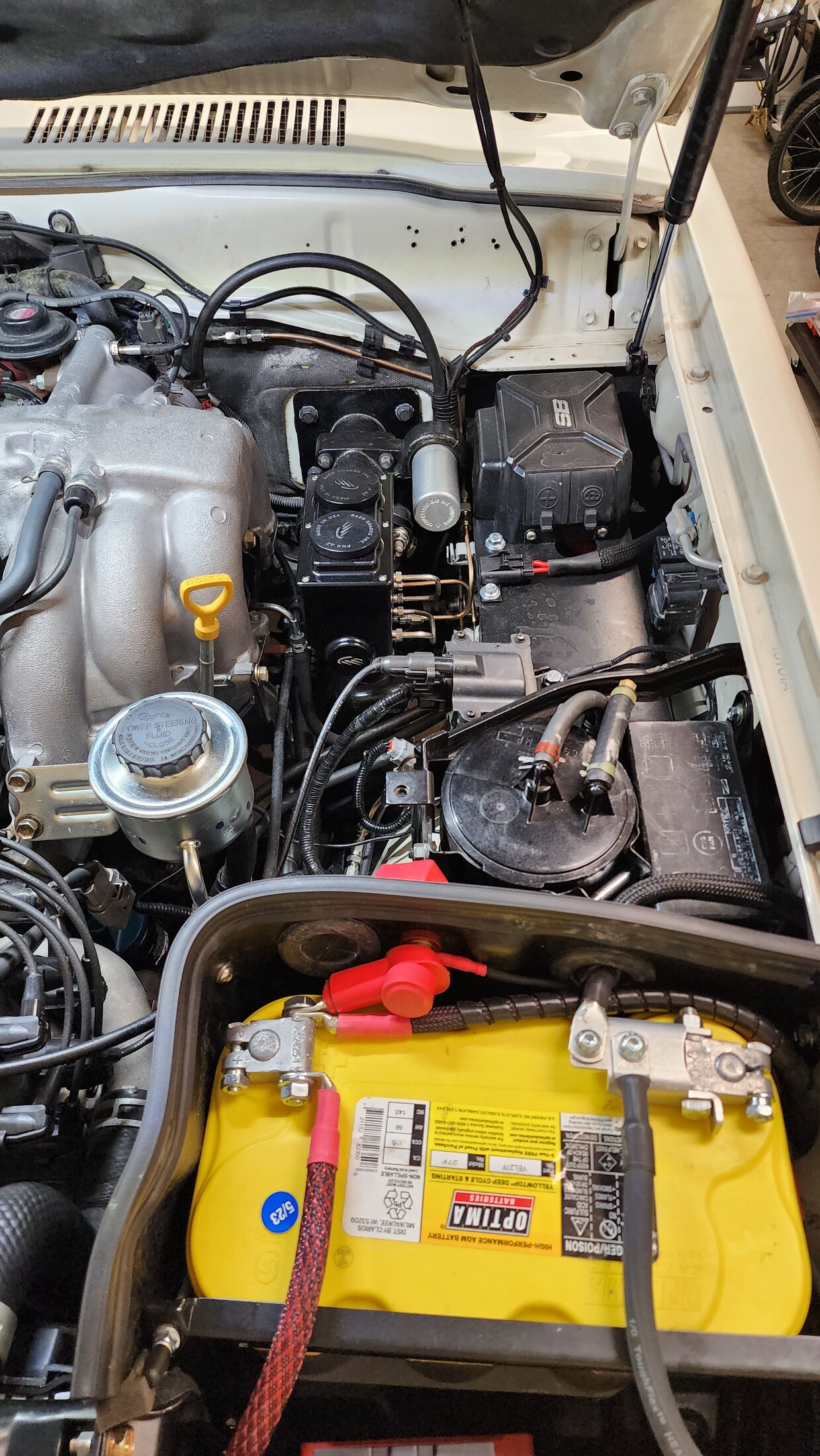

Hey what brake MC is that? Got a part number or link? Bore diameter?
It is a Baer, 1-1/8". I don't have enough time driving to judge if this is too large a bore for my taste. I also need to make sure all the air is out of the system as it still feels a tad spongy.
The one item I have is pedal travel on the system, the push rod on the hydro boost was not long enough and I have it maxed out where it connects to the brake pedal. May try to cut the rod and use a rod coupler to lengthen. As it sits now, the pedal is a bit proud of the gas pedal, would like to see them parallel.

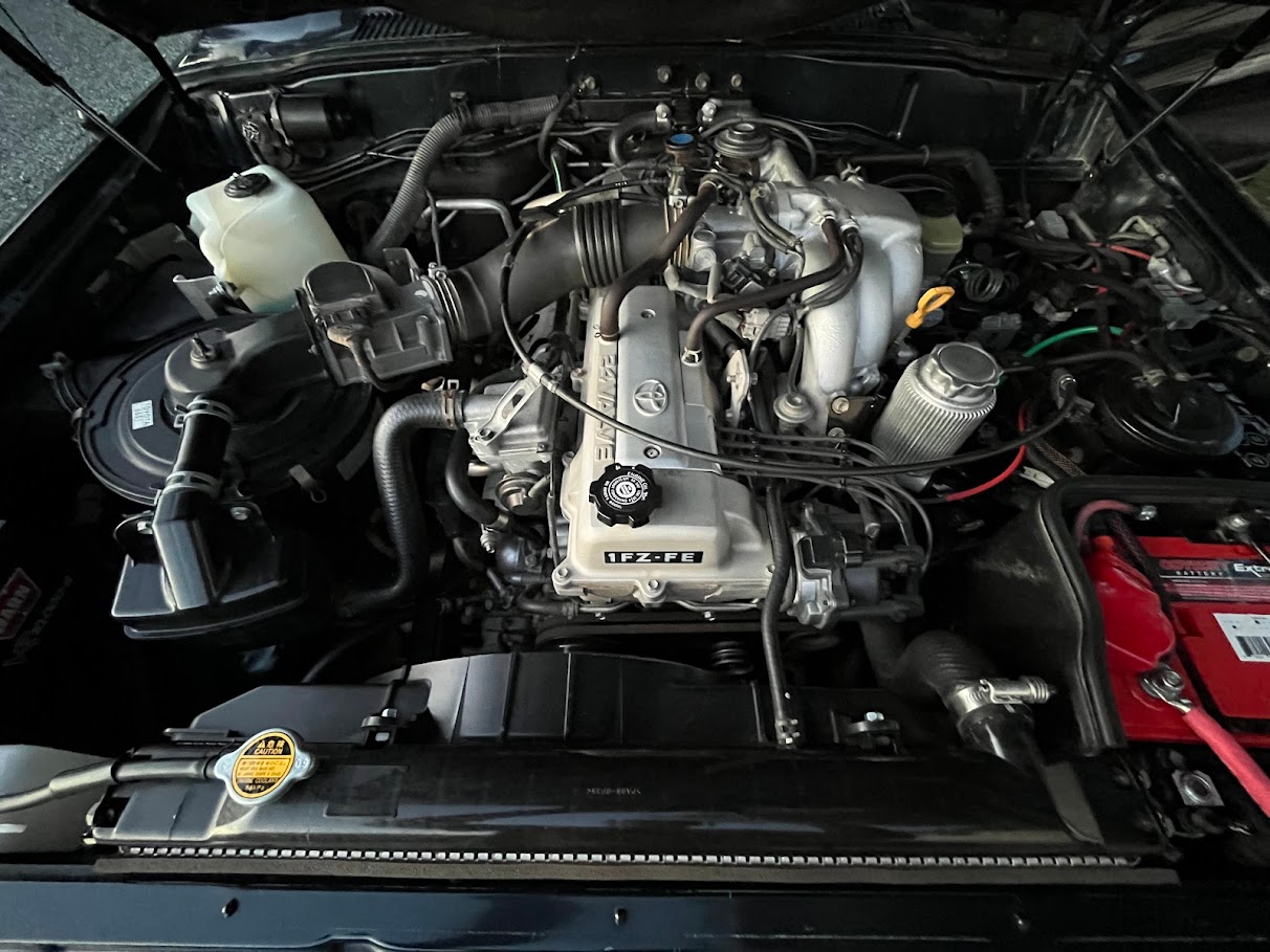

It looks like a clean set up. As I’m doing a new 96 build and will be using the hydro booster from the 93 I decided to try a 1” bore MC this time. The 1.125” worked ok but did require a bit more leg input than the stock set up but at least the car stopped without my foot against the fire wall. If I decide to go back to a 1.125” MC I’ll give the Baer unit a good look.
