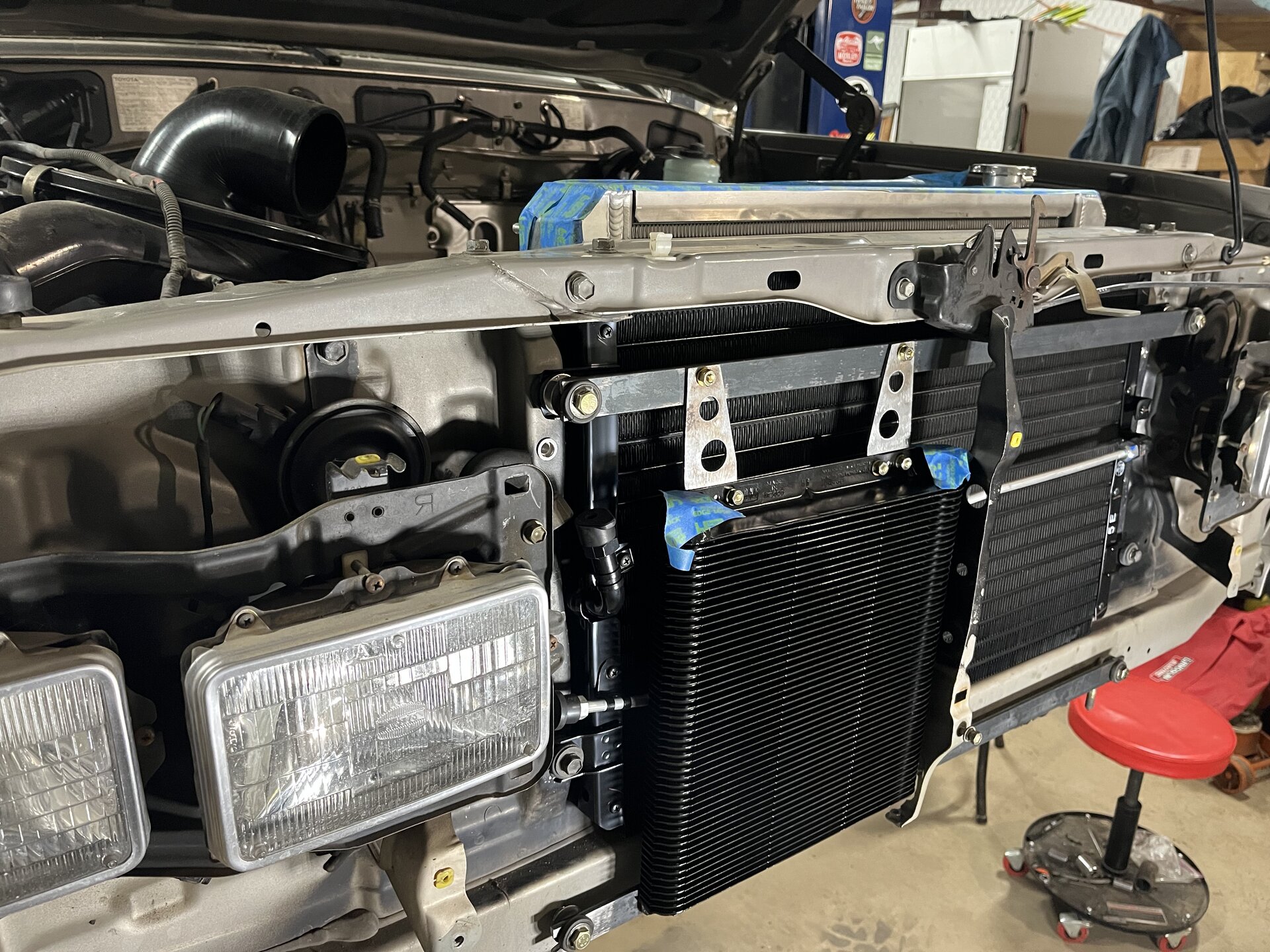

Okay here’s pics my setup. I didn’t go with the heat sink design since I couldnt find any cooling info and went with a traditional air flow through design. I just ordered this today
Here is my mounting approach. I plan on making a simple bracket to bolt up off the bottom bar I installed behind the valance using 3/16” bar stock with rubber isolators on each end using stainless rivnuts and spacers into bottom crossmember. You can see plenty of room to the right of my tranny cooler
I'm curious how much of a difference that Derale cooler will make. Obviously more than the factory cooling loop, but I'm curious to compare what certain coolers would do compared to an "in radiator" transmission cooler like the stock FJ62 radiator when it comes to the PS system.
