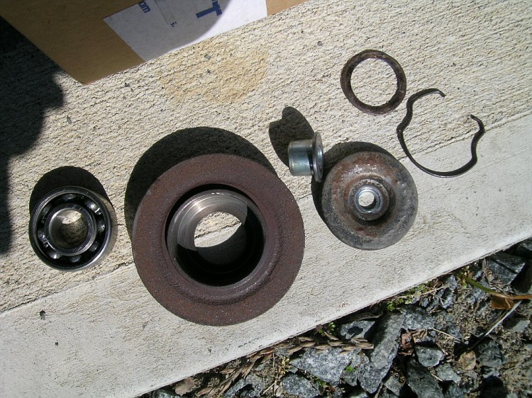

Getting the 92 Minitruck together and road worthy . Got new belts, hoses, ect. Noticed the power steering belt adjustment pulley has a shot bearing and don't wan't to even chance it seizing as i'm tooling down the hiway.
Tried a NAPA and a Parts Plus that are local but they were no help. The numbers are gone off bearing.
Anyone got a good bearing number or is this a job for Cruiser Dan?
Thanks,Joe
I assume you're talking about the 22RE engine. Unfortunately, Toyota doesn't sell just the bearing, you have to buy the entire pulley, very $$$.
NAPA should be able to match it, I have done it before and I kept the box for reference, but I'm not home now so I can't look up the number for you. According to a thread and the FAQ on Pirate, the part number is NSK6204V, which sounds about right to me.
Here's another option: 4x4Wire.com's TrailTalk Forums: 22re Upper Belt Tensioner Pulley
Awesome KLF! The Toyota part # is 90099-10091 according to that thread.
Is this a sealed bearing do you know?
The one guy was talking about taking it apart a regreasing it every so often. WTF?
