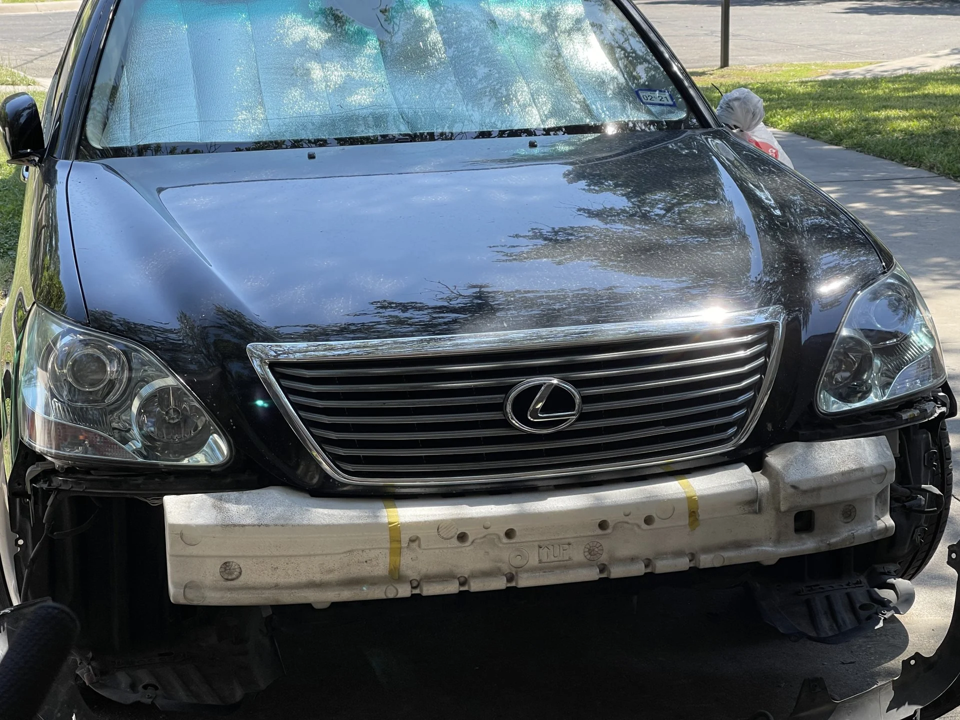

Oddly enough I just did my LS430s yesterday.

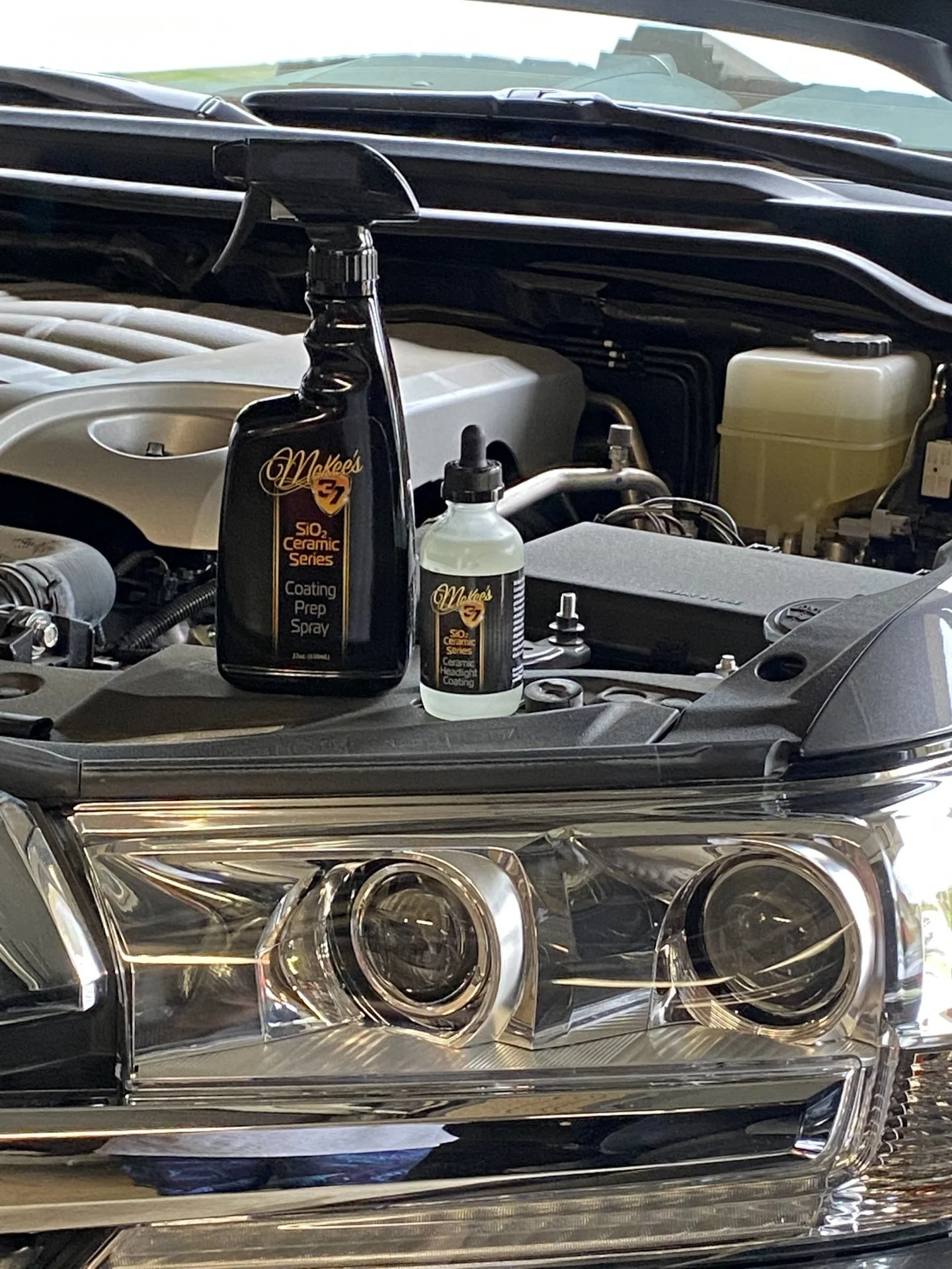

I use McKees 37...seems to work since I sleep better at night knowing it’s there.
