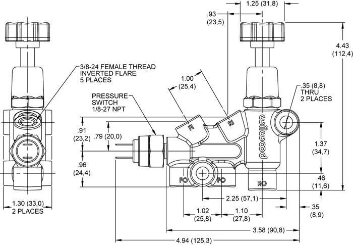

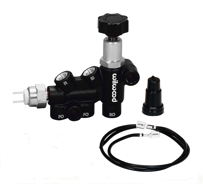

I have this Prop valve installed in Tencha ..
http://www.wilwood.com/MasterCylinders/MasterCylinderProd.aspx?itemno=260-11179
it have 2 front brake ports .. manual said, you can block one front port and use single line and T to feed both front calipers as well as rears ..
But I wonder if it's there advantage to use one port to each caliper on front ?
all comments will be appreciated ..

Not sure what your working on but, most older LC use a single line to the front axle then split it to each side. I would use a single line off the prop valve.
the advantage of the dual port is the ability to flow more fluid. With 6 piston front calipers, if you were to run through one port you would not have enough fluid flowing through the line to get good brake pressure.
So the question is back to you, what are you using for front calipers? Wilwood, in one of their library pages, has a brake-line-size calculator that takes into account the piston area and then tells you what size line to use...
I'm using SW13 calippers ( 4R V6 ) so not a big upgrade .. even tho I just hang up with the guys at wilwood and they said, to me should be the same one line or 2 .. so I will probably stick with one port ..
I would like to have a custom line from - 3AN to M10 x 1 and go steelbraided from prop valve to the calipers ..

If It's already installed, then keep it there and go wheeling. there is no reason to use the second port on your 60.
after some though I'm gonna keep it one port and the other blocked.

You sure those are not inverted flares??? The nuts on the pic suggest they are.
Your master is Aluminum. It'll be fine to use an Aluminum plug.
I don't remember the stock length, but JT has these stainless braided ones for $23 http://www.jtoutfitters.com/extende...oyota-land-cruiser-fj40-fj55-lift-p-4194.html
Also, IIRC some cressida or corrola brake lines were longer and a direct replacement. I'm sure there is a link in the 40 series section FAQ.
-3 inverted flare. That link is for non inverted flare
