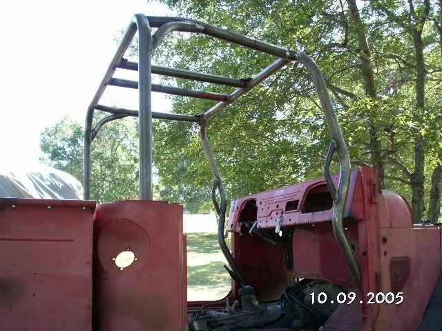

Gary, you using a newer windshield frame or the old one with the vent and seperate wiper motors in it? If using the old school one will that cage come close or clear? That's a really cool cage for a 45.. I've been just mulling over options to put a cage inside mine and someplace to mount seatbelts as well.. Gotta have new seatbelts..
Here are some better pics of the fender mods and cage. It looks a little silly with the 265s on it but 40s are on the way.
