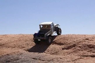

My favorite shot, from Hell's Revenge on Monday:
