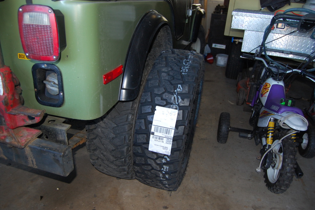

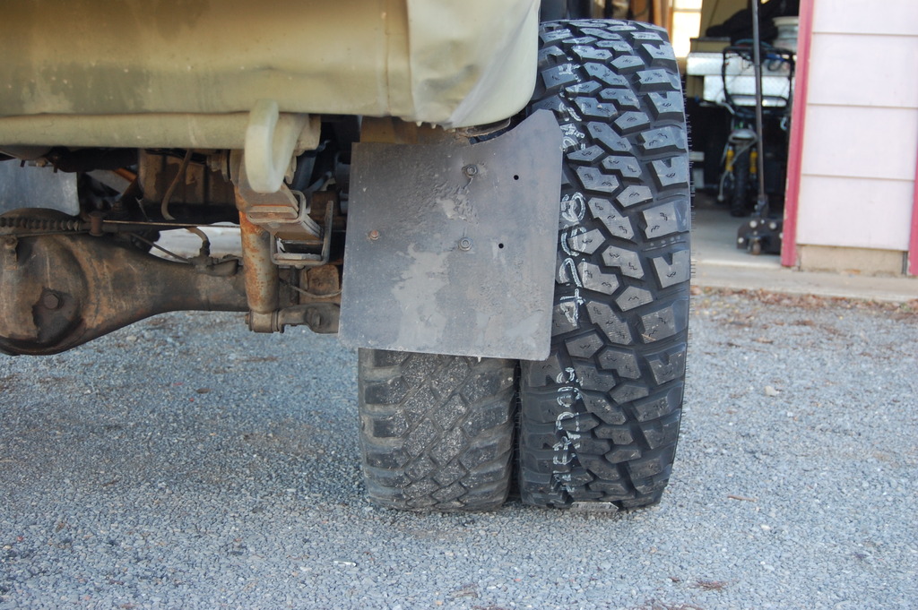

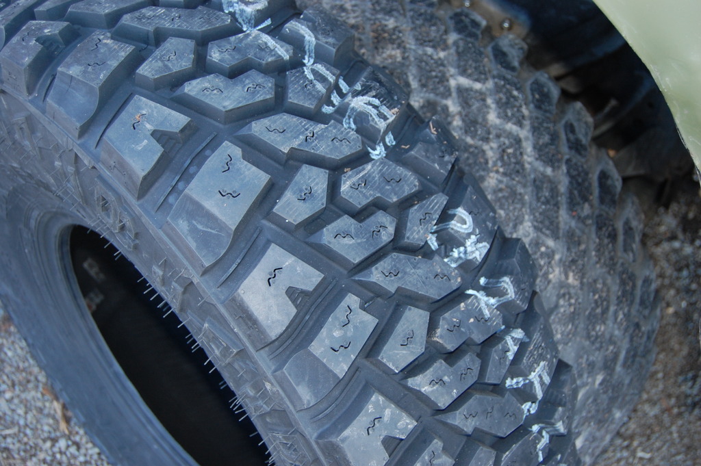

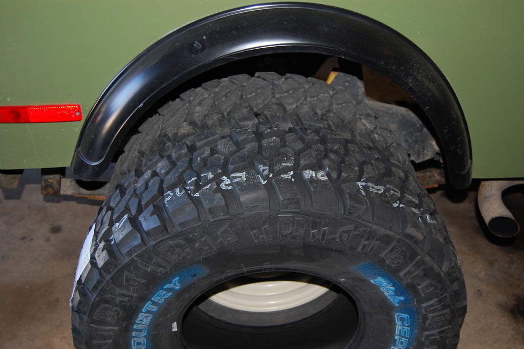

My tires came via UPS today.....They were the last thing on the guys truck at 5pm and he seemed kinda grumpy. First impression is they look tall and skinny... I dont like measurements the website gives you, so here is what I got with a tape measure in my hand. 32.0" tall, 9.0" wide. This should help prevent rubbing... I hope. The tread looks nice an open. I really like the square shoulder look and the beefy DC logo sidewall tread. They dont feel as heavy as I though. The shipping label says 56lbs but they dont feel that heavy. I will try to weigh them before I mount them.
I love getting new tires!
Here they are next to my bald 31's. They actually measure 29x10 on a good day.

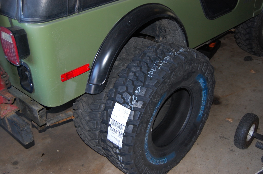

Hopefully they fit without rubbing. before the 31's, I had 32.11.50 and they didnt rub at all so I think with the 3" lift I did they shouldn't rub.
Here they are next to the 32's on my jeep....Just for comparison.

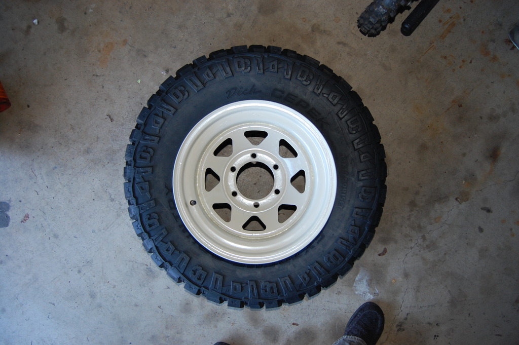

Here are the rims I will be putting them on. 15x8 3.75 bs. The tires look tiny because the rim is just sitting on them.
Looks like I have enough room.....? "I'm Ron Burgundy?"
Ready to go! I'm hoping the wife lets me sneak out in the morning. My friend has an old firestone tire machine he lets me use. I will mount them and post some pictures ASAP. I also will try to allign everthing when the truck is up in the air tomorrow. Thanks for looking!

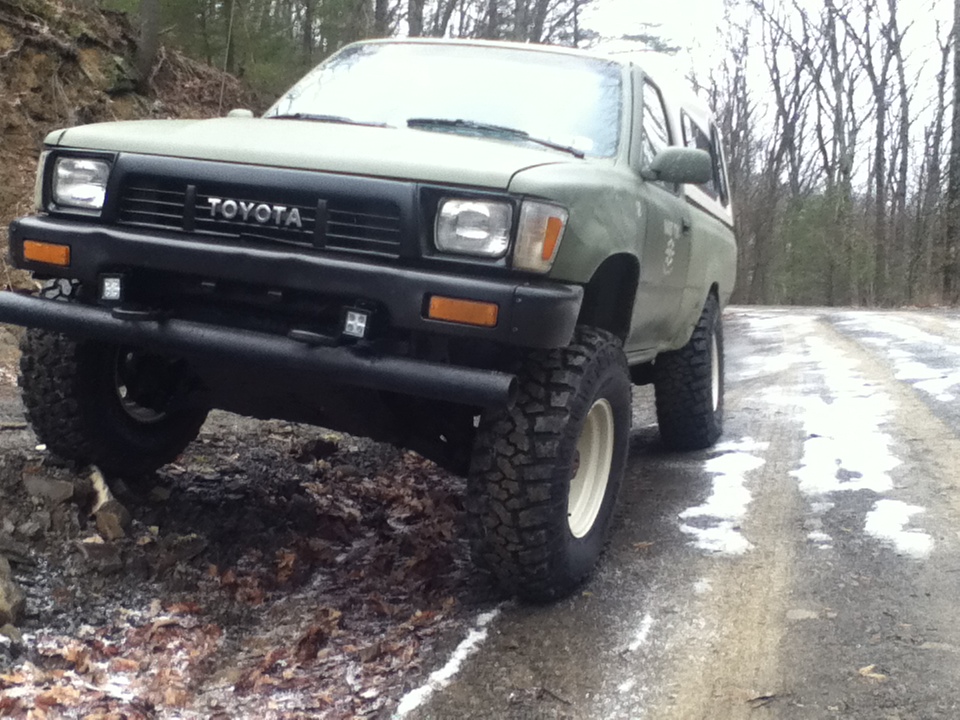

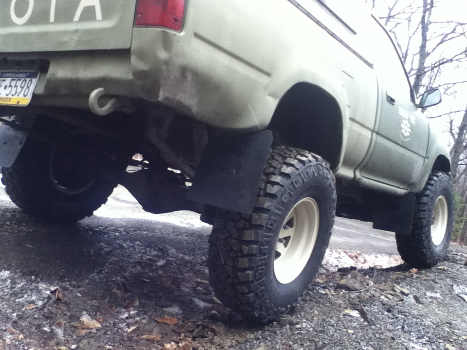

HerI finished the alignment... What a nightmare! The lower control arm bushing were completely rusted to the cam bolts. I have been beating torching and using every means possible to break them free. I ended up cutting them out and pressing in new bushing...and making new cam bolts. Im so glad that is over. I also painted the grill and fog lights flat black. I took the truck up on the mt. The road was packed down and icy from snowmobiles but there was no snow on them. The tires did well. It was starting to melt so they really chewed down in some spots. Nothing too extreme, but so far so good! I was also thrilled with how smooth they were on the road. I mounted them myself in my friends garage and did not balance them. No shimmy or shake and very quiet! I will give some updates and hopefully some videos once I get to run them in some more serious 4x4 terrain. 5-stars so far!
Here are a few more pics.....
I took the dick cepek tires on a decent outing today. I went through some snow....mud, ice, hill climbs, I drove up a washed out road that was basically a rocky rutted creek bed with about 8" of water flowing down it. I also had to drag a large downed tree out of the way so my friends f150 would fit through the trail. The tires performed flawlessly. I only have about 100 miles on them but so far I am very pleased. My buddy has a video on his phone. I will post it if I can get it from him.

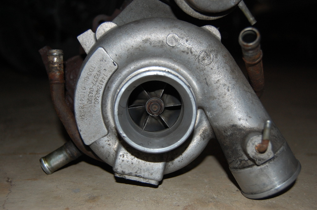

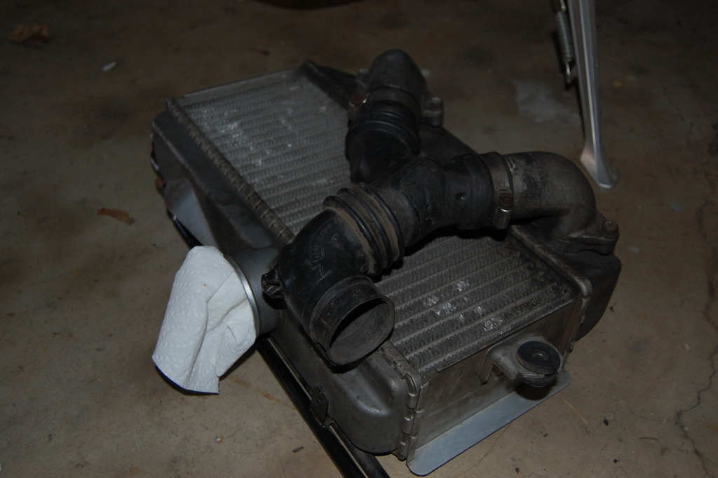

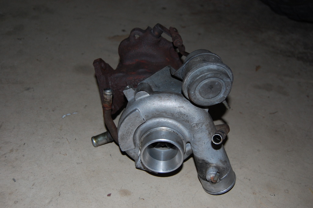

Thank you! Now my next phase is gears... I would like to get 4.88's but I also picked up these trinkets the other day td04 and intercooler off of a wrx...... Not sure if I should go for it or not. I turbo'ed my old sas tacoma years ago with good results but have never tried a carbed turbo engine. Thoughts?
IMO don't do it to a 22r/e I looked into doing it and the amount of work you need to do engine and computer wise isn't worth it. For the same amount of money you'd spend you could easily do a 3rz swap.
I have turbo'd a few non turbo engines in the past and have never had a head gasket issue. I have always kept the boost low and im a pretty conservative driver... or maybe I am just lucky.
My suggestion is to Google search turboing a 22r or re. youll find a lot of people end up having tons of issues with compression and the computers not being able to handle it. Some go for a turbo computer and the engine will need to be torn down and rebuilt with the turbo 22re parts if you want any boost over 5 psi if I remember correctly.
I am not totally sure on which direction I will go either. I have also thought about just putting some turbo pistons in it and doing a draw through propane setup....That would be pricey but cool. I will continue my research and let you know what I end up doing!
