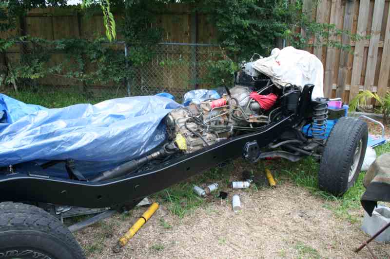

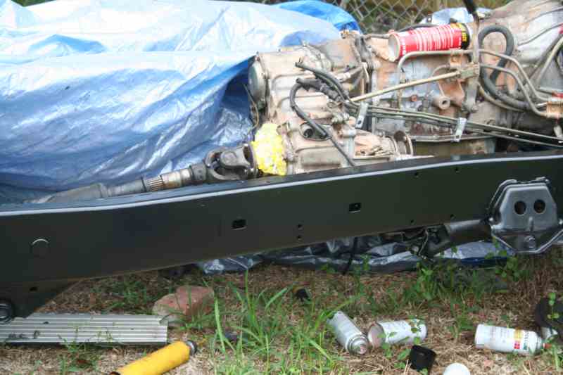

Alright got some pics for you guys...As you can see I got all the body mounts cut off and its almost ready to roll under the body. As for the vac assembly, I have to cut it in half reweld it and add a dust boot. I will post a pic when I do it. I think if I was running a toy box I could get away with out it because it would push the t-case back further where it would clear better.

ahhh it worked...here are some pictures.

did you spray the frame or roll it?

Rolled the whole thing... I was just huffing those spray cans under the tarp:D
All kidding aside.. I rolled it on with a 2 inch sponge roller after sanding the whole frame with 200grit. The spray cans where mostly clear coat cans for other crap I was spraying.
