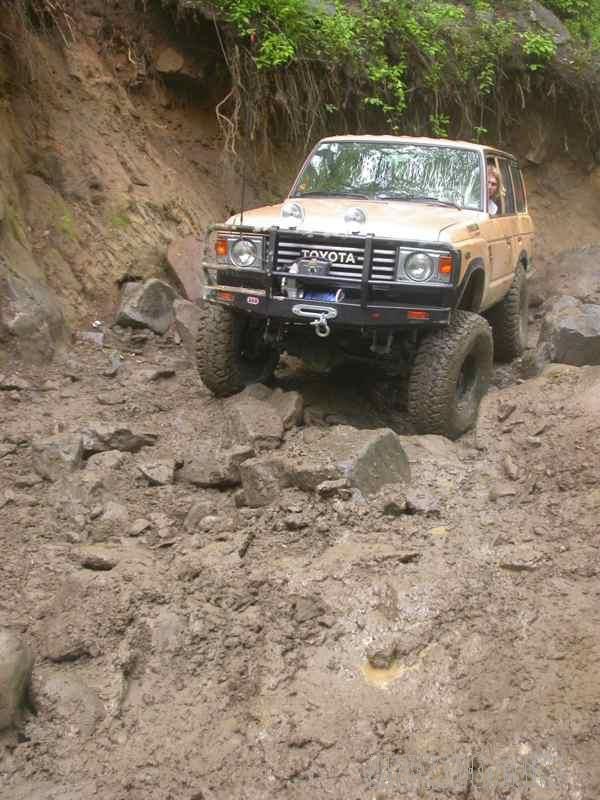

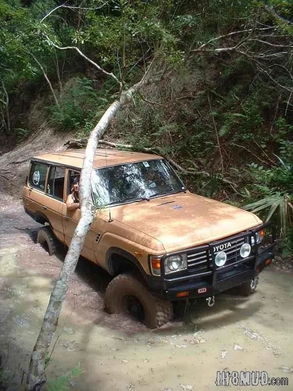

how come we never see a whole pic of your truck? i've searched and searched, and cant seem to find one. I'd love to see the profile, color. ect.
hammer
Hammer,
Tonight when I get home from work I will throw some pictures in this thread of what Velveeta Wag looks like and all the crap Ive done to it....Not a problem brotha man...
-Al
Put up the link to the thread of when you did ROTW in this section for your rig. Has all the pictures right there.
i love the pic of it in the creek bed.
Velveeeta Wag stats:
4.56
Aussie locked front & back
4 runner calipers
Rear discs
fj80 master
line lock
2lo
37 mtrs on bent 2.5 back spacing U.S. steel wheels
swing out
tranny, t-cas proection
ARB
8274,syn line, in cab controls
hand throttle
SOA on 2.5 inch lifts springs
Anti-inversion shacles f&r (2inch over stock)
1/8 steel cut up high Q'er panels
hellas
par-desmogged rocket ship 2f
Over the hill hi-steer
Thrashed body, broken birfs, broken and bent body parts and the list goes on...
And about a zillion little other things, like: longer soft lines for when ya break birfs you can set the caliper on top the axle,no rock/mud shields,re-built alxes,diffs,kunckles,carb, so and so forth, new toyo parts on all the engine crap like alternator, water pump , fan clutch,vac hoses etc etc...
I have spent more time on this truck then is sane and it will never really be done. there is always somthing to build better or nuttier.
After this project is done I am willing to bet Velveeta Wag turns into a full time rock crawler...as of right now and the last couple of years it have been my DD.
