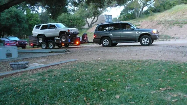

Anyway, this is the only pic of my truck from the trip. Sorry about the quality, it was taken from my buddies iPhone... LOL
i have always said the perfect combo is a mini and a 100. the 80 is a great truck but it just won't go everywhere a mini will and it doesn't come close to the comfort and power of the 100.

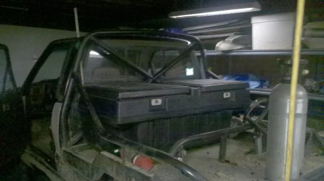

Hey guys! Well not much has happened with the truck. Mostly sitting! I was able to get one of my emergency light heads installed and fine tuned the CB. I also started on the HAM radio install by mounting a through-the-roof NMO antenna mount.
Another project that I started was a bigger box. I had to relocate my Hi-Lift and CO2 tank but this will give me a lot more storeage.
