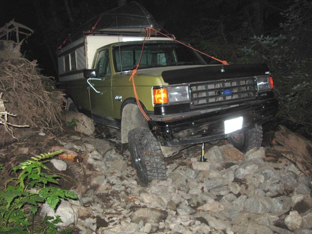

Al's gonna be pretty disappointed if someone doesn't start giving him grief about his Ford...;-P
