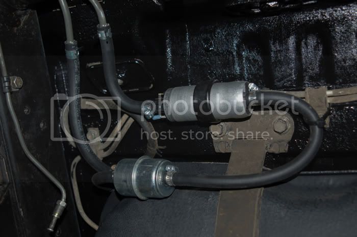

I installed the fuel tank and small push pump. The pump is made by Carter and was on the FJ when I bought it, but summit carries them. It comes with a pre-strainer.
I mounted it just in front of the fuel tank along the right hand frame rail, right where the tank outlet and return hoses are located.
The fuel line I am using is Dayco Gen-2 fuel injection hose which is rated for biodiesel and can be found at Pepboys. Just make sure it's the Gen-2 fuel injection stuff.
