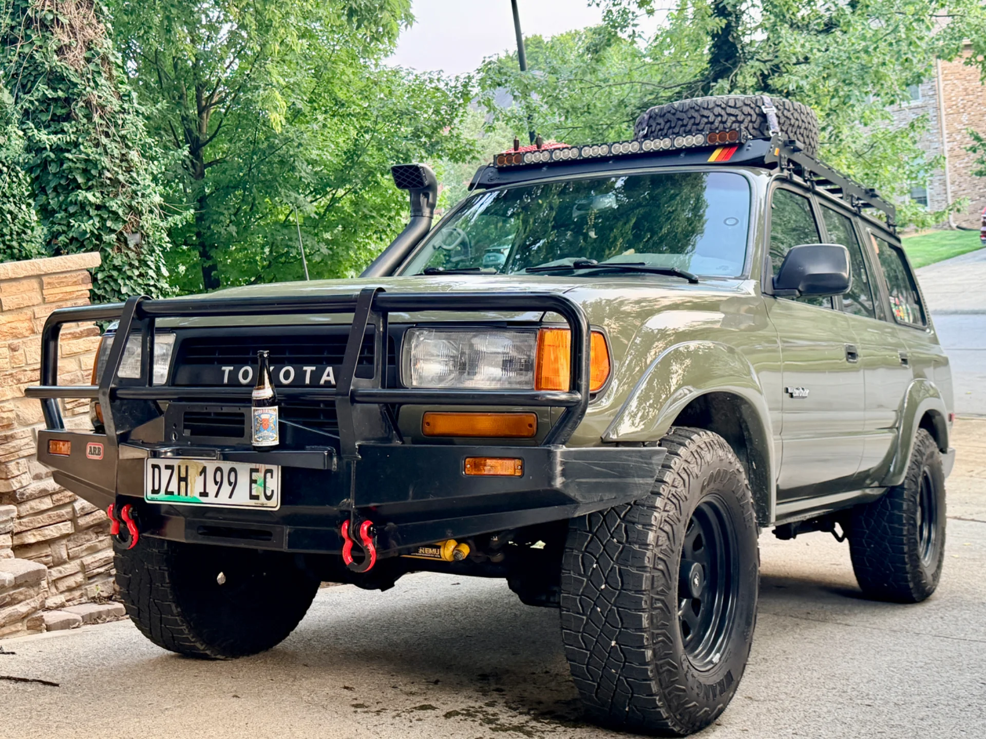

Will follow. I have a similar ‘92 without lift but 33’s as well. Have done a bunch mechanically in past 10 months sorting out and still going. I am not a recreational wheeler but use mine to hunt. 263k on it now. Eventually will need a rebuild or new motor. What ya figure the V8 swap will cost ? Would love the added power but something about having it more toward the original appeals to me as well…

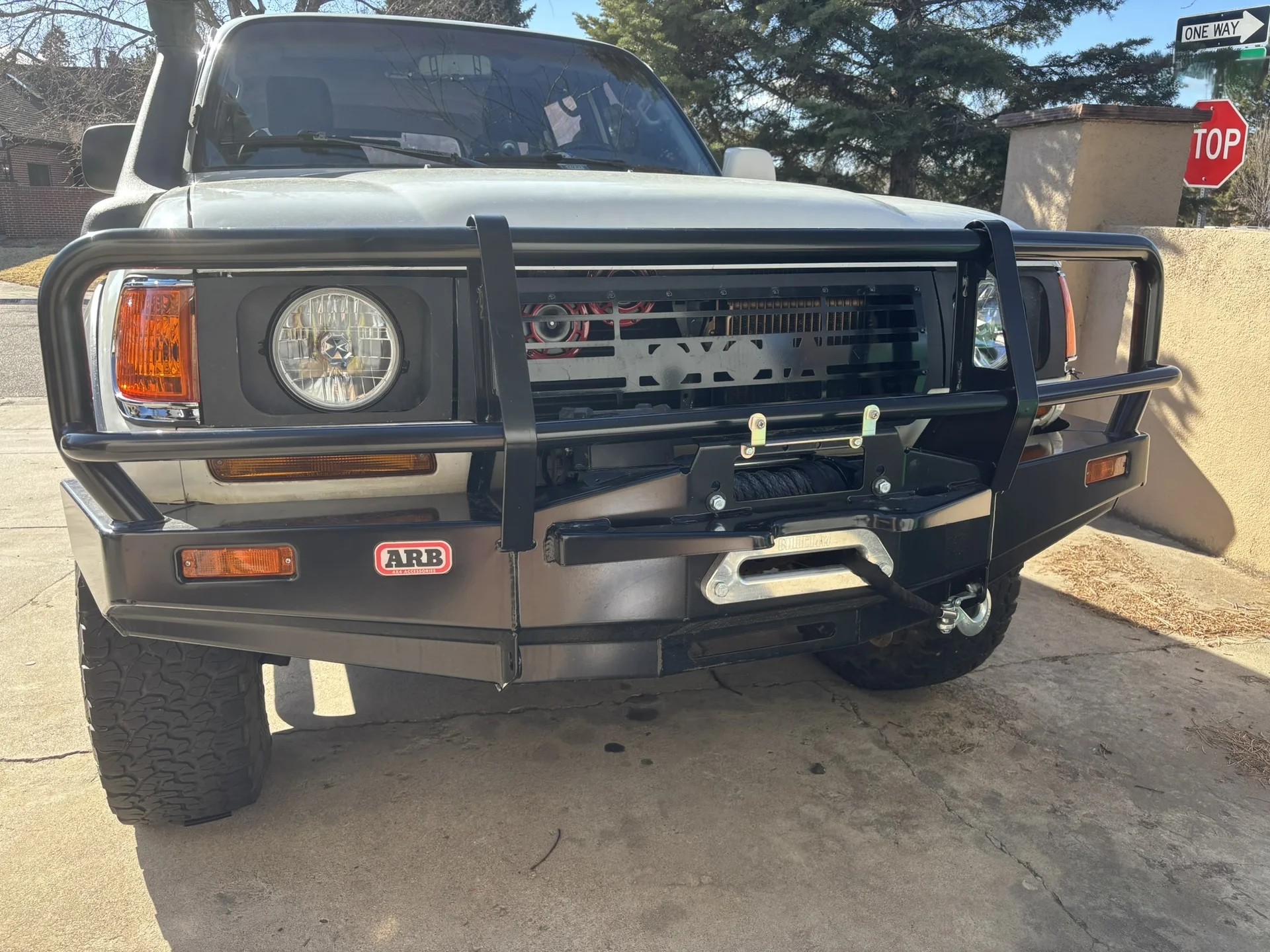

One of the first mods I did was a retro face-lift tat I like a lot but many of you will hate. I was initially looking to buy an FJ60/62 but the one I looked at in my neighborhood had a lot of cancer and the woman wanted too much for it to make sense. Then I ran across this '92 FJ80 virtually rust free and already had a couple of desired mods such as ARB front, winch, and snorkel and was priced very attractively. I do love the retro look of the FJ60 front though so with the help of LandCruiserGrilles I back dated my 80.

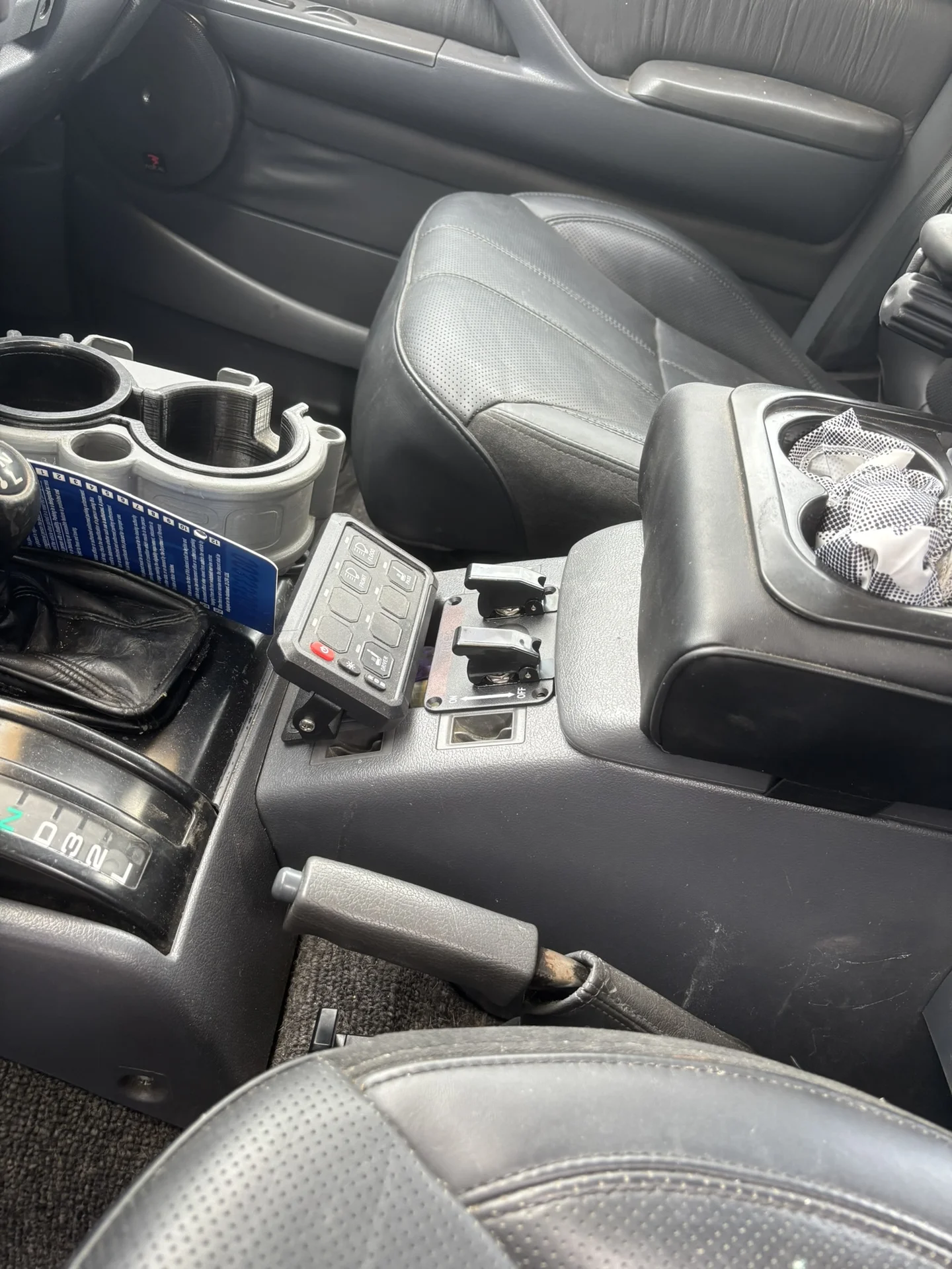

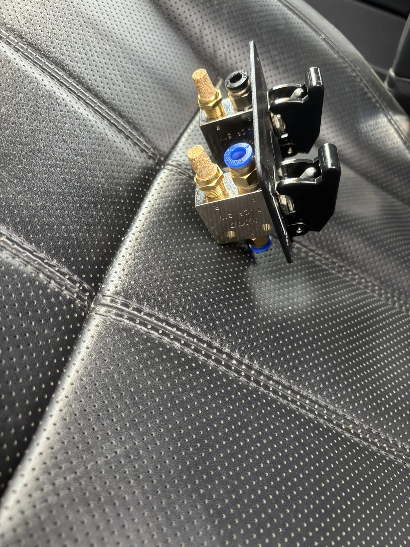

No real updates, recovering from knee replacement surgery. I've ordered a dual diaphragm brake booster and new braided steel lines to try and fix very weak brakes. Also, I'm a big fan of simplification and like to run air actuated lockers using mechanical pneumatic switches. Below is my locker switch solution:
ABS and LSPV still intact?
That could be a culprit to the weak brakes
