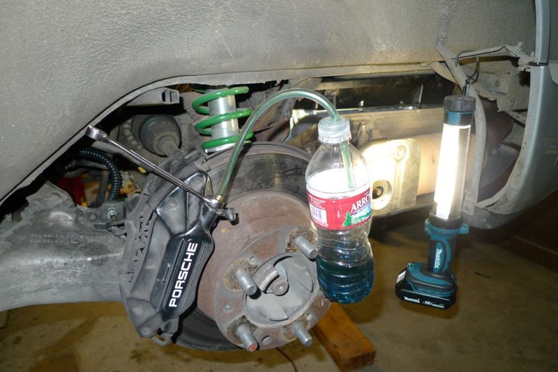

3. I do one man bleed b/c it's all I have. A small piece of tubing goes on the bleeder nipple, then into a Gatorade bottle that I hang under the fender. Next ..... submerge the tube into fluid in the bottle so air cannot be sucked BACK into the system. One wheel at a time you're now ready to simply pump the brakes while leaving the bleeder open. Caution .... this uses a lot of fluid .... be sure not to pump the master dry (i.e. refill often.). Added tip .... after doing Right Rear, then Left rear, do the right rear again in case air split off at the T-junction.

PIC stolen from web:
I'm not adding anything new except for one item .....
1. Johnny got it
2. See #3.
Nice. I already picked up some of the motiv bottles so I might try this later. I'm sure last night with the wife helping all we were doing was pushing air out then pumping it back in.
Lemme reiterate what @NCFJ said .... careful not to go to the floor with the pedal. Can either ruin seals in the MC or tear the aged diaphragm in the booster.
