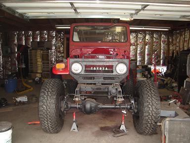

So it's official.......after much debate and going back and forth between my three personalities.....I picked up a set of brand new 40" mt/r's on 32 bolt Allied beadlocks, brand new for about half the price. I wasn't sure if I wanted to go this big but I couldn't pass the deal up. And what are 1 tons for right?
Here's what the tires look like on the rig.......I have a lot of fendertrimming to do....I was thinkin of doing a set of tube flares for the rear and have no idea what I want to do on the front. The front ended up being 81.5" outside to outside with 4" backspacing and the 4.5" dana 60 cutdown. My goal was to be able to make tighter trails like Barrett Lake on the Rubicon. Overall I am happy with the stance but may add 3/4" spacers to the rear axle to get it even with the front.
