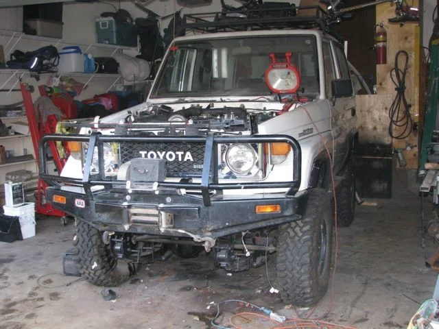

His and Hers
Ahhh, the happy couple together again. Notice the look of envy on my 70 over the E-Lockers on the wife's 80. The 80 was going to be the original project, lift, winch sliders ect. That was before the minister of finance (wife) drove it. Leather, AC all the bells and whistles. That was the end of project "Dr Evil" and the beginning if project "mini me". The 70 looks great but that locked 80 will probably still give it a run for its money even in stock form. I wonder if she would miss that rear locker?
