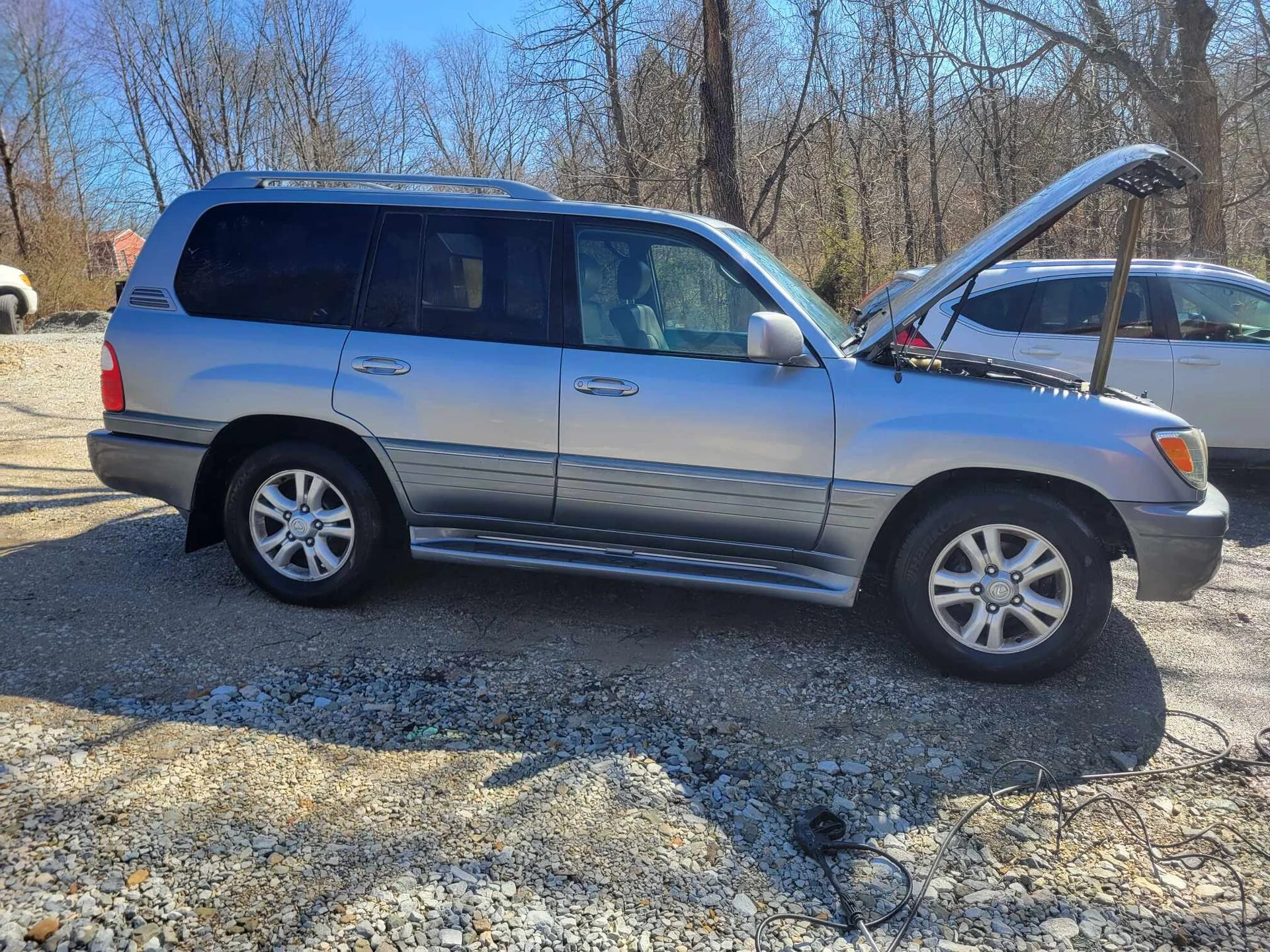

What I settled on was to buy a LX with a blown engine for 'cheap' - that way, I could drop a sub 100K mile 2UZ into it, replace everything that I want to, and still end up around that $15K price range, but with many brand-new OEM parts. I got lucky and found exactly what I was looking for online - a CA/FL LX with a blown engine. I got pictures of the frame and it was SPOTLESS.

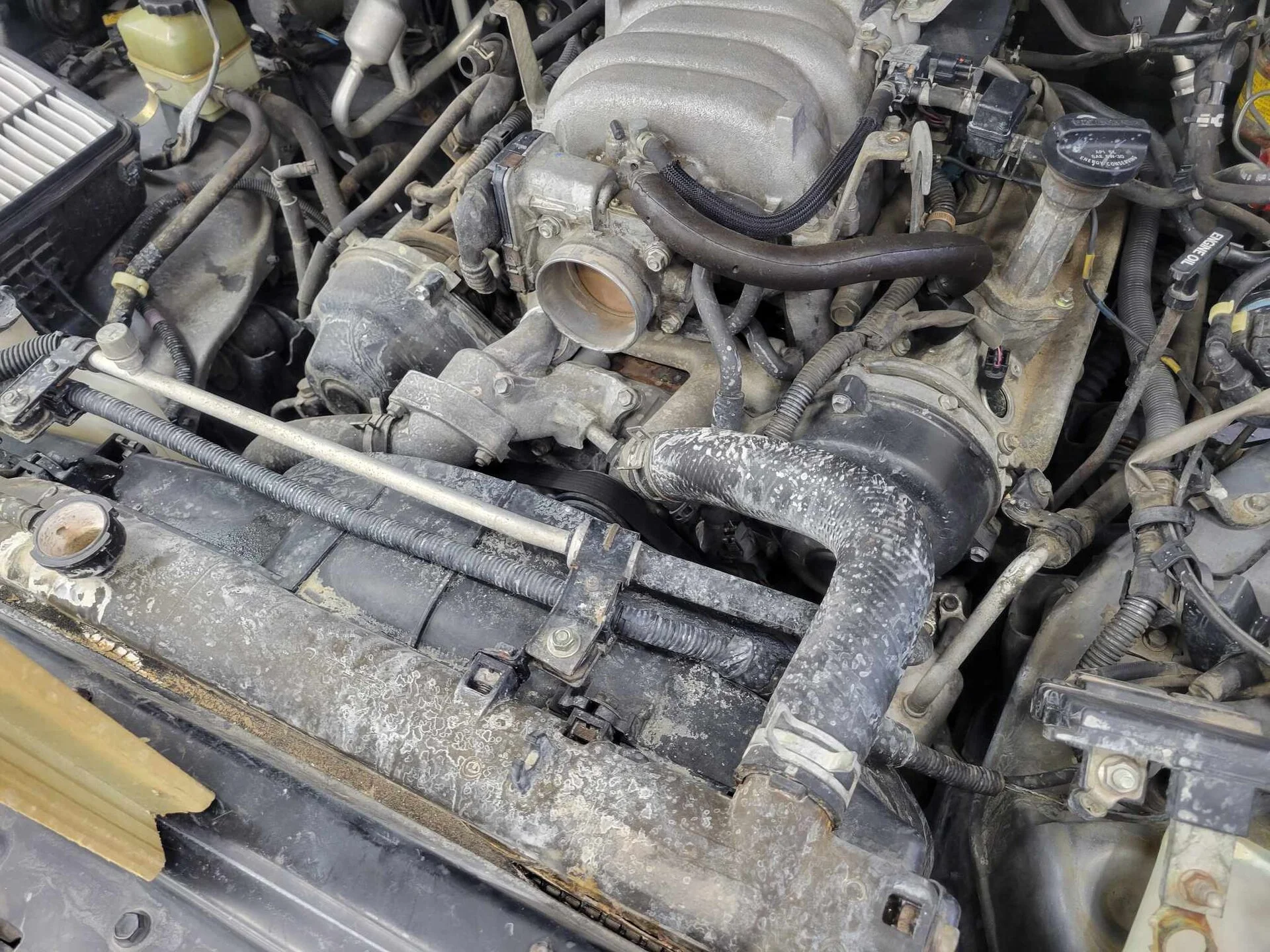

I bid on it, won the bid, and it was delivered a couple weeks ago. As you can see in the picture below, it looks like it dumped coolant from the radiator cap - the pictures below are after I power washed the engine bay even - you can see all the dried coolant. The engine cover (removed) is warped even! When I drained the engine oil I got at least a gallon of coolant out of it too, so this headgasket has probably been vaporized and I assume the heads would look like a banana if I were to take them off. I scoped the cylinders too - lots of rust and scoring. The heater tees are both intact, although one is just a brass tee with hose clamps. I'm not sure I've ever heard of these failing in this manner, so it's definitely a little weird to me.
I thought it was silver in the auction pictures, but it's actually the 'Blue Vapor' color. I dig it! I did replace the hood struts right away, since that's sorta a safety issue while working on the thing…

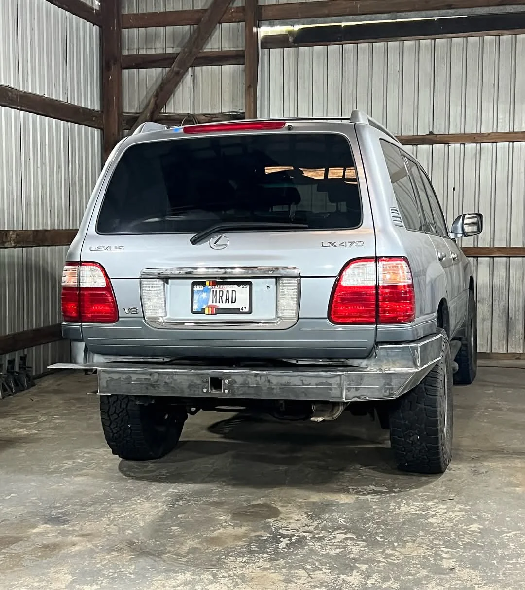

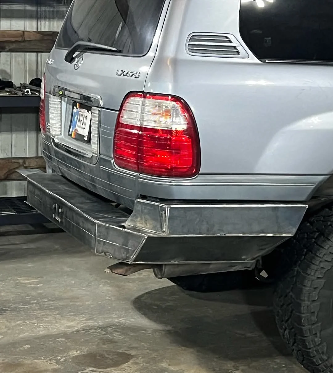

My fab guy was backed up, so this is about a month late getting started - but it's finally happening! Super happy with the work so far. He's taking the things I like most from the Dissent/Coastal/Trail Tailor/SLEE rear bumpers and combining them into 'Alex's one bumper to rule them all". It'll get a tire swingout, and a modular ladder/cargo swingout too.
I was initially looking at a Coastal Offroad kit, but this will actually end up being not that much more... And it'll be done, haha.
I have no issues paying for quality, but I love getting a good deal and this guy gave me a lot of confidence in his work. He's done some LX bumpers before in the past, but they were bulkier than I wanted. He's done a great job of slimming this down to fit just about as tight as it'll go I think. I like that the quarter panels poke out just a little bit for protection - they'll get some hoops too before it's all said and done.
